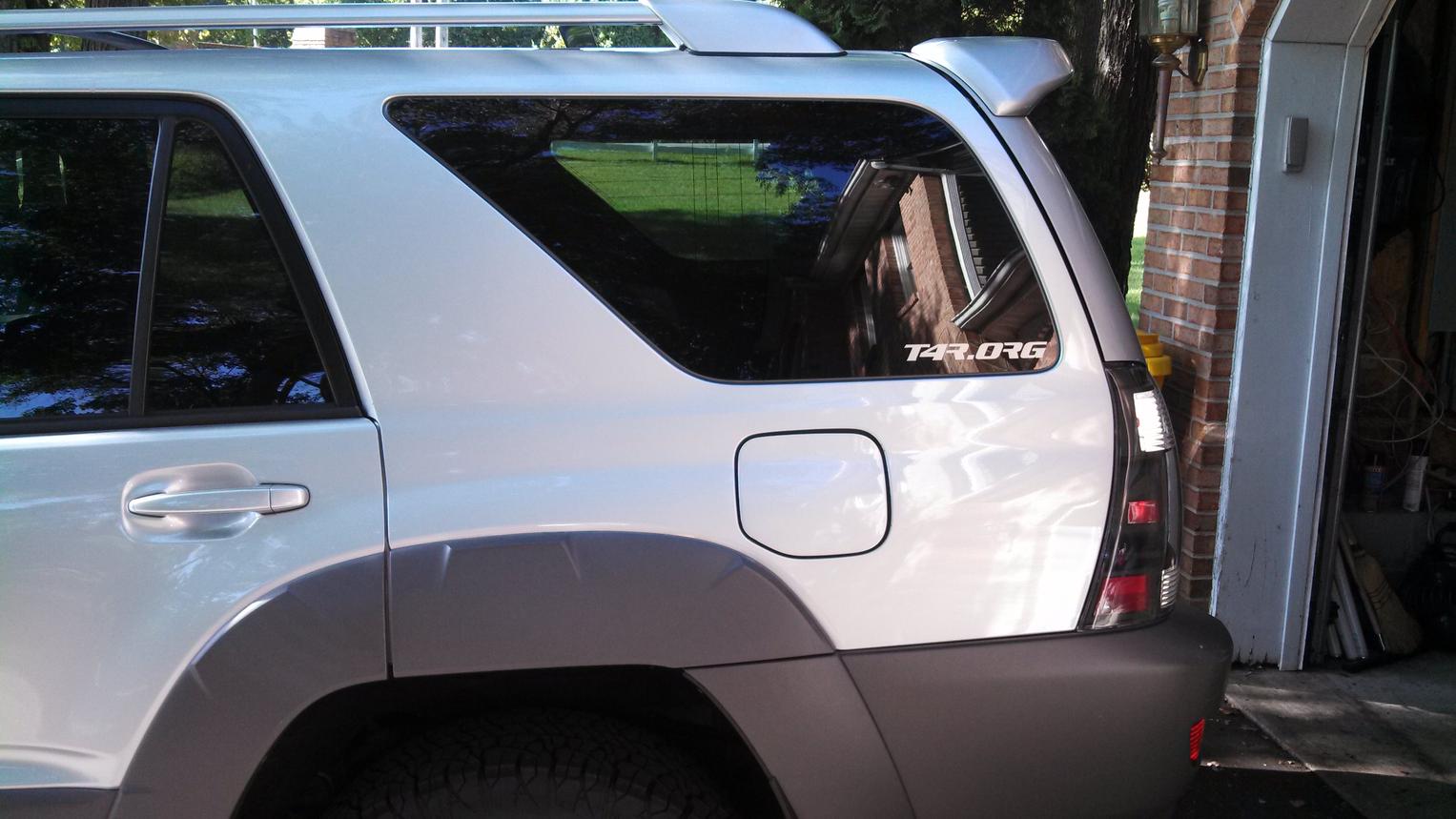

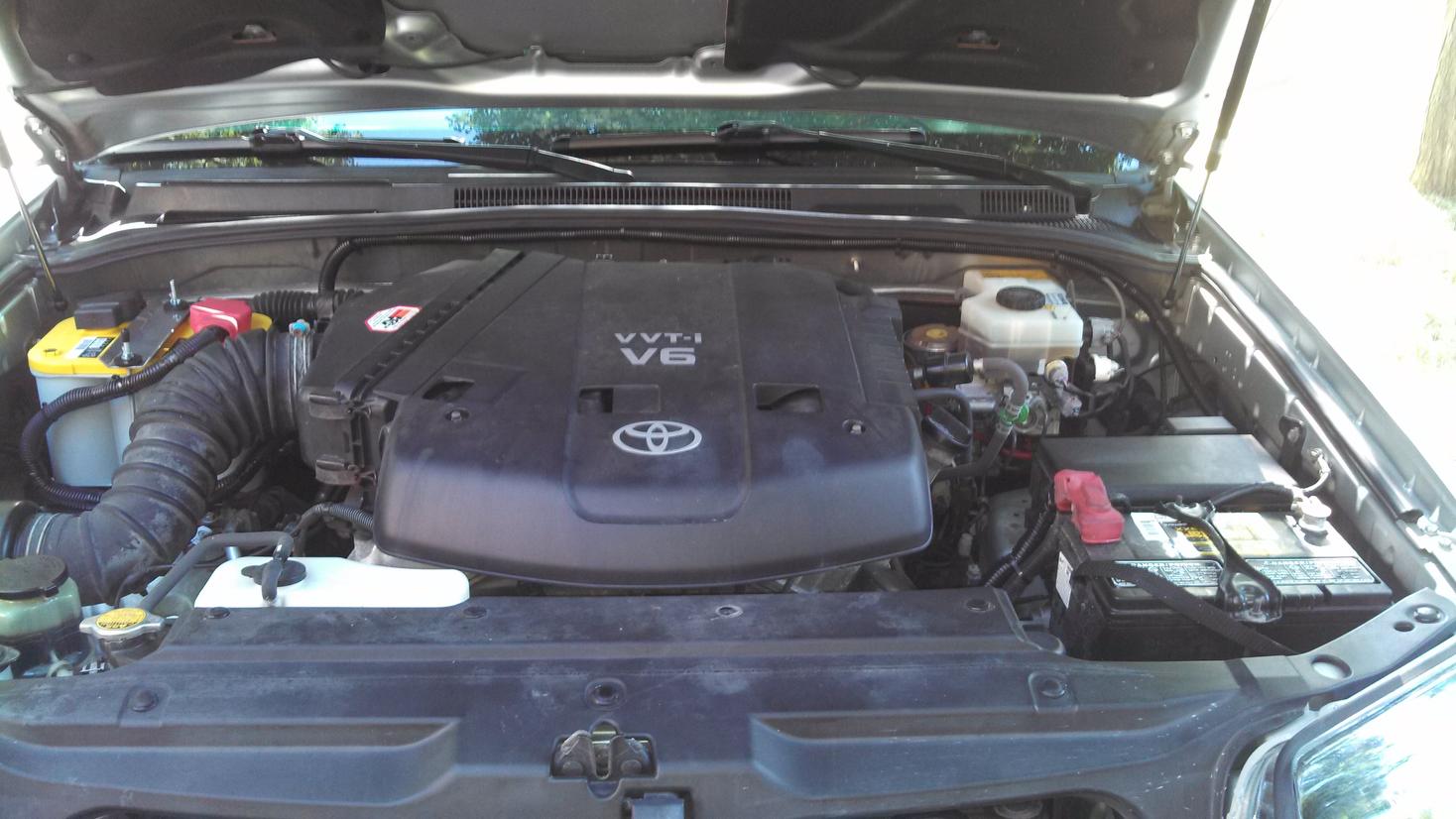

Finished up my "Dirty Parts" 2nd battery installed and added my T4R.ORG decals to the rear windows today.

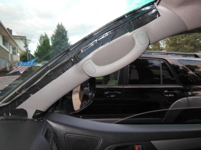

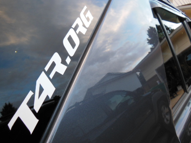

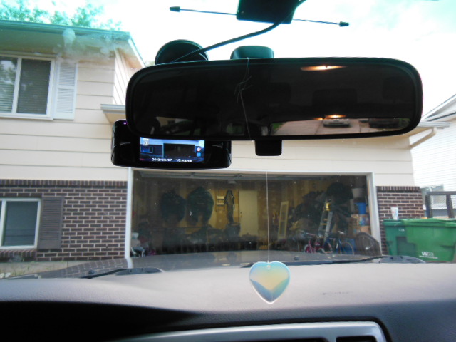

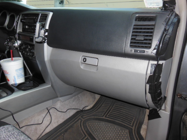

Here's my new dash cam pictures!! Im a rookie when it comes to mods so please don't laugh too hard. I just used a bunch of duck tape :) and put it under the floor mat!! It has a great picture and it looks pretty good at night too, I haven't looked at it on the computer yet so Im curious how detailed it will be....Oh yeah heres the stickers Ive collected so far and cant forget the t4r.org decal :)

Cool idea but that duct tape makes me cringe. You could just tuck those wires behind the plastic pretty easily.
How? I would love to...I just dont want the wire hanging
pull the bolt covers off the oh sh!t handles, take out the bolts, disengage the clips and there's a claw on the bottom, basically just pull up and out and that plastic piece comes out. to drop the headliner enough to get the wire back, tke the visors off, some 10mm bolts, maybe pull off the map light assembly, just shove the wire behind. Give it a whirl. I may be able to make a video tomorrow if you can't figure it out, let me know
You are better than Duct Tape!!
