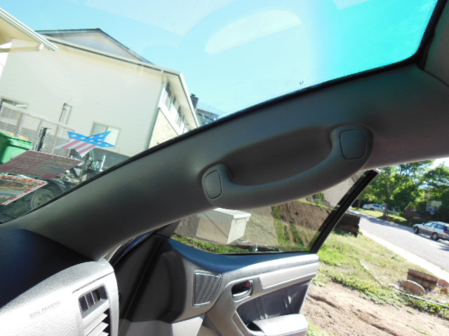

pull the bolt covers off the oh sh!t handles, take out the bolts, disengage the clips and there's a claw on the bottom, basically just pull up and out and that plastic piece comes out. to drop the headliner enough to get the wire back, tke the visors off, some 10mm bolts, maybe pull off the map light assembly, just shove the wire behind. Give it a whirl. I may be able to make a video tomorrow if you can't figure it out, let me know

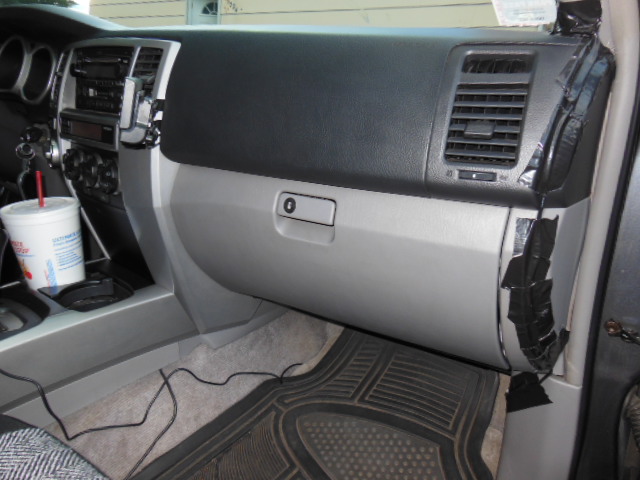

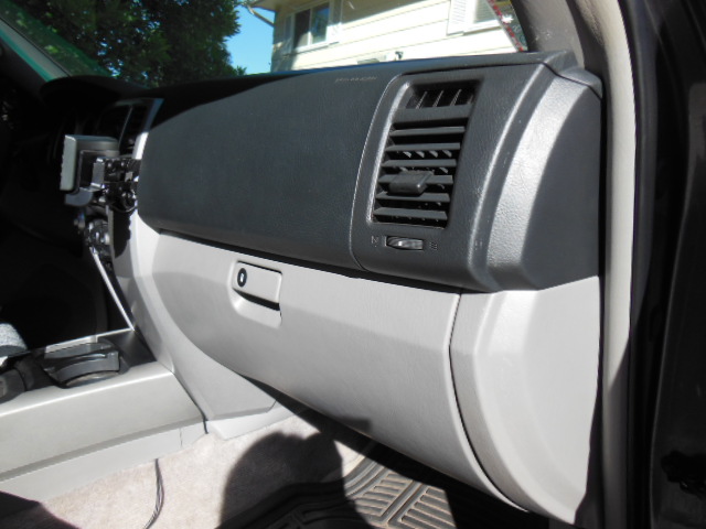

That doesnt sound too bad. I already have the wire tucked in the ceiling but once I get it to the dash where does it go? I took off the glove box yesterday but couldnt figure out if there was a way to put the wire through there....

between the panels, as indicated in red. Just separate them a bit and pop the wire in there. black piece under the glove box, stick the wire back there behind it, it'll stay. You should just hardwire it into the cig lighter or an unused fuse slot or something too.

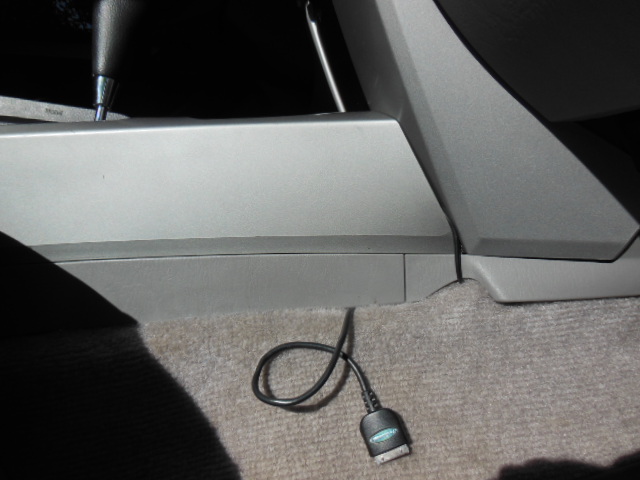

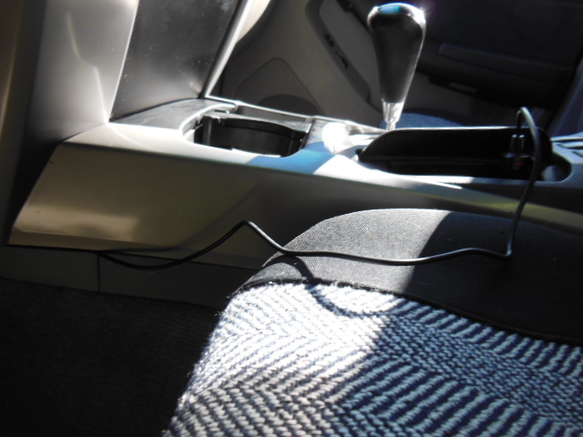

I didn't take the whole panel off then tucked the rest along the crack like you said. Once I got to pic #3 I removed the center pieces and put under the cup holder!! Thanks for the help....I was jumping around after I did it like a kid, my husband thought I was crazy :party:
