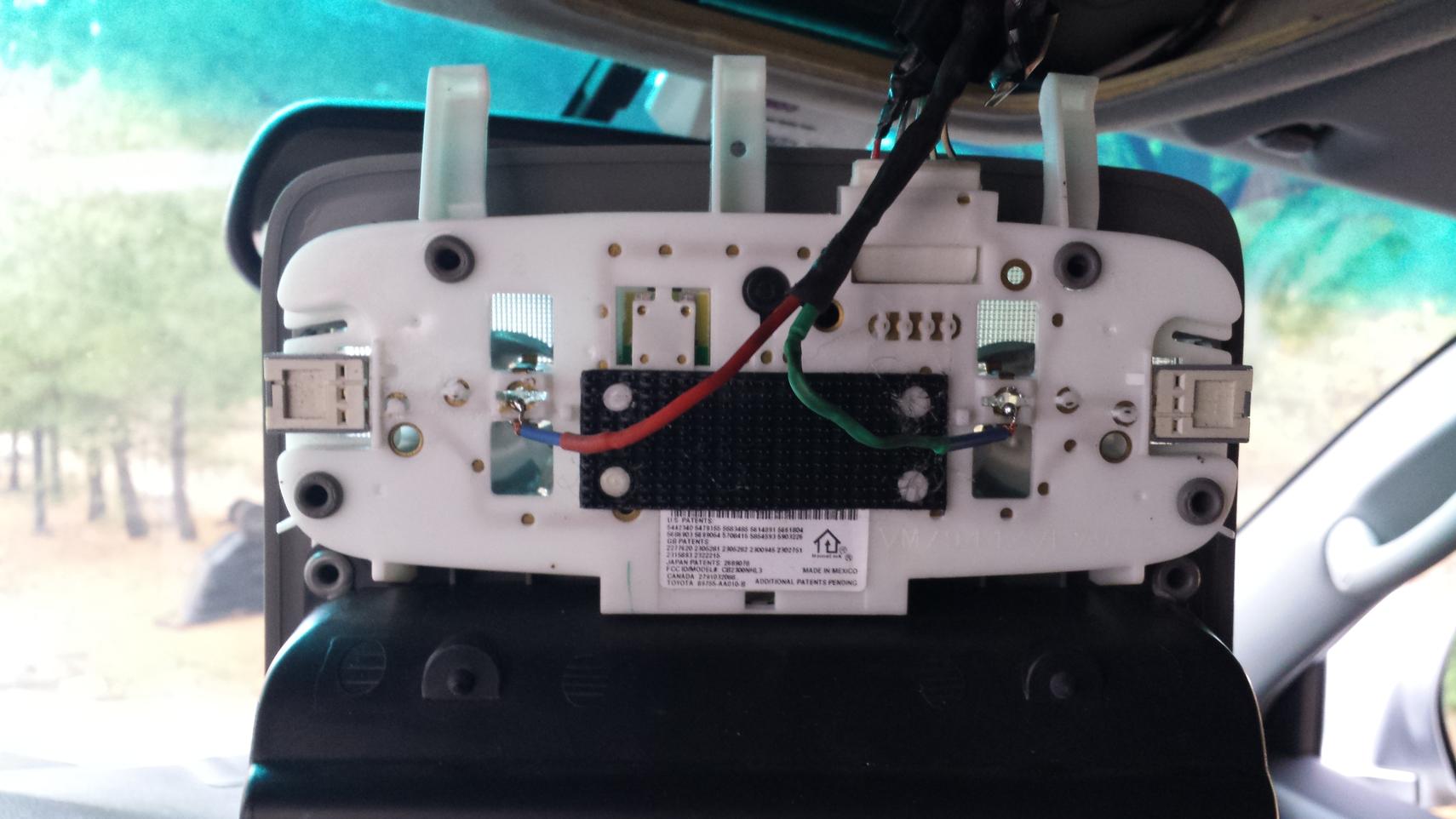

did the map light mod yesterday but didnt like how if you turned on one map light all the lights came on so thismorning i added 2 small diodes on the back of each map light now each maplight is seperate but if you open the door or turn on the dome they all come on

Did you happen to take a pic of where you put the diode

the diodes are number 1n4148 and they are inside the green and red shrink tube soldered inline with the wire to the ground side of the bulb socket. also be sure to put the cathode side away frome the map light because its ground controlled its backward from normal
If you had put the wire in the empty 3rd pin hole on the switch it would have been easier
