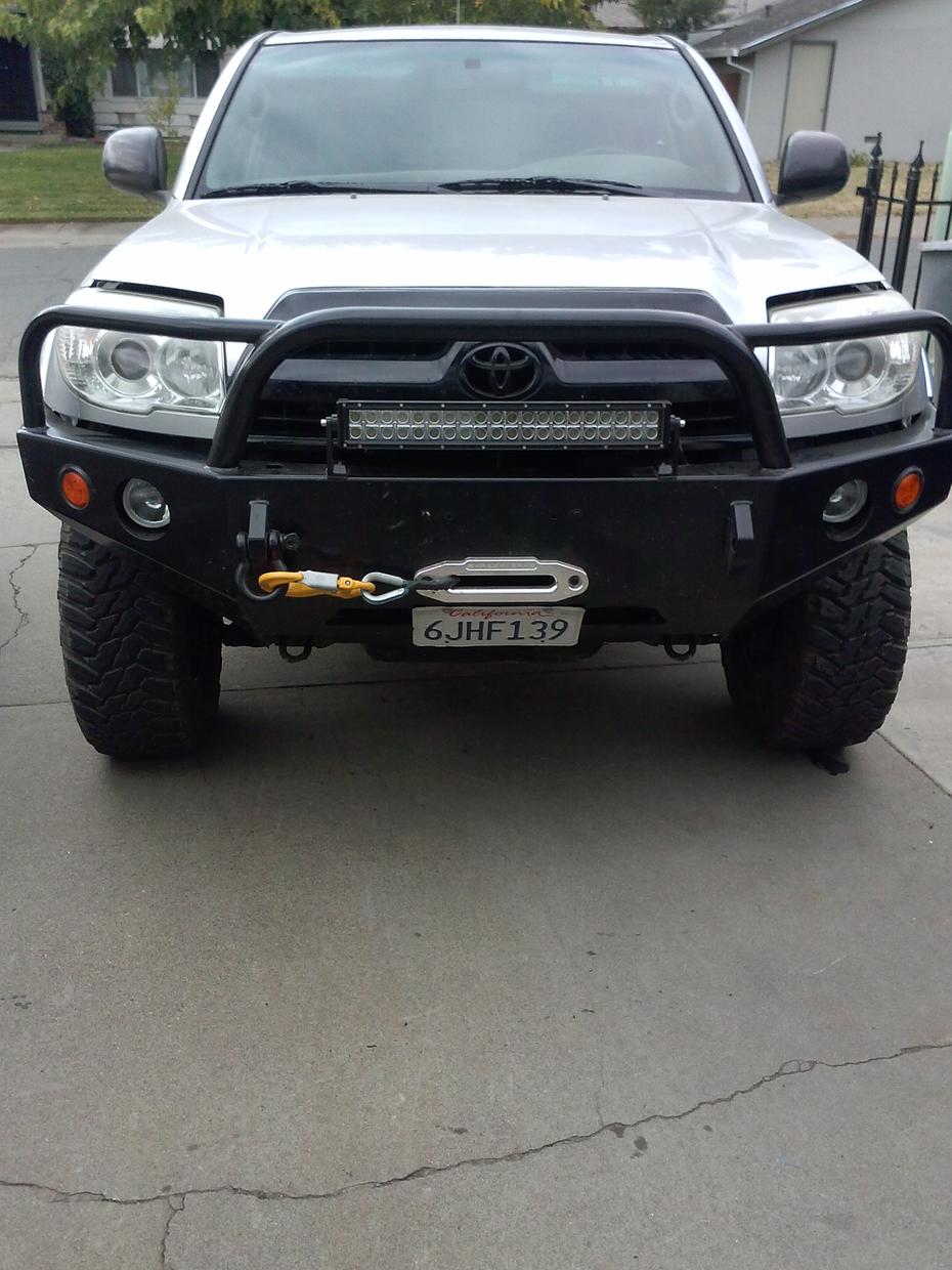

Light bar
I installed this light bar on Friday before the trip.
