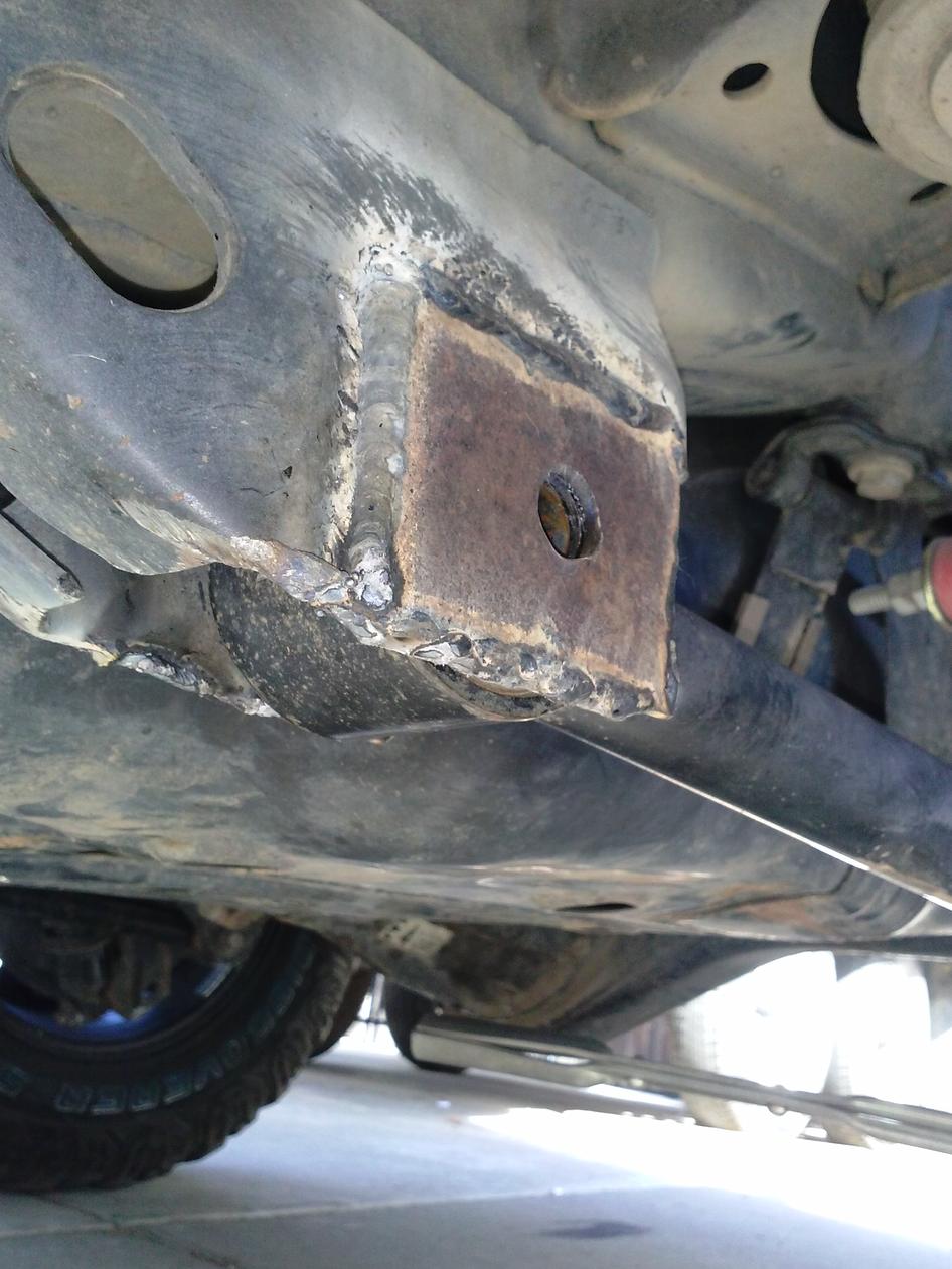

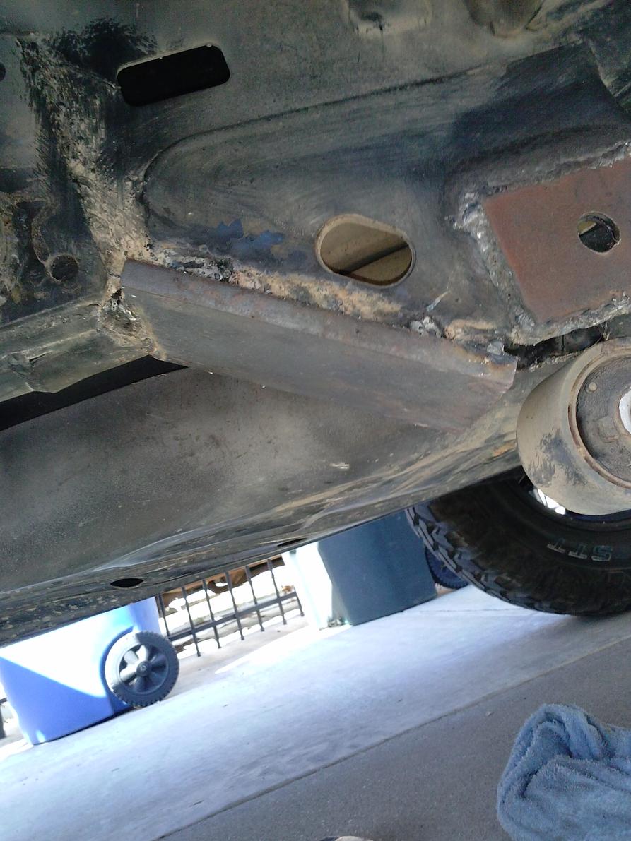

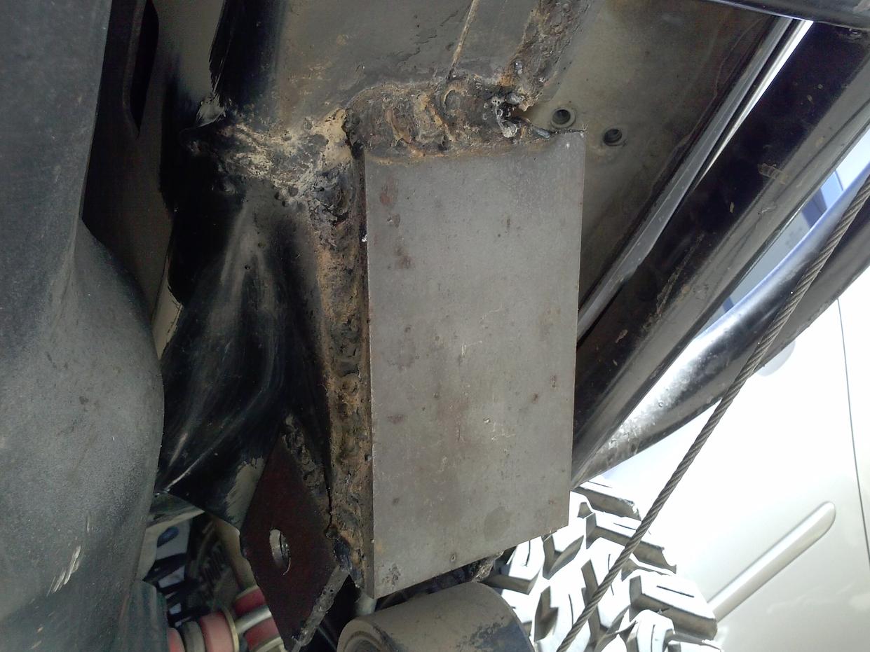

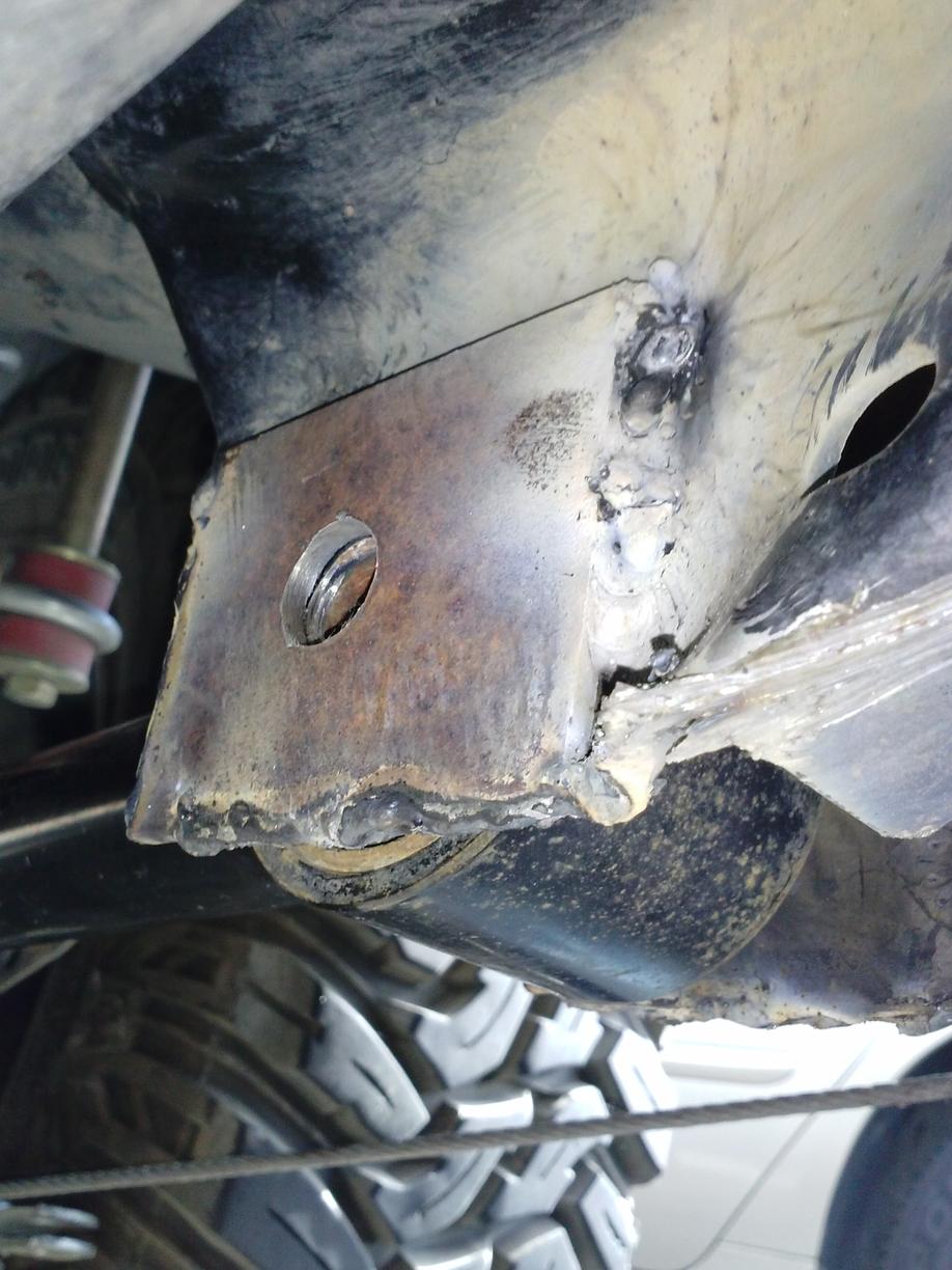

Reinforcements
Just added some support plates to my rear lower control arm brackets.
They where taken to many hits and bending. 1/8" on the sides and 3/8" plates on the bottom.
