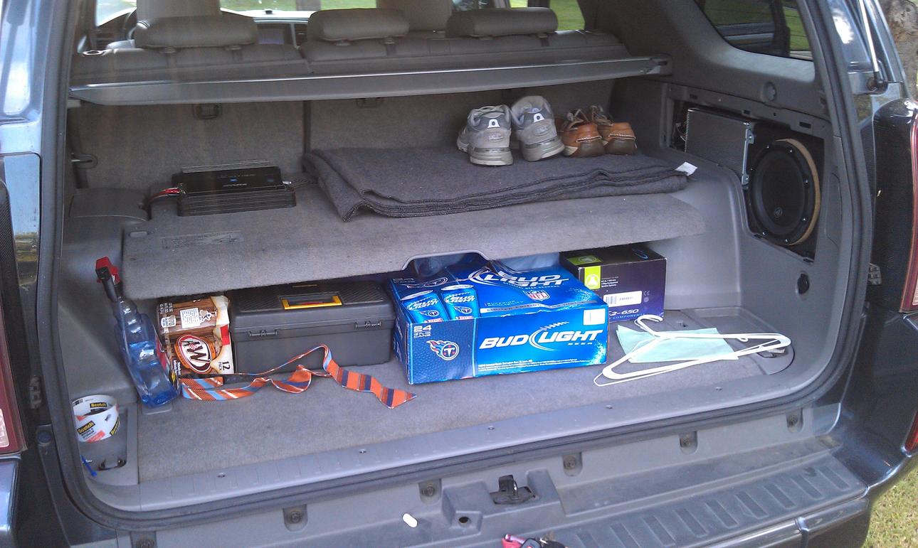

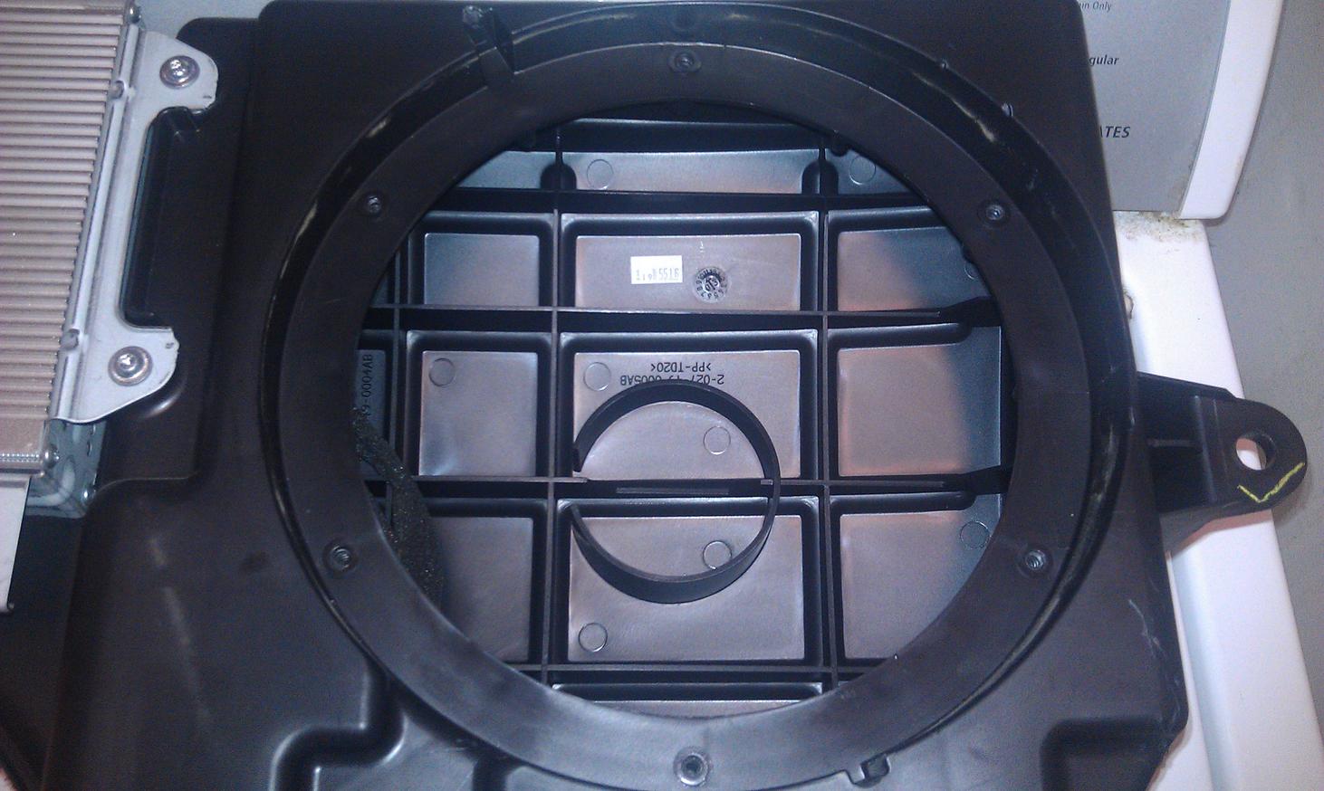

Finally finished my factory sub replacement. Went with a JL 8W3. That being said, it was difficult to make it fit, but after it's all said and done, it's sounding good. I used Ark's Sub Switch as my inspiration. Obviously, it's easy to see how I'm enjoying the new cargo space. (Used to have 2 10's in a box taking up so much room in the back)

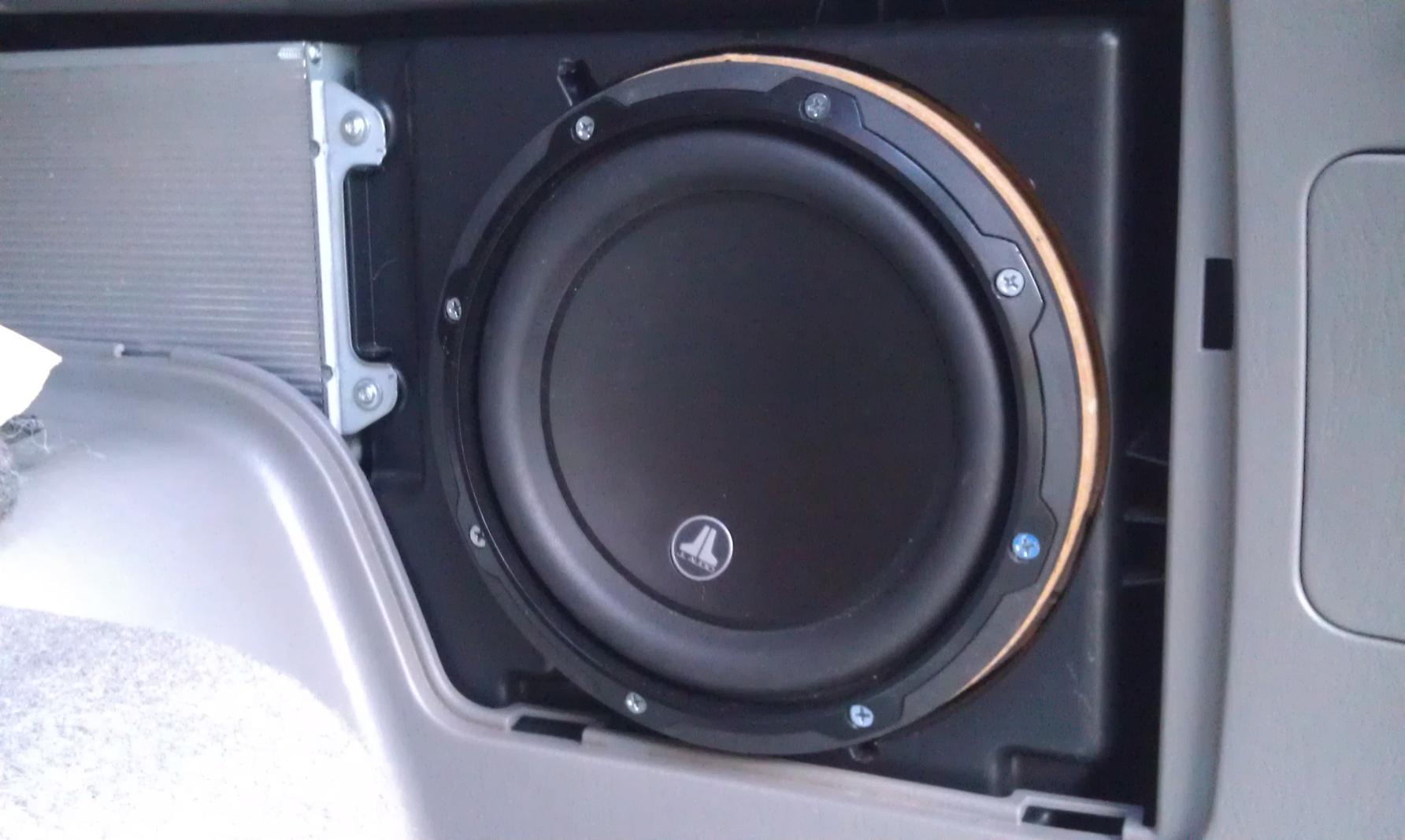

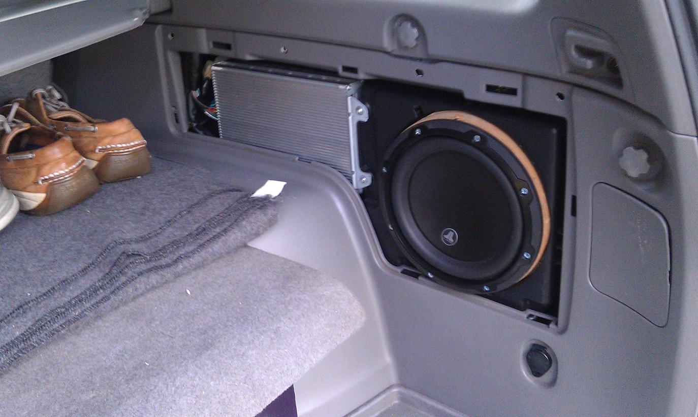

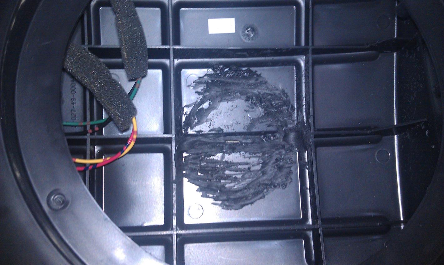

Yea, I actually did have to use a spacer ring. It was about an inch to get it to clear the back of the enclosure. And yes, I did trim the back of the enclosure. See... My only thing is that it sounds ok. Not great. I am afraid that the sub is just too much for the volume the stock box provides and it is just being choked for air. That being said, it does seem to be pushing a little bit of air out of the sides of the spacer ring, sub, and enclosure, but I didn't think that would be enought to really cause a problem. Again, the sub is a JL 8W3v3-4 so if anyone feels so inclined to weigh in with a professional opinion, I'd love to entertain some ideas. I am happy with the way the install came out astetically, just wanted some more thump. (Using a MRP-M450 to power the sub if that helps)

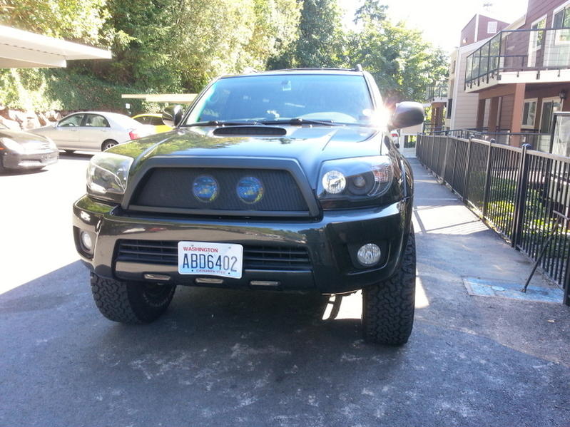

1) Took the running boards off. We will see how that goes with a 3 and 1 year old. Makes them tougher with the harder ingress and egress...
2) Flat blacked out the stock 17's. Cannot afford sweet wheels now; also sick of the other silver Runners JUST LIKE OURS!!!
What did I do with my 4Runner today?
