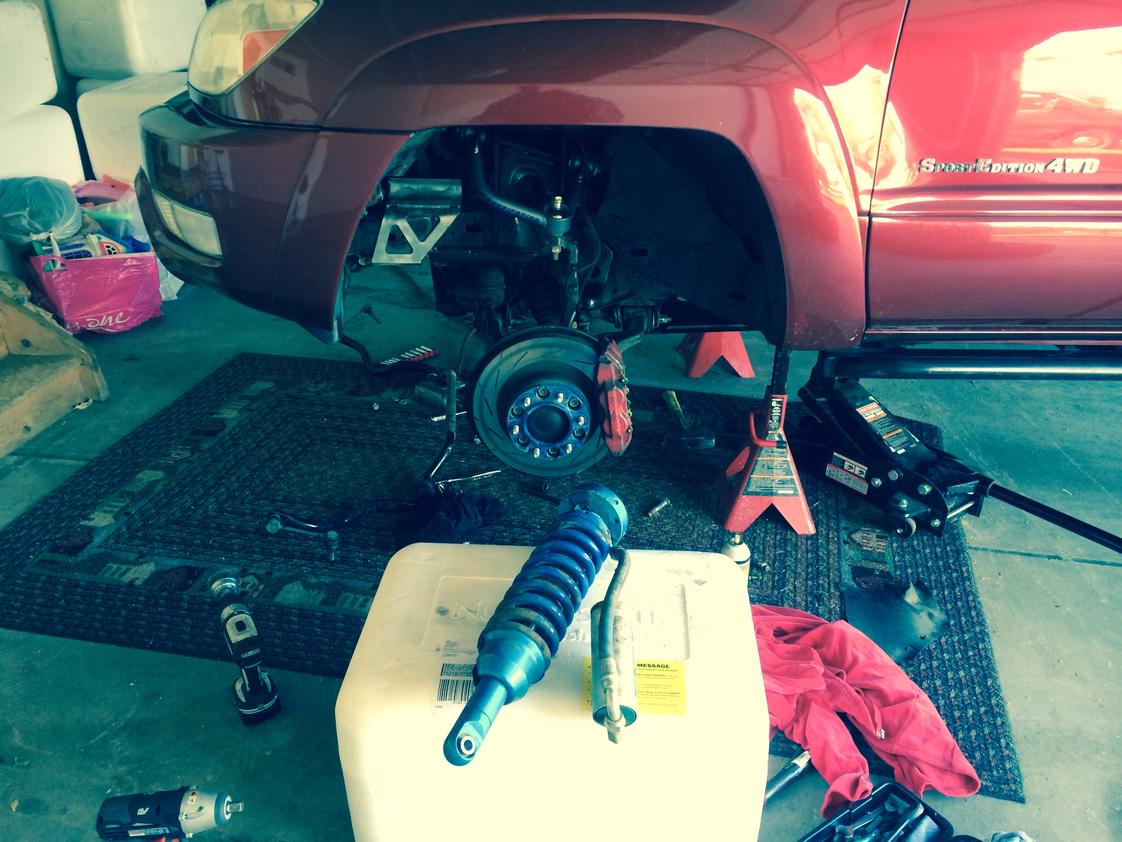

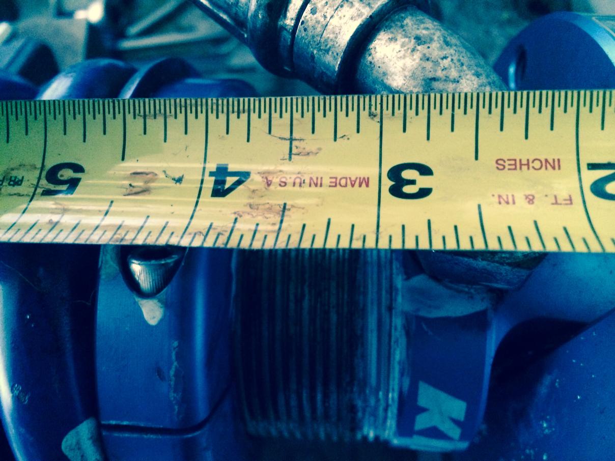

Finally took the time to adjust the King Coilovers.
I went up 10 turns which should be 2" of lift. It actually measured 3" increase so I think there will be some settling. This was a good 4 hour job for me but it is done and alignment is done too.
After getting these off the 4Runner it is clear that I need to plan on getting them back to King for a rebuild. No issues but they look a bit worn.
