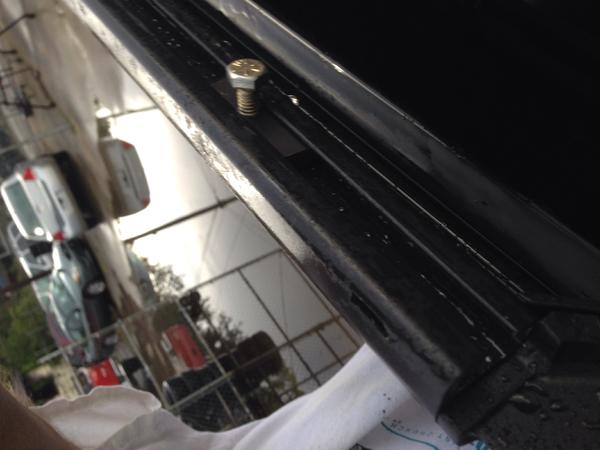

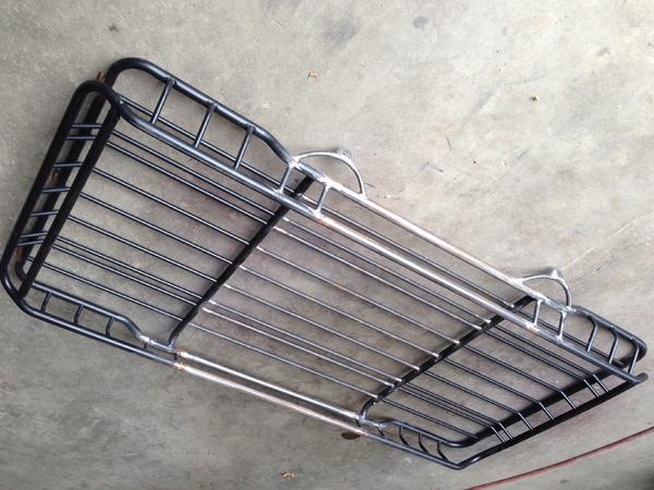

Rack finished....Stupid phone pics....If it looks familiar, it's because it started life as a Rage powersports roof basket. We added 28" to it, added light tabs and low mount brackets.
Tip: Want a heavy duty draw bolt? A 1"x 1/4" flat bar cut to 1 1/2" will slide in the factory rails. Drill it with a 9/32 drill bit and tap it with a 5/16 tap.
The open space between the rails has a panel that will go in it's place when done.
Still may do a repaint, and install the security bolts. I finished another project Saturday, I'll get some pics later...
