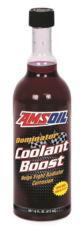

Just recently I had the second timing belt done with all the fixens, and on each coolant change, I add a bottle of Amsoil Boost. Its Formulated with proprietary tiered surfactant technology, providing quick and effective heat transfer inside radiator and cylinder heads, which results in reduced operating temperatures, more efficient operation, increased horsepower and significantly reduced engine warm-up times in cold weather.
