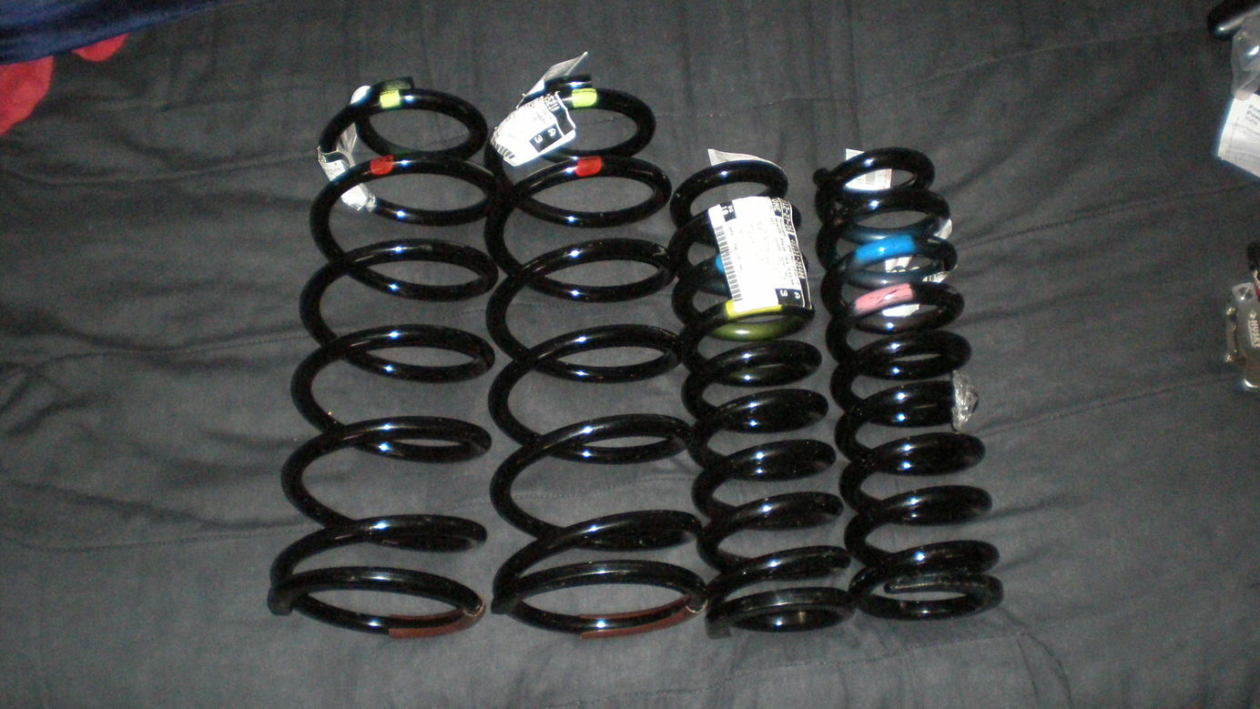

jakov, if you need the part numbers for the tall 99 springs, I can post them for you.

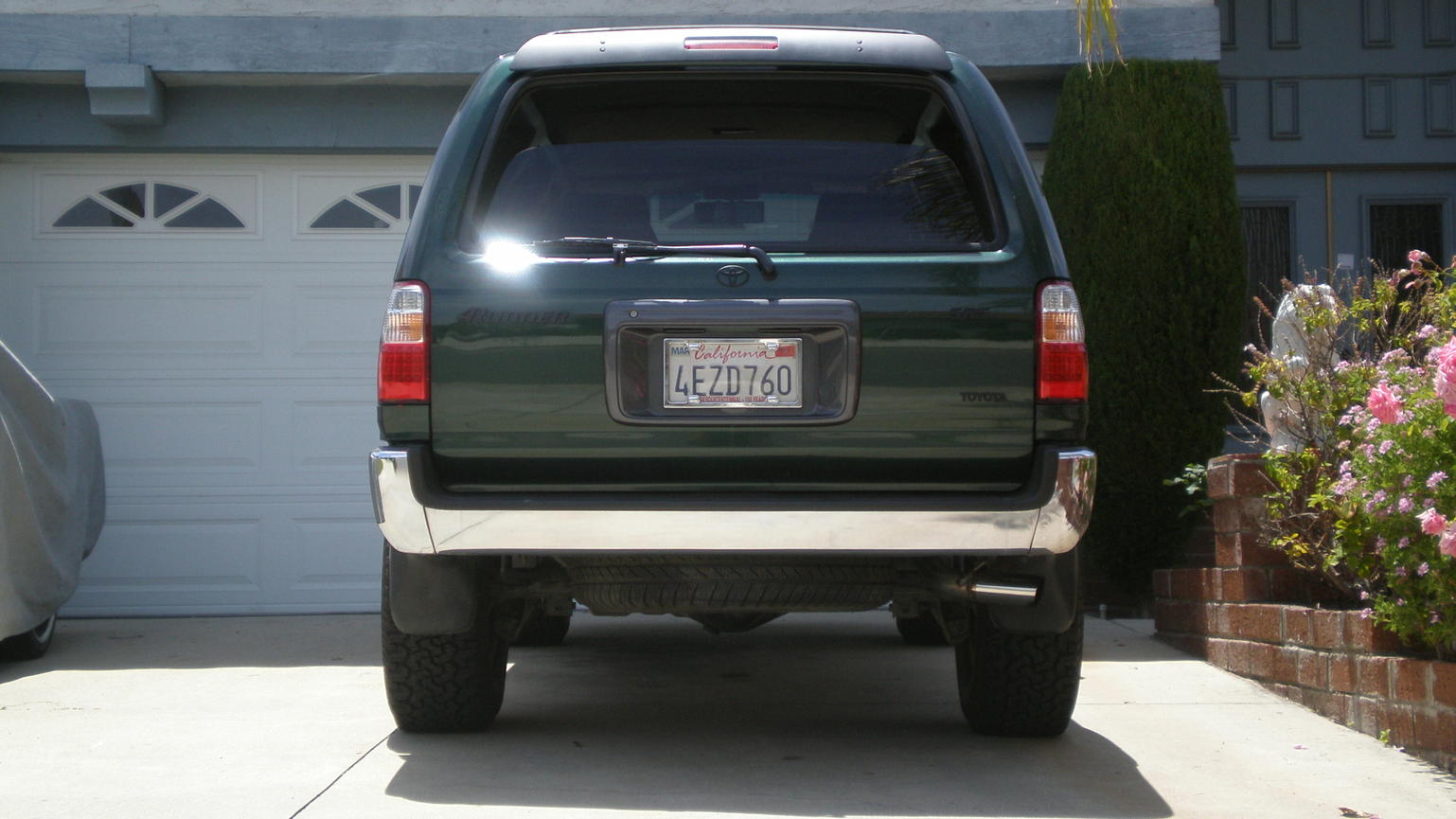

I just ordered all new springs and shocks. My left side sags a lot too.
When I get them on, I will make before and after pictures.
See my sag? Here's the solution, in a big picture.
the spcers are on the truck now
seems that i need to open the spacers more cause is saggin less but it still left side fallen. its true the GAS tank is there and the driver same side /maybe A MISTAKE/ well... seems my truck haz been envolved in some crashes and accidents and need some adjustments. ifound that diferential is leaking oil front suspention is moved back/ gauge stuck floater/ rear sagging. front choke cristal crashed. no alloy wheel/ motorengine is in exelent shape silent .but SADLY IM GOING TO SELL IT and search for another one... EVEN SO we all knw TOYOTA RULES ..
