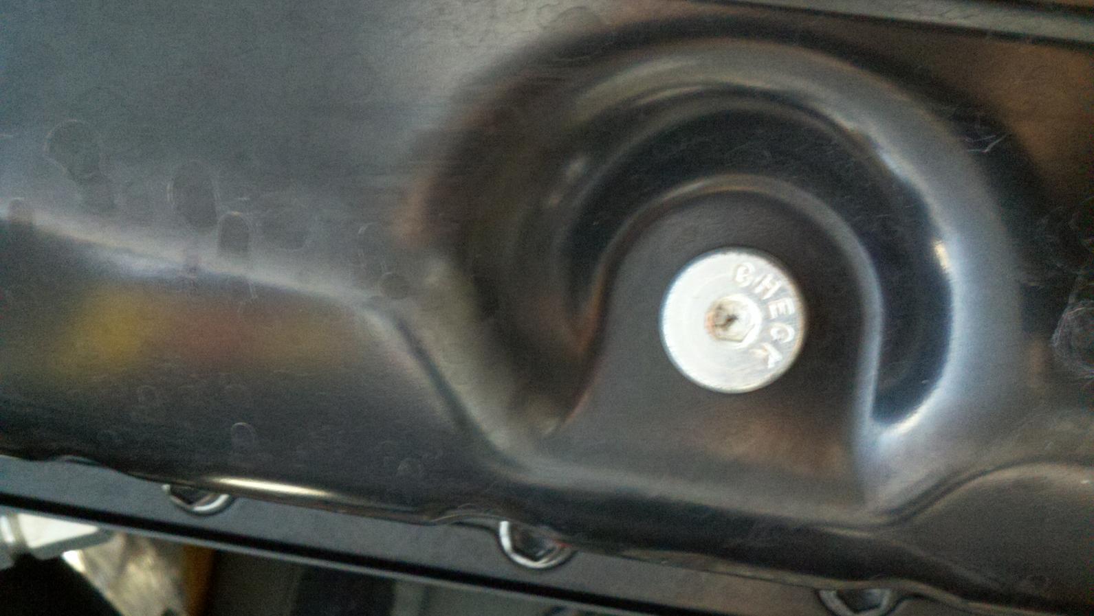

Stupid newbie question, but what is this plug on the bottom of the transmisson for?
While I was under my TE today perfroming my 10k mile service, I was just looking around and saw what looked to be a drain plug for the transmisson pan and there is also the plug in the photo that has the word "check" stamped on it.
I have not been able to find a dipstick for the transmisson, does this plug somehow check fluid level? How do you refill the trans fluid when you change it?

There is no dipstick, and that is the hole you use to fill and check fluid level on the trans. Fluid change interval is 100K miles. When you price Toyota WS fluid, you won't want to do it ever 25K.
