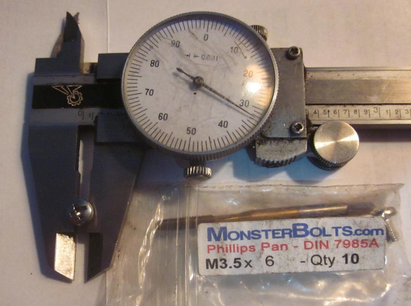

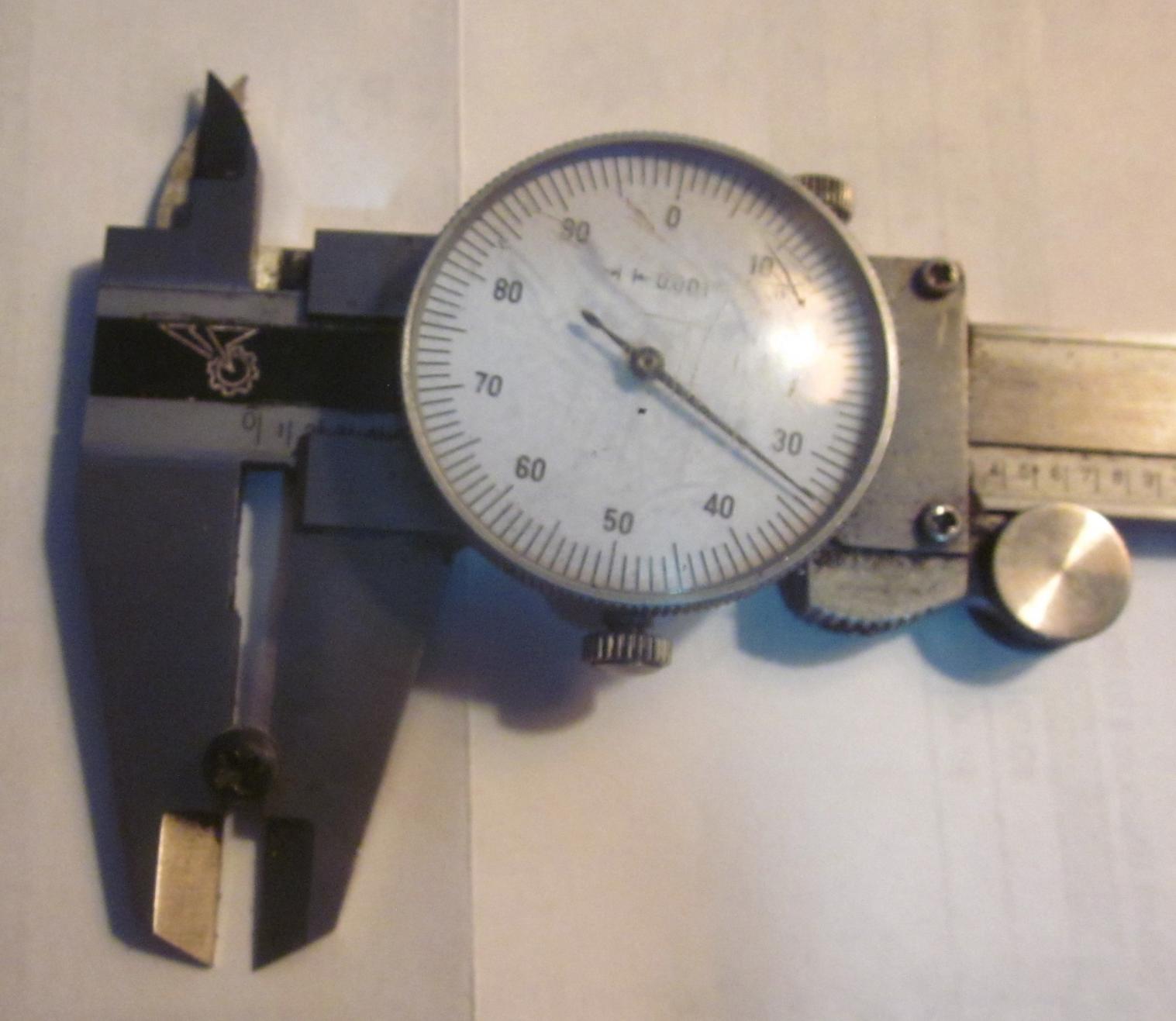

This is interesting. I guessed it was an ordinary M3 screw and was all set to make a flippant, dismissive reply, but figured I'd pull one of the screws and measure it just to be sure.
Glad I did. It's an M3.5 screw. I happen to have some M3.5 screws - reason below - so I measured one of them and found it matched the diameter of the 4Runner's wiper screw. The first photo shows a measurement of the Toyota screw; the second shows the measurement of an M3.5 screw.

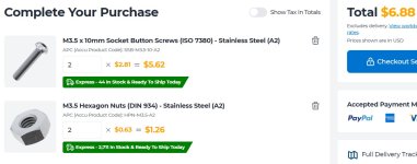

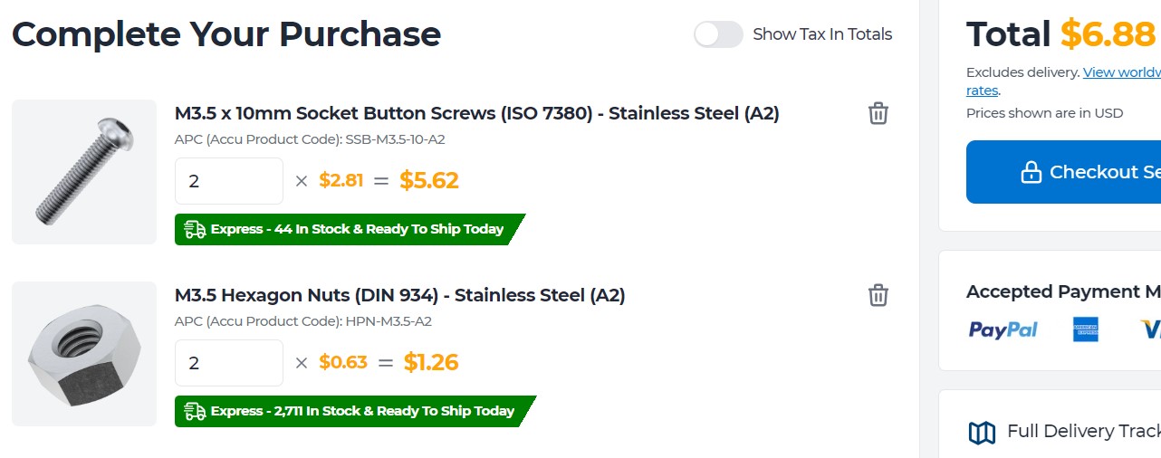

I would do this: visit this company
Just a moment...
and purchase 2 socket button head stainless M3.5 screws in of length 10.(That's the only head style they sell in M3.5)
Also purchase 2 nuts. In stainless.
The screws are longer than what was already there, but the extra length is so you can put a nut - use some Loctite - on the back side.
As I see it, the problem with going to a larger size is that these screws sit in a little trench. The trench won't accept much bigger than what was already installed, which I measured at 0.228".
The M3.5 screws I use for carburetor repairs scrape the trench side as they go in. But they do go in. I'd send you two of them, but they're the same length as Toyota's screws so they won't do much good in a fully stripped hole.
Since these screws I suggest are "socket button", ie Allen key, you can grind down the outside just a little bit if needed. And since they're stainless, no rustable surfaces after grinding.
