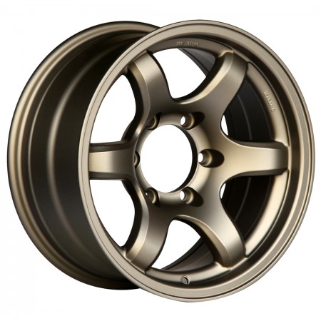

Hey guys can someone tell me the offset and backspacing for a 3rd gen's 16" rims and would a rim with these specs fit?
16x8"
6x139.7mm (6x5.5") bolt pattern
0mm offset (4.5" backspacing)
Thanks!
Pretty sure the backspacing is 4.5" on the 16x7 rims. And yes the 16x8 rims should fit seeing as they have the same specs and the Land Cruiser 80 rims.
what particular wheel are you considering?
Konig Countersteer off roads
thanks for the replies and so if I go with these wheels how far will they stick out?

That's a pretty popular wheel for 3rd gens. You're looking at flush, maybe 1/2" past the fenders...it also depends on the tires you have.

If you got those, I'd go with the 0 offset...stance would be perfect. Just for visual, here's mine with 285s...
so when you say flush you mean same as original 3rd gen alloys? 1/2 out wouldn't be bad either I have the factory thin chrome flares on.
and im going to be going with LT265/75/16 BFG All Terrain TA KO
No, I mean flush with the fender. The stock wheels were made to set inside the fender. A 4.5" BS and 8" wide wheel will will protrude further out than stock. IMO the size you're looking at, and that I have, work perfectly on our trucks. Stick out just enough to look good, but not too far causing debris to sling up and damage paint. Take a look halfway down this page at Speedy's setup...this is what yours would look like (although your flares are different).
