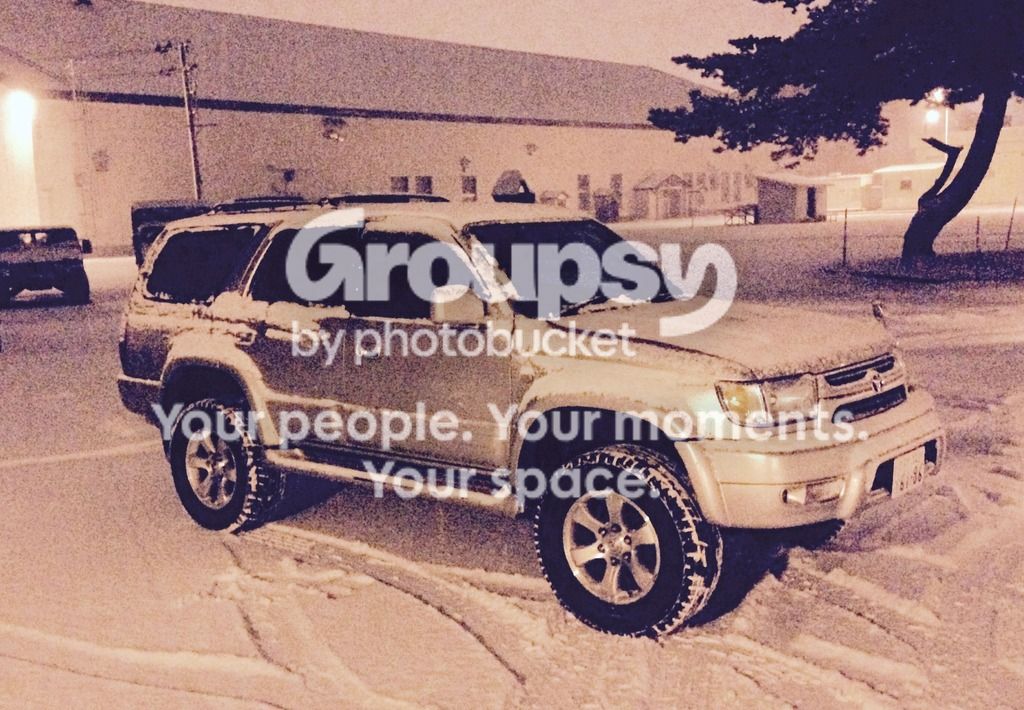

Stock height, Spider Trax 1.25, 265/70/17
Had to cut flare on front side an pinch weld on back side but I'm happy with the look

You did 1.25" front AND back?
I heard somewhere on this forum that our 3rd gens have a .25" shorter rear axle than the front, and it would be recommended to get 1.25" front and 1.25" rear to even out the stance.
Anyone else hear this as well or know of the axle lengths? :twitch:
