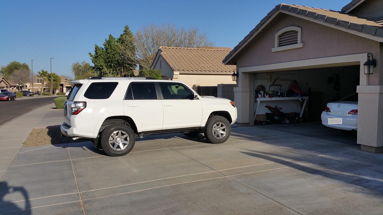

I finished the lift today and I'm sure will be sore tomorrow. To recap 6112 3rd clip and 5160s with 1.5" spacers. Given all the numbers Ive read in this forum it seems like I had one of the shortest 15 TEP runners around.. Soooo that means my lift will have exaggerated numbers. One other strange thing I ran into; my 5160 came with a frame mount for the reservoirs but the frame doesnt have a threaded hole so I called Bilstein and theyre looking into it.
Before: Frame: F13.00 R13.9 /// Fenders: F34.00 R36.70
After: Frame: F15.6 R15.8 /// Fenders: F36.9 R38.3
One quick pic. Will update with a better one tomorrow.

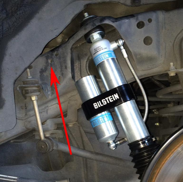

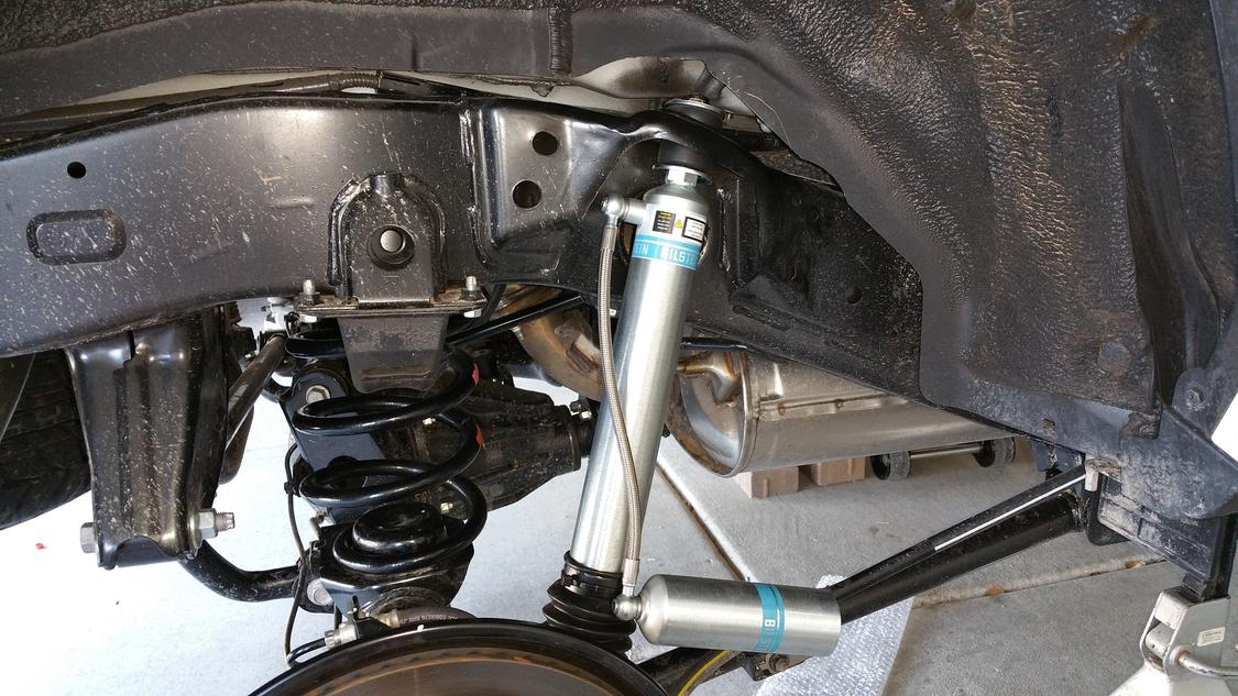

Look closely forward of rear shock mounting on the frame. There should be one hole with threaded backnut. The kit will utilize a "L" shaped bolt for the lower mount.
See photo for location....
[MENTION=130782]carrera0to60[/MENTION] ,
Hope this helps!

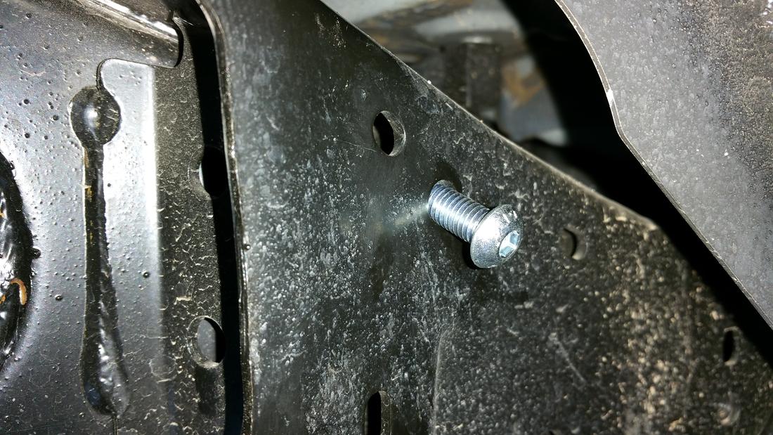

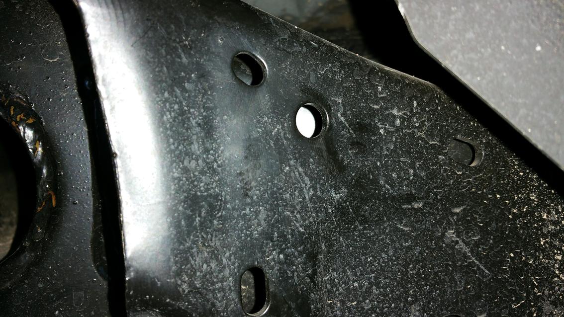

I appreciate the picture. When I called Bilstein they asked about the holes near the sway bar end-links and I wasnt sure what to tell them since I have KDSS
Take a look at what mine looks like.
Looks like you have no choice but to get a set of the aluminum mounting clamps. [emoji2]
[MENTION=130782]carrera0to60[/MENTION],
I am in disbelief and stand corrected, sir!
Why would there not be a backnut there?
Wondering if you could put a Rivnut there!!!!!
or
I am wondering if Bilstein has another kit they can supply you with that will remedy your situation.
I don't think they will send you the clamps at no charge, maybe you can talk them down a few $$$ and have the overnight them!

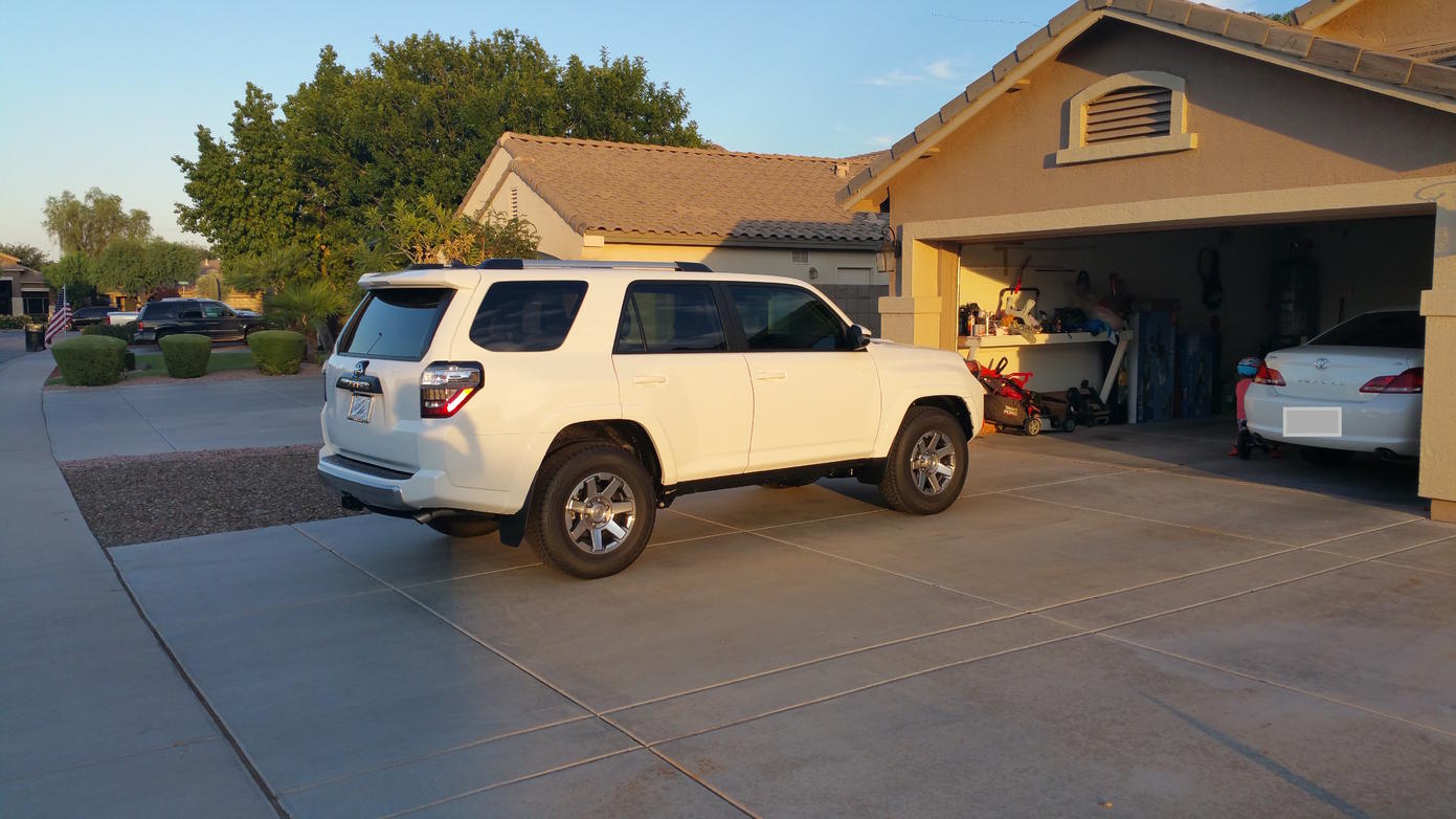

Here is my truck with the 6112's set on the 3rd clip and rear Icon 2" lift springs. This resulted in a front lift of 2.125" and 2.5" rear, measured after putting 350 miles on this set up. The only settling I've measured is the passenger rear settled .25". I do have a slight "Toyota lean" with the driver's side .125-.25" lower. I'm good with the final result, definitely prefer the ride over stock, and don't mind the rake since I typically carry 150 lbs in the back. It took a long time to figure out what I wanted/needed, and I'm pleased with how it all ended up.
BEFORE and AFTER pix (note that the parking lot is slightly angled, lower on the left and higher on the right in these shots):
Before lift (unloaded)-
After lift (unloaded)-

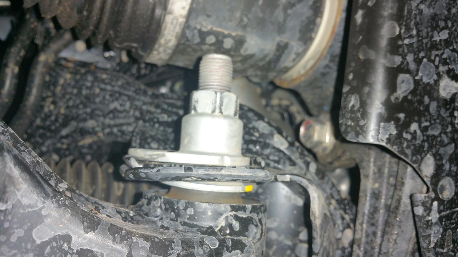

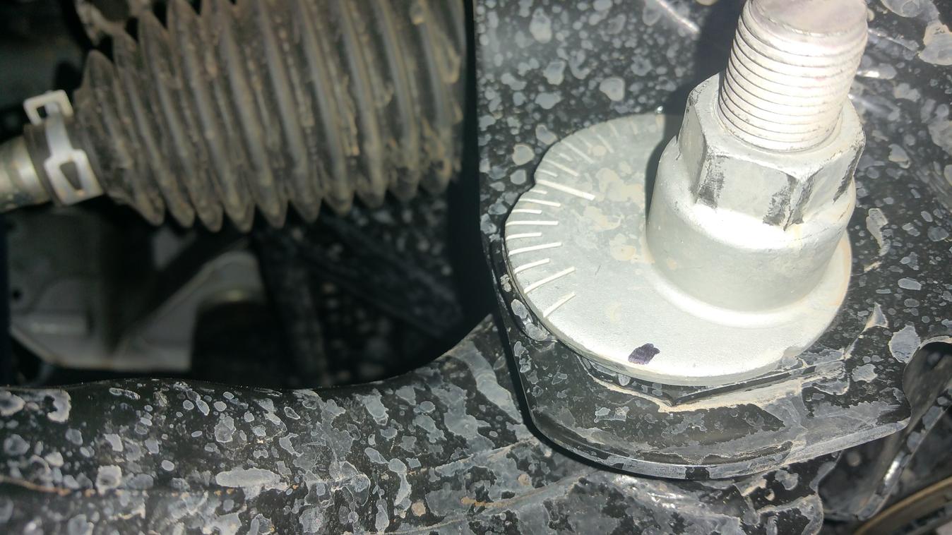

Ran into another problem today:frusty:
I took it to the alignment shop and they had it for about 4 hours. When I picked it up I asked for the spec sheet and everything looked good and "in the green" but they said it took them forever to do and was PITA.
About a mile down the road I could tell that it was pulling to the right so I turned around and went back to the shop and told them that the steering wheel was angled to the right and it was pulling to the right. I encouraged the guy to drive it, so he could see what I was talking about. I got a call about 2 hours later saying that they were stumped and to bring it back in a couple days when their tech is back to work on it some more. They were trying to tell me that the rear axle was moving and that the thrust angle was changing. I've heard of stranger things happening so I went with it. They asked what I had loosened on the rear and wanted to check the tightness of everything.
So I got home and laid underneath with a flashlight and I saw this. Its the drivers side toe adjustment cam. As it sits right now, the cam is sitting on top of the tab and bending it outwards. I'm not sure what my plan is from here but needless to say Im angry and annoyed. Obviously with the toe cam out of its "groove" all bets are off.
