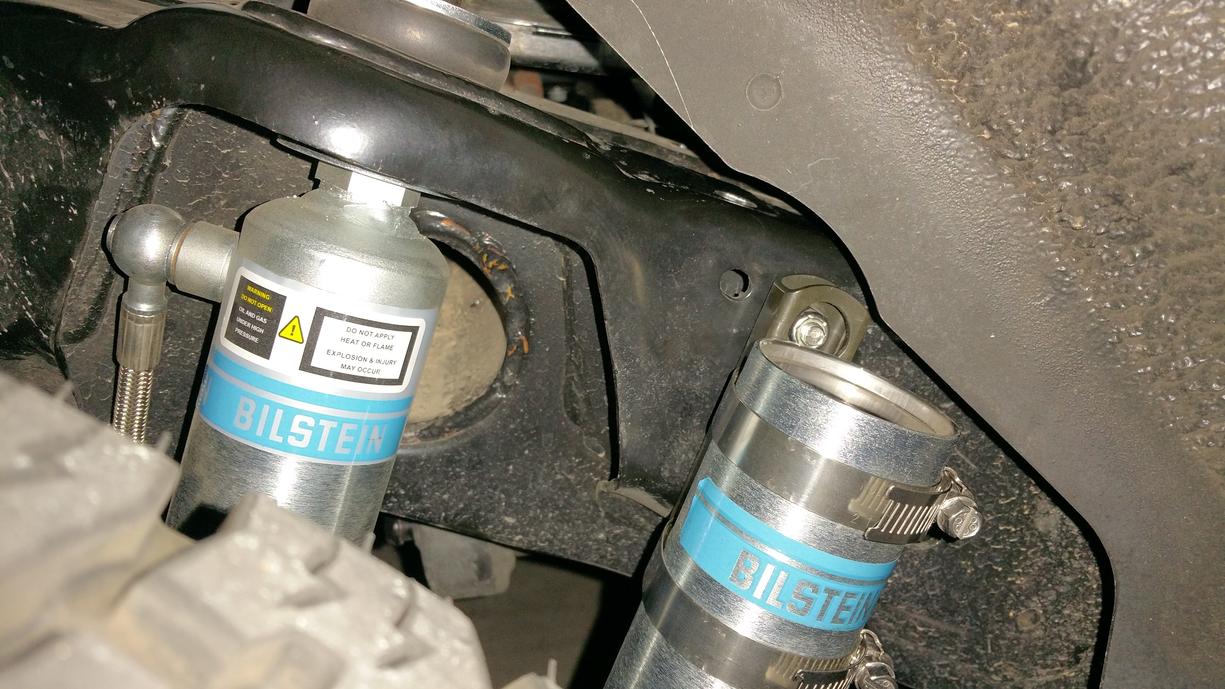

On a side note, I finally got the reservoirs installed with the extra hardware Bilstein sent. Seems to work out ok.

In the event that someone has the same issue, please inform us as to how they corrected the issue of the frame not having a threaded nut for your install of the remote reservoir.
Looks like they sent a couple more "L" bolts..... is that correct?
I hope you have a good outcome and they pay without issue.
Please inform us as to how they corrected the issue of the frame not having a threaded nut for your install of the remote reservoir.
You are correct. I sent this to Bilstein as feedback.
The extra L hardware works about 90%.
Here are my observations:
1. A hammer is required to get the L bolt into the "unthreaded" hole so its a one way street, they will not be coming back out through the same hole.
2. A screwdriver is required to be stuck through the adjacent hole to prevent the L bolt from spinning when tightening the nut.
3. The L bolt is about 4mm too long so it will contact the reservoir if it is mounted too high on the bracket.
4. The additional hardware was supplied with nylon lock nuts which is a nice and appreciated upgrade over the standard nuts that came with the shocks.

On a side note, you may be able to take a dremel tool and cut that bolt off enough to slide your reservoir up where desired.

I was thinking that too, but there is a nylon washer between the bracket and the frame and I don't think I can do it without melting the washer. As I mentioned in the observations theres no way to get the L bolt back out so I think I'm stuck between a rock and a hard place :confused: oh well, I'm happy with it as is.

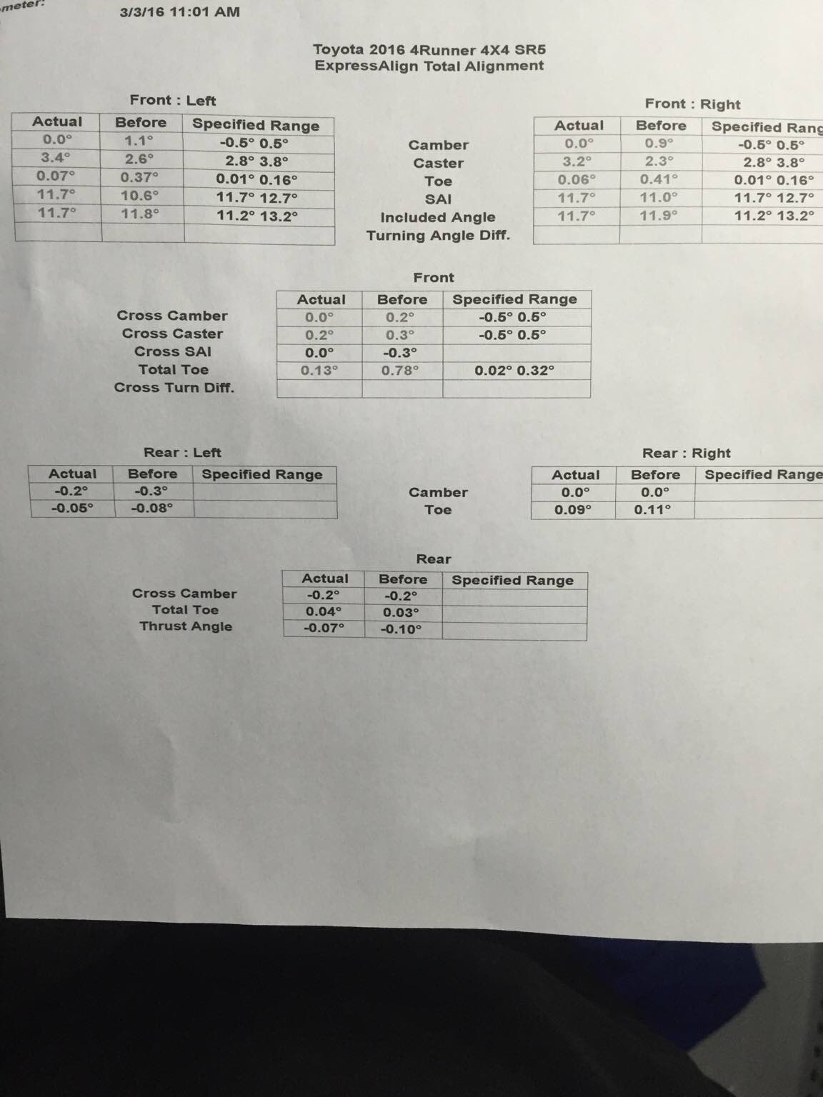

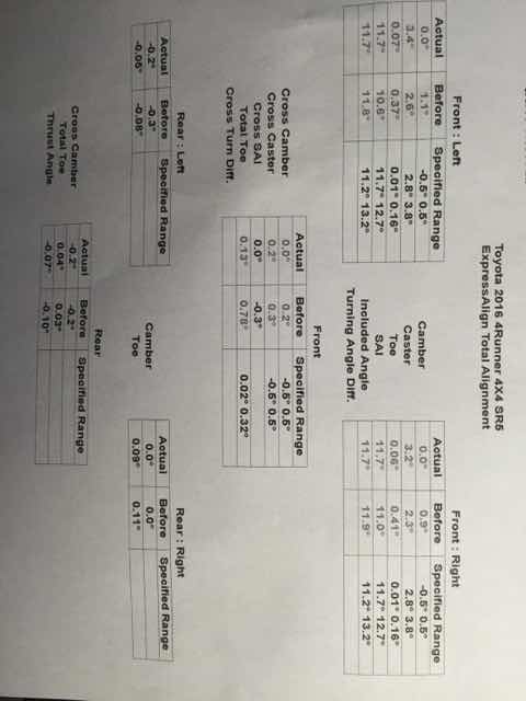

Ok so I promised some pictures, however it is dark out. But I will post some feedback and alignment sheet. I had a professional 4wd shop do the install because they have taken very good care of me and many fj members before.
1. For everyone on the forum that say the factory UCA's don't have enough adjustment for 2"+ or have trouble getting it back in spec or are super close to it not being in spec, your dealing with either an inexperienced alignment tech or they were just plain lazy. From talking to the tech today, he was able to get 3.4 degrees caster left and 3.2 degrees caster right in the front with no sacrifice to camber, toe, or cross caster.. The tech said the caster was spot on but if needed, there was definitely more room to go. So I hope some people searching can be put at ease with the fact that yes there is plenty of adjustment in the factory UCA's to accommodate a sub 3" front lift. I know some people said its fine, but I've seen many others with problems.

Overall I am very happy with the result of the 6112's and would highly recommend them. I hope this puts some people at ease who question about running factory UCA's. Yoj absolutely can on a sub 3" lift.
