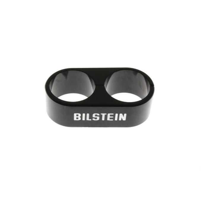

Are you talking about the same Bilstein Clamps shown on their website and pictured?

Yep, those are the ones. That's what he said, I was annoyed to hear it too since I was planning on getting the clamps regardless if the were going to give them to me for free or not. It does make sense though, only based on the fact that they don't supply the cheap piggyback mounting hardware in the first place.

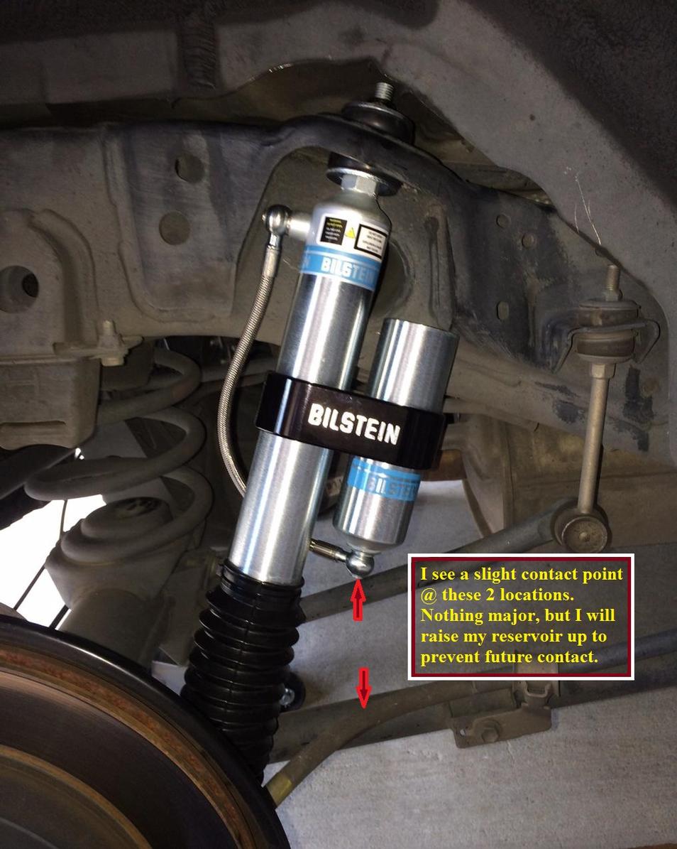

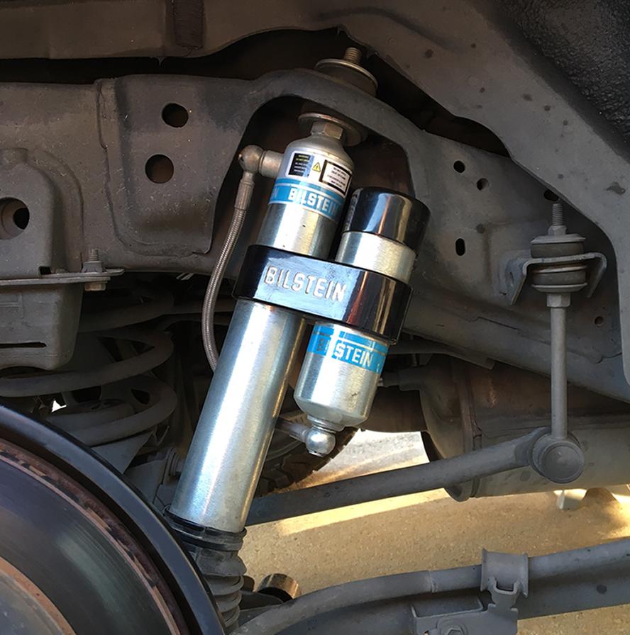

FWIW, I just looked and found the following.
My 5160's have not rotated, still oriented properly.
I did find a slight point of contact between emerg brake line housing and very bottom of both shocks. Nothing major, but it has made contact, so I will adjust accordingly.
See photo depicting locations:
[MENTION=130782]carrera0to60[/MENTION]
[MENTION=77958]Zeusmotorworks[/MENTION],
Thanks for the picture. I think you'll be just fine if you raise it up a touch like you said.

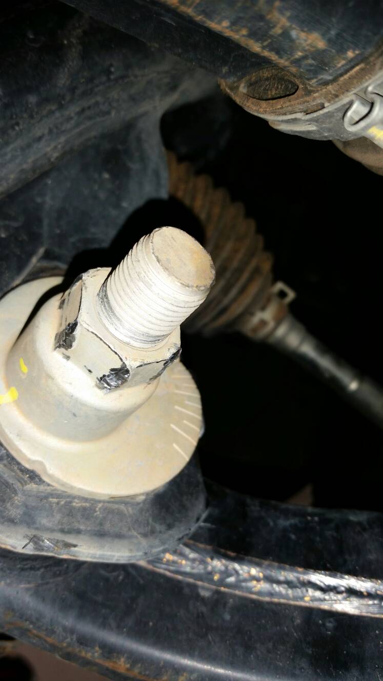

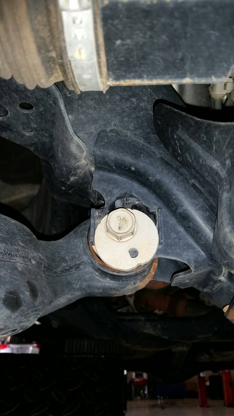

Can't trust anyone these days. Alignment cams were screwed up by the shop, gonna be a fun one trying to get them to pay for damages. uploadfromtaptalk1456541313737.jpguploadfromtaptalk1456541331091.jpg

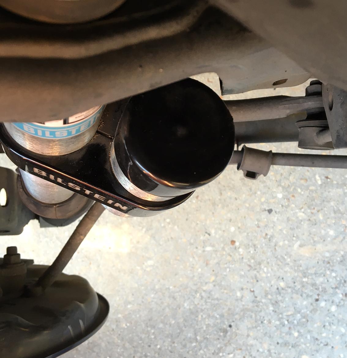

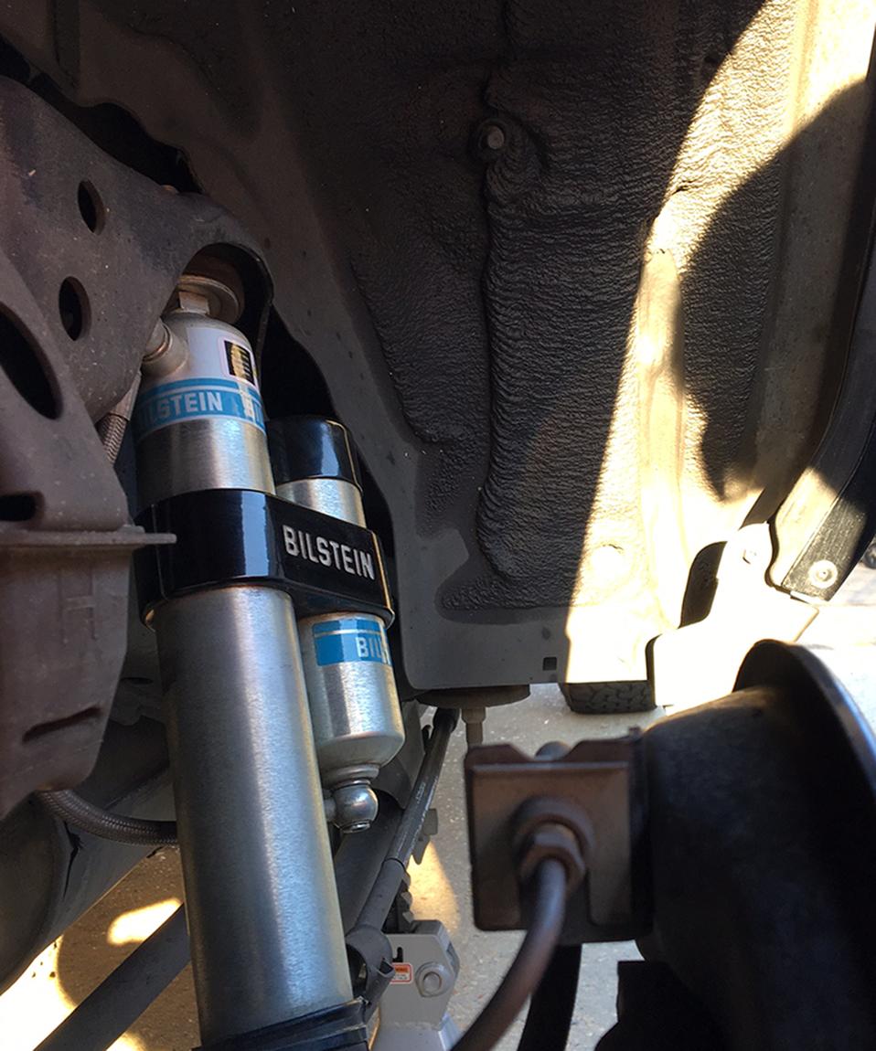

So I did a little relocating of my reservoirs today so they would clear the emergency brake cable housing at full flex without making contact
I moved them up approximately 1.5" and rotated them outward slightly for clearance of the frame.....

Looks like they're just upside-down? I don't see any damage I don't think.
Hard to see but the second pic has the bolt shifted to the right and seems to have crushed the backing plate on the right side. It no longer nests between the two lips. My guys says that it won't stay in alignment until I replace those plates. Don't know much about alignments or their components but made sense the way he explained it to me.
Don't mean to thread jack, last post I promise. I'll go find an appropriate place to post and figure this out.[emoji41]
