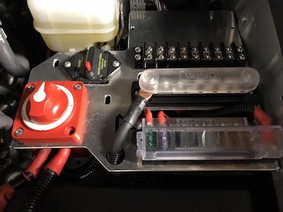

I’ve seen most power switches, like Blue Sea, next to or on top of the battery. I placed mine next to the window washer fluid reservoir. I’ll try to add pics.
Yea I think that would be optimal. I seem to be running low on space in the engine bay though with the additions I have. Shrockworks dual battery with dual odyssey 34's, bandi mount with ARB twin compressor and the smog pump relocated under it, switchpros 9100 on driver side SDHQ mount, and I have a magnuson coming as well.
The only open space left may be right on top of the fuse box on drivers side

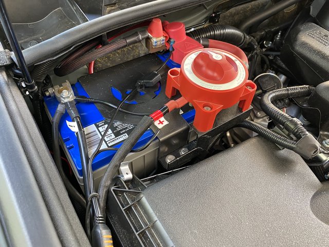

Mounted Blue Sea E-series switch on simple custom bracket mounted on the side of my second box battery on passenger side using the same bolts that secure the top bracket on the battery box for securing the battery. The switch is secured to the bracket using two of the four supports. The other two supports just rest on top of the battery/battery box. Very secure and plenty of hood clearance.
