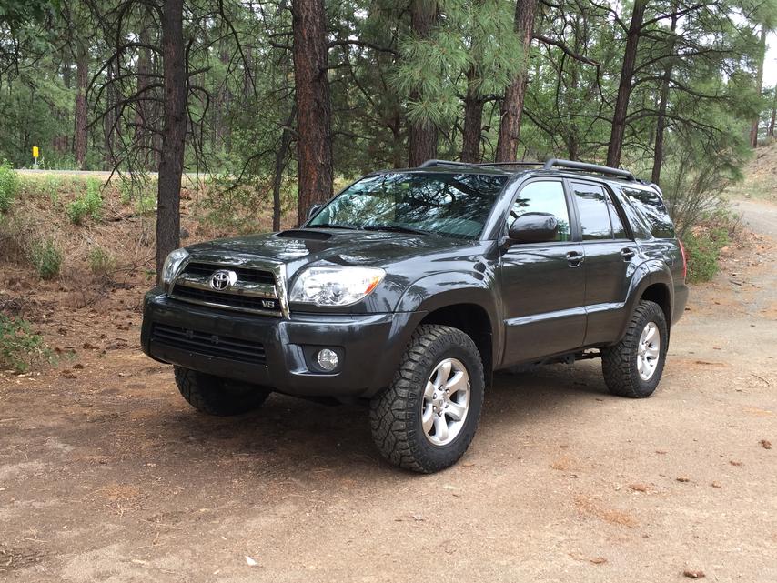

I want to remove my 1.25 inch spidertrax and ready to buy a set of stock trail edition rims. Anyone know which have the better offset for pushing the wheels out? I have the FJ sprintg and Bilstien shocks running 265/70/R17's with the spidertrax which I want gone. Here are pics of the 2 rims I am trying to decide on, please reply with the color of the truck in the pics and a big thanks ahead of time.

Mine is the last truck and just running FJ springs all around with the Bilestien 5100's set to level it out. I trimmed the plastic to fix the rub so curious if I would get more rub and how much difference the offset would be between running the spidertrax as opposed to one of these trail edition rims without the spacers. I like the wheels on the silver truck and the seller said the offset is +15. Any help and advice is appreciated, plan on sticking with my ciurrrnt suspension...

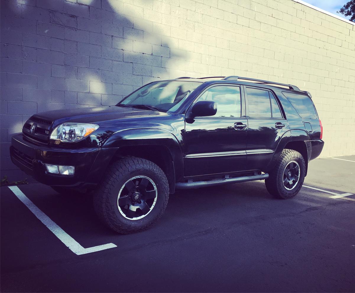

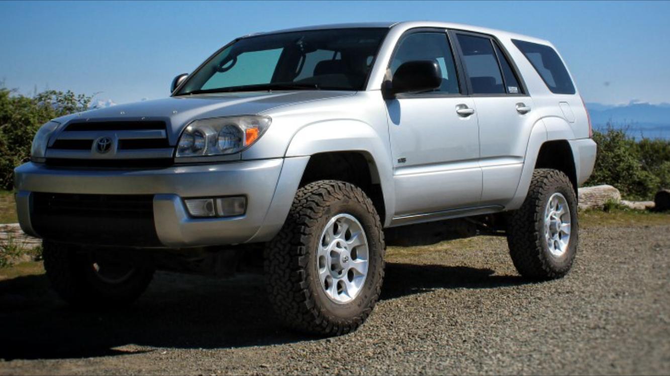

Here is my previous truck with the 2014+ trail wheels, 265/70/17 tires, and no spacers.
Yes, both of those TE wheels have 4.5" of backspacing vs. 5.25" that the sport edition wheels have. However, the TRD PRO wheels have 4" of backspacing which would put the wheel exactly where it is with your current setup. I run the later TE wheels on my 4th gen with 255/80/17 ST Maxx and I'm happy with it. I may switch to TRDP wheels at some point though.

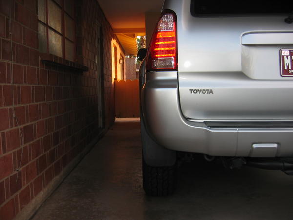

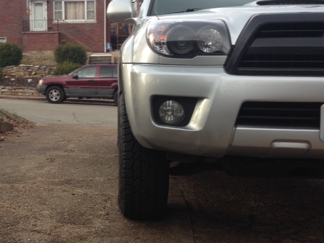

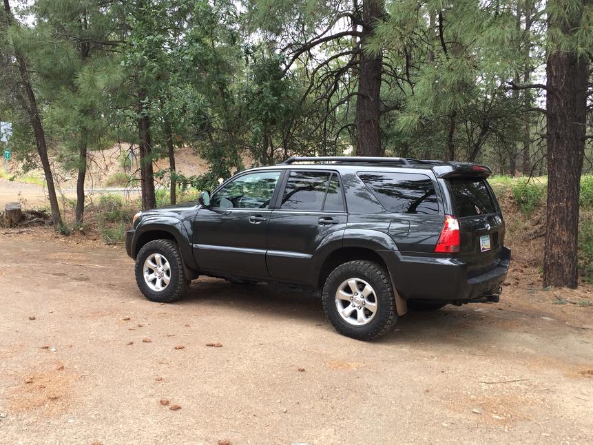

I'm running FJ wheels, 15mm offset gives 0.6" over stock. Here's what that 15mm offset looks like. Not quite flush, but close.

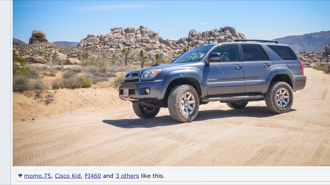

Sorry, I'm running the FJ wheels, but identical specs to the TE wheels.
(17*7.5, +15mm)

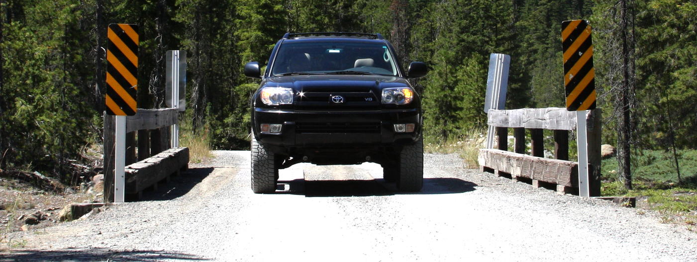

I like the FN fx pro wheels. The offset makes the wheels stick out a fraction more than spydertrax.
