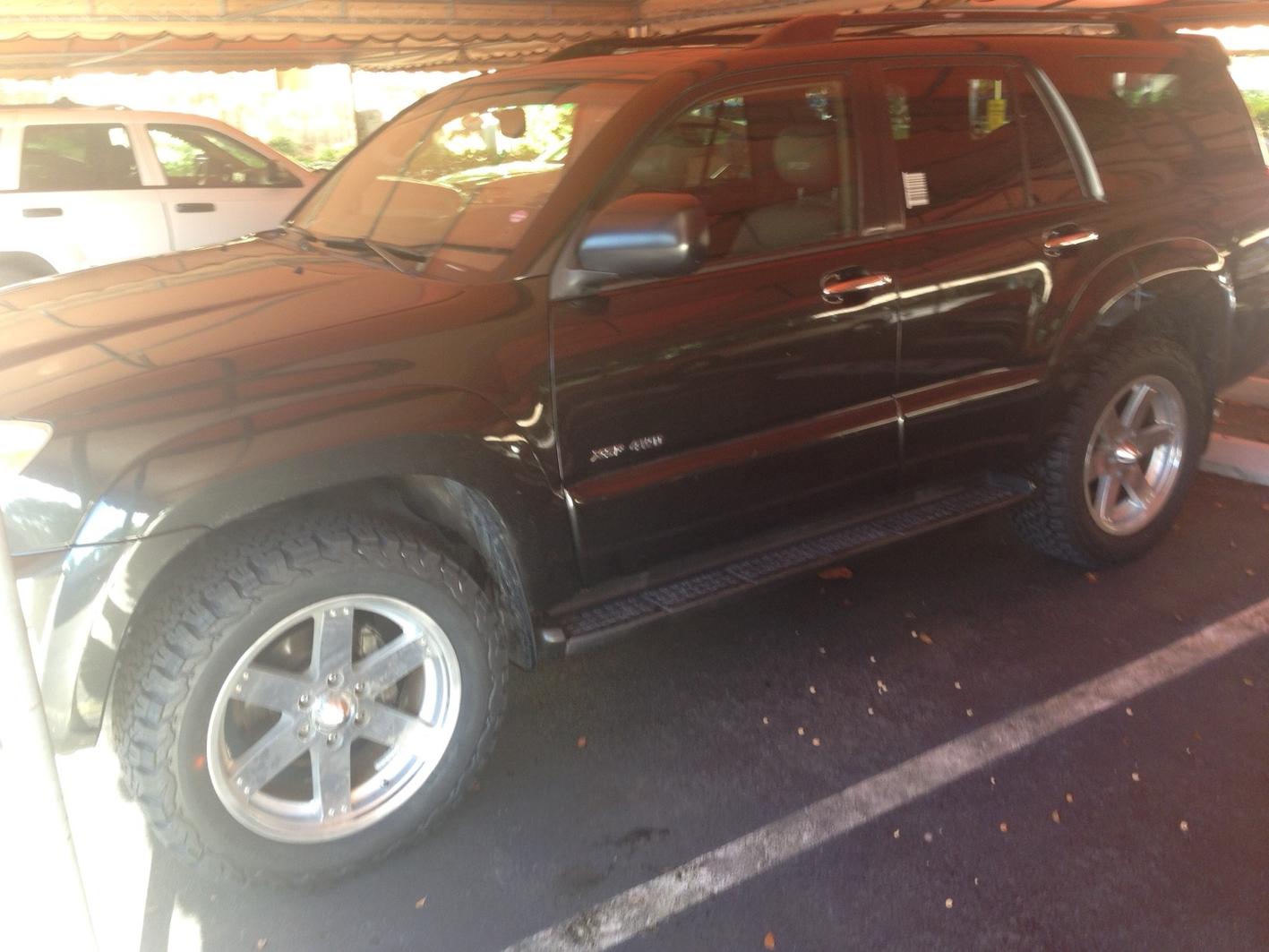

One other set of factory wheels that nobody has mentioned that give a nice offset (8.5" width with 15mm offset) is the XSP wheels. I'm selling a set, see sig. They will sit almost identical to the outer fender as a stock 17x7.5 sport wheel with 1.25" spacer (within 4mm).
For reference, here is a pic of another member's car with these wheels and 275/55/20 KO2 all-terrains:
