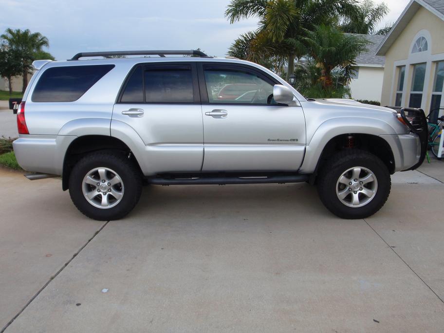

I just installed the Toytec 3" unltimate lift all by myself and it only took 7 hours and I have never installed a lift before. Here is a picture of my new lift.:D I ordered it right from Toytec and it came out to just under $1300 for the lift and shipping..

That looks really really good
