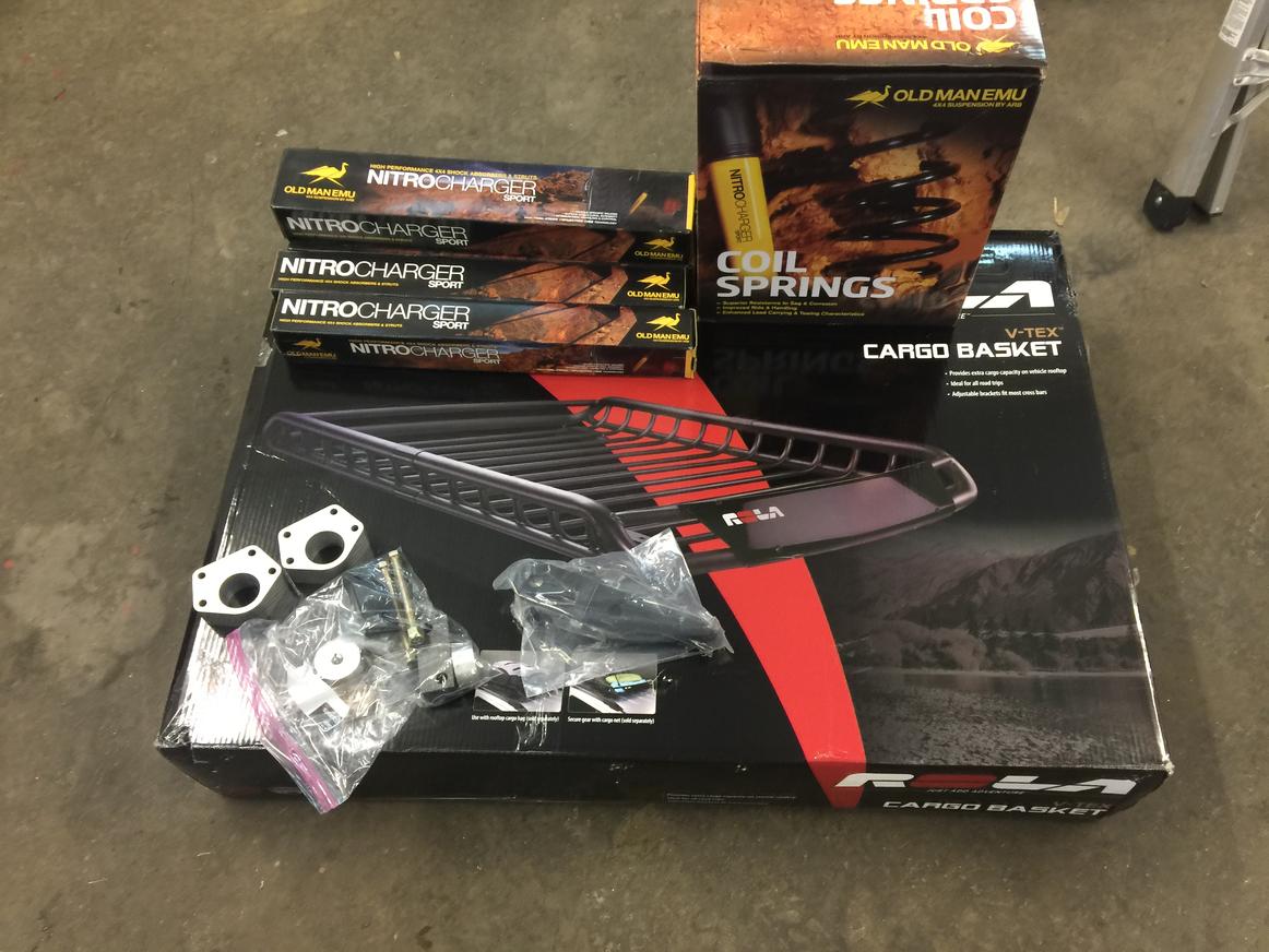

Thanks. The lift i chose is 4crawler bj spacers in the front and ome coils in the rear with ome shocks all around including ome steering stabilizer. The intake changed the sound quite a bit but didn’t really notice any power gains or fuel consumption changes. The bumper is a trail gear. It’s good quality and lined right up. The holes on the side frame mounts are quite large as I think they make them that way for alignment as every vehicle will be slightly different but nothing some small spacers don’t fix.

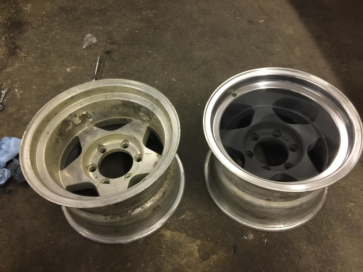

Pretty minimal thing but if anyone cares to see this is a before and after of the wheels I got off Craigslist. I degreased, then wet sanded with 2500 grit, polished the lips with mother mag polish, masked and painted the centers with self etch primer and then flat black engine enamel. Came out decent although the lips could use more polish. Was thinking of doing the lip flat black and the centers dark bronze but haven’t decided if I’m up for the change

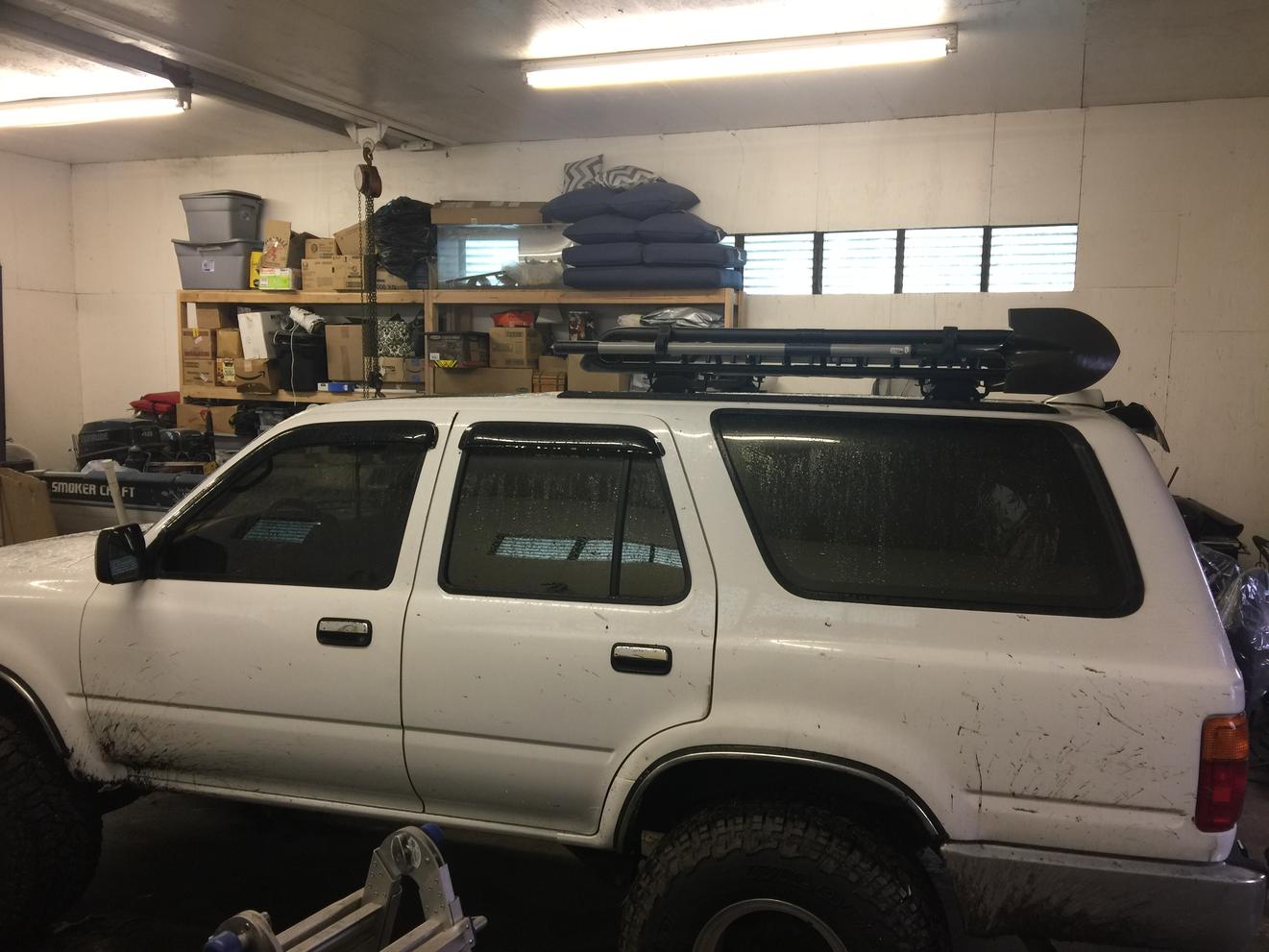

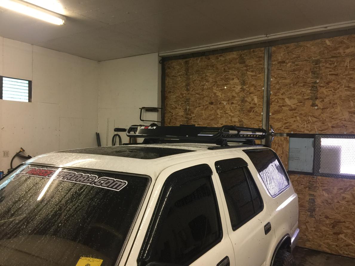

One more shot of the rack. Now on to the lift install. Of course it snowed last night and my rig is wet and dripping from everywhere so what better time to climb underneath it

Thanks. Yeah it took me quite awhile to get around to it myself but I’m glad I did. It looks much cleaner and gives the illusion that it sits taller than it really does
Plans to take off the chrome wheel trim? Rust can hide and usually where the cancer starts.
Love the roof rack/shovel mount, looking forward to seeing the lift!

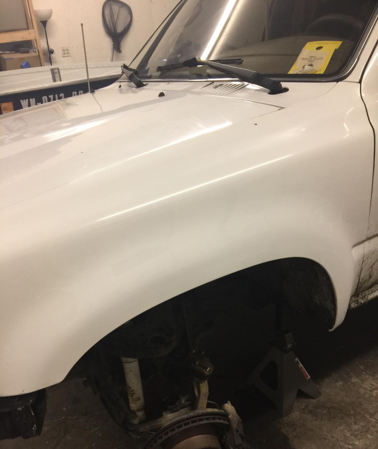

Well not much of an update as this is all I got done when I got home but I removed one of my wheel trim pieces. Hopefully get the lift done tomorrow but we will see

mine came off just fine, i don't remember there being any expose holes in the body
I would like to remove the trim but haven’t looked to see if I’m going to have exposed holes in the body. I know there are screws inside the wheel well but is there more stuff attaching them? Maybe I’ll look when I get home if I don’t get a response by then
No holes in the body, but you may find paint starting to wear from grit, or worse rust. Better to have it off and see then it spreading unknown.
Unless you have a small screw driver you might have to get your wheel off to get access to the Phillips screws.
