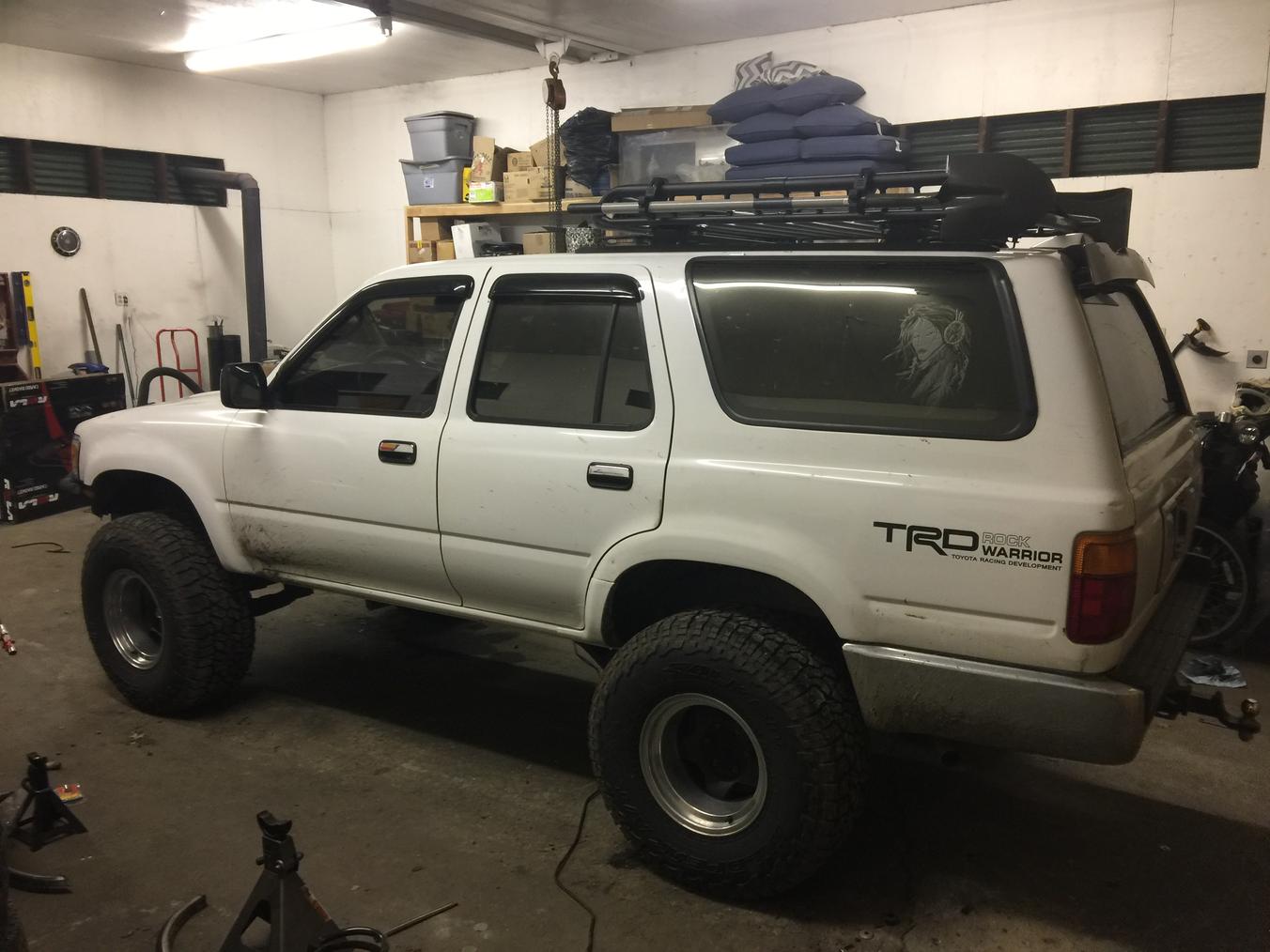

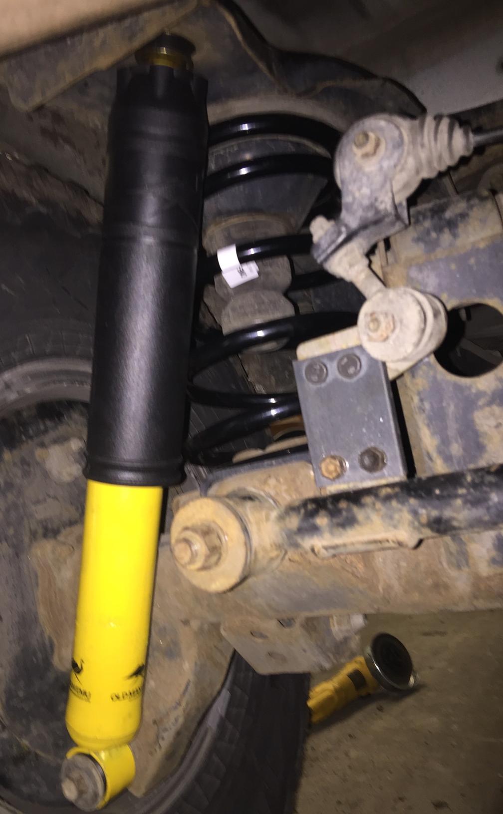

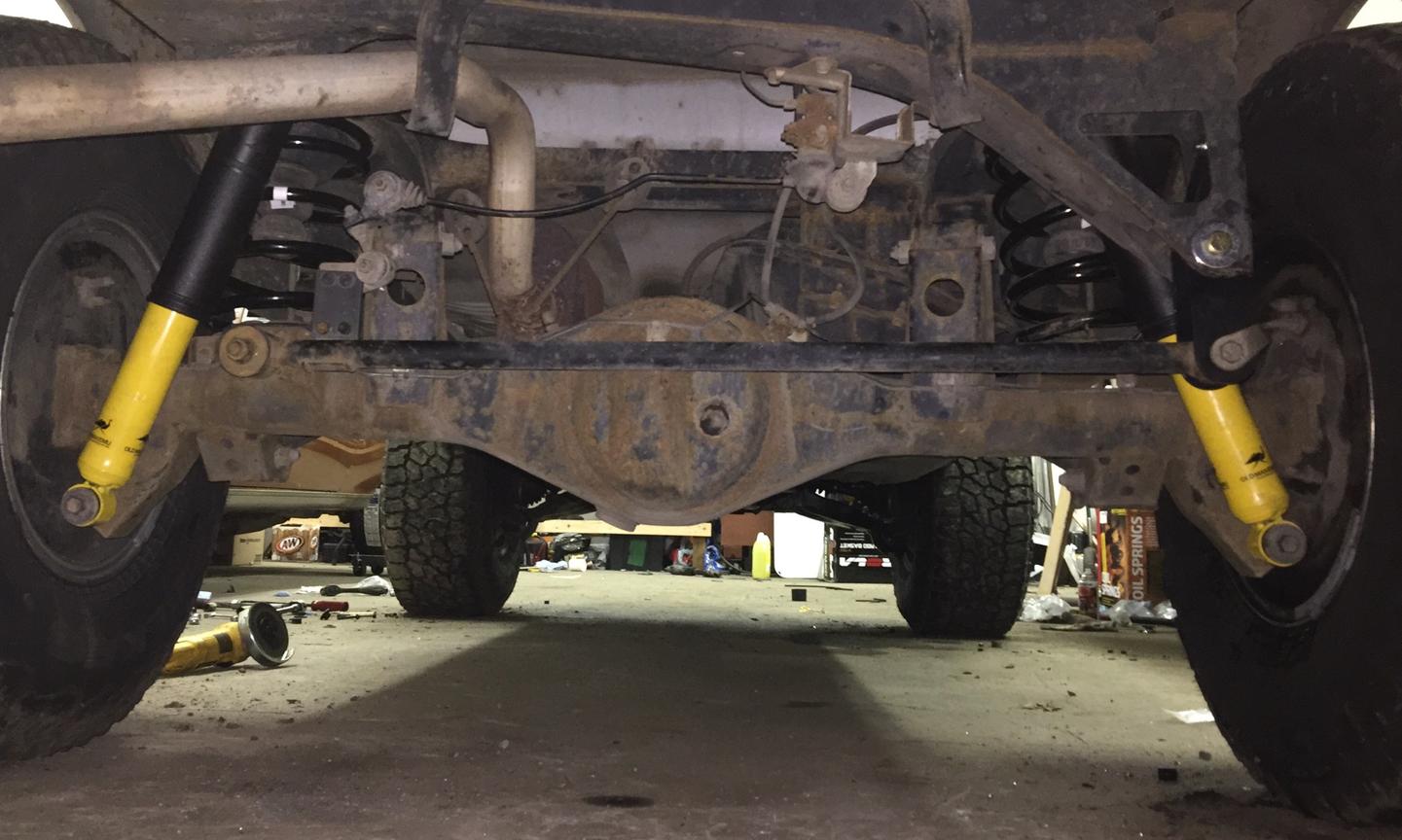

I went with the ome 900 coils in the rear. I considered the 901s but didn't want it to be too stiff as it's mainly a daily driver. Seems from what I read I would have probably been fine either way. Anyway the springs and shocks are on in the back as well as the panhard drop bracket. Going to build a bracket to raise the brake proportioning valve linkage deal ( don't know the proper name and too lazy to look right now). Spacers and shocks are in up front with new upper ball joints. Still need to install the sway bar drops and diff drop tomorrow then get an alignment and it should be all wrapped up. Haven't taken it outside yet but here's a couple quick shots. Front looks a touch higher but measuring from the floor to the pinch weld the rear measures 1/8 higher but if the front still looks higher after things settle I will relax the torsion bars a hair. Rear bumper may find its way off tomorrow too if I find time. Still need to get materials to build the new rear.

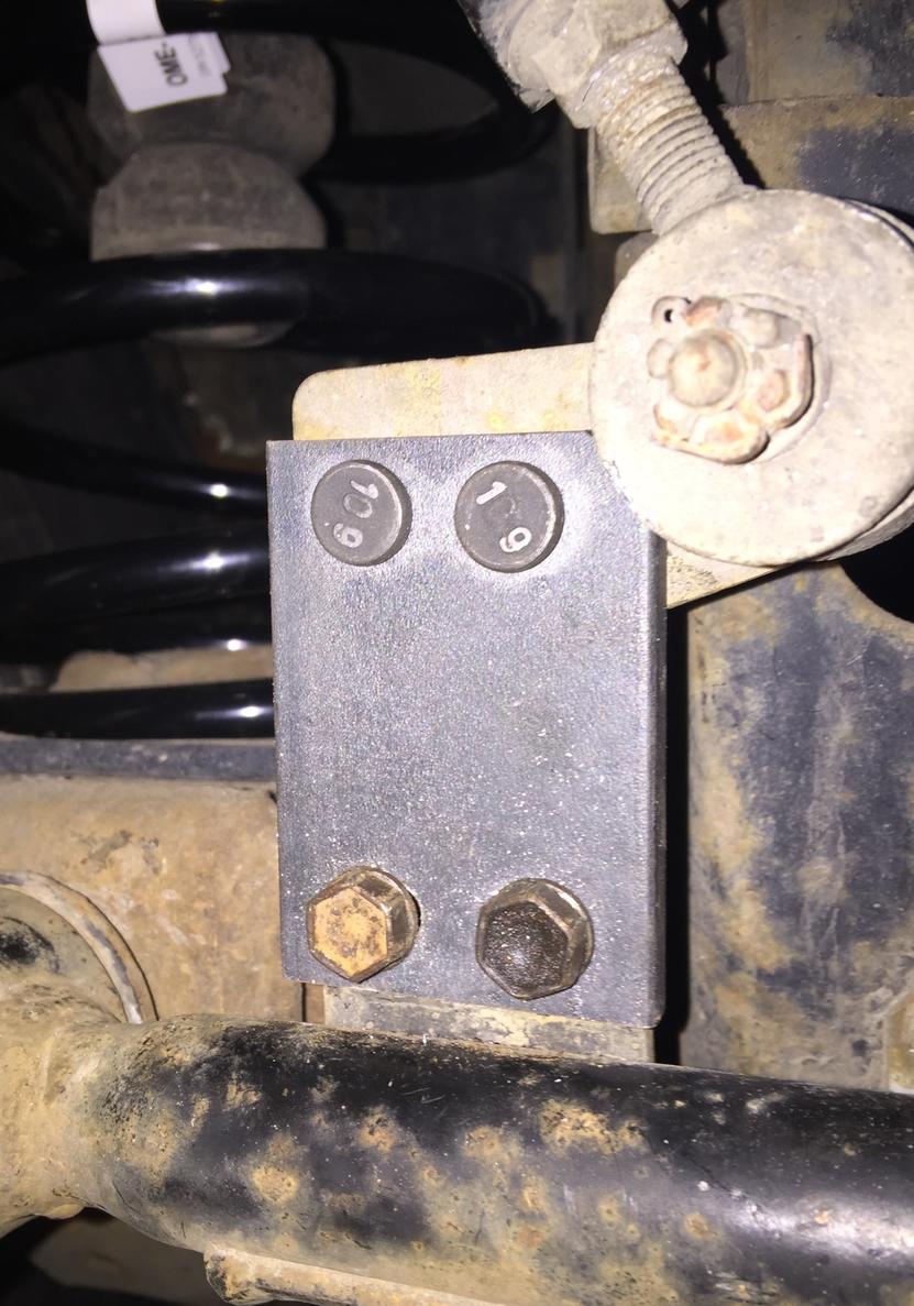

Well I wrapped up the loose ends tonight. Sway bar drops and diff drops are in and fabricated a new bracket to raise the brake proportioning linkage deal. Used a piece of 2 inch flat bar with some bolts in the bottom and the press in studs that came with the new ball joints on the top. Bring it to get aligned tomorrow and it should be all done.
First picture is the bracket I made
Second is the new spring shock and the bracket
Last photo shows it all as a whole. Panhard angle seems good with the drop bracket so it should be good to go...I think lol

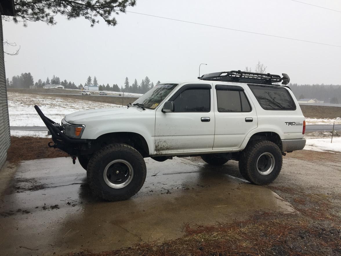

A quick shot of it outside. Didn’t get the alignment done today but rolled it outside to clean up the shop.

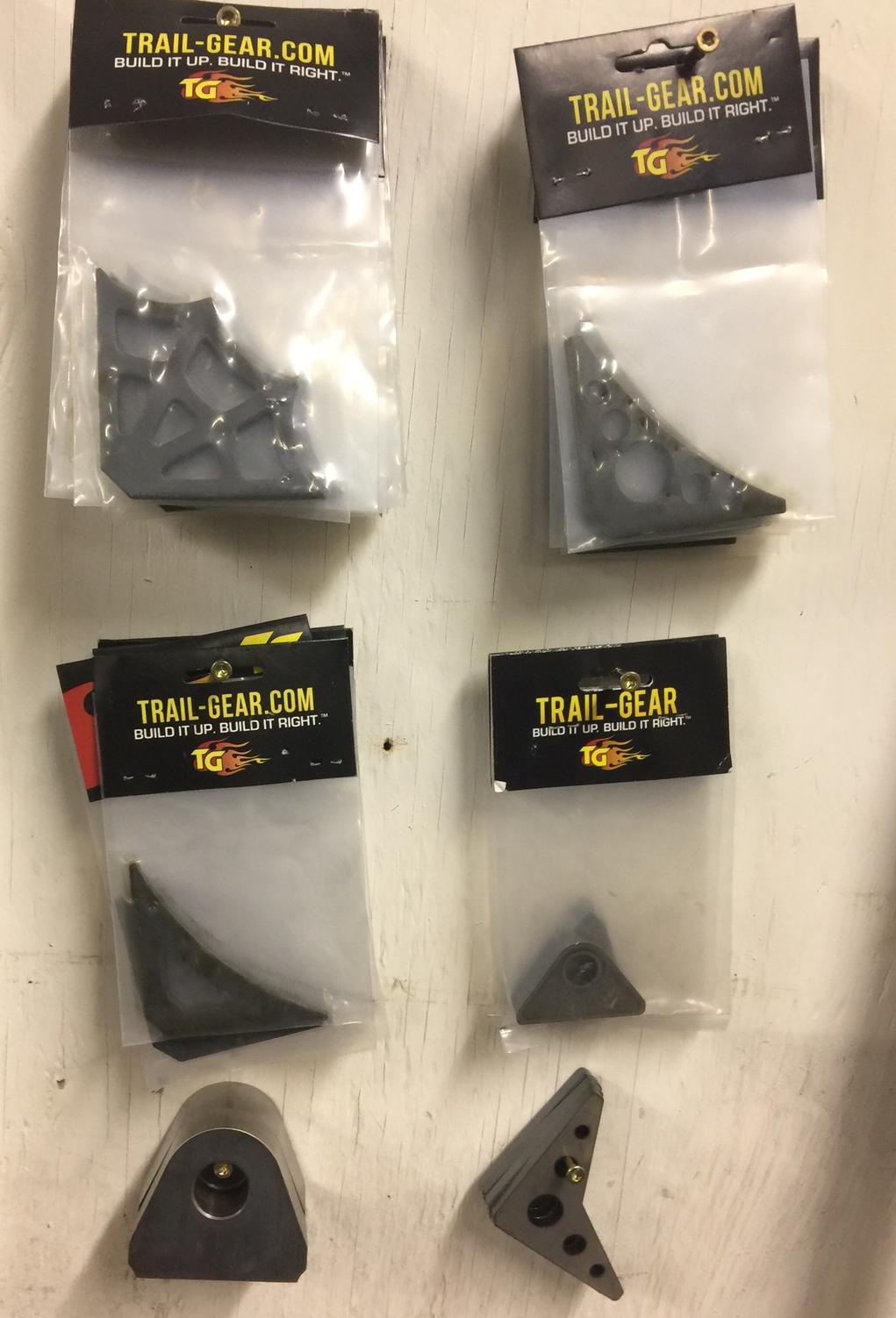

Got my bumper and other stuff building supplies to start on my bumper. May have gotten a little gusset happy but I’ll eventually find a use for them all

Well after pricing metal and coming up with a build plan and totaling up weight for the rear bumper I’m wishing I would have went with the 901 coils. I’m around 100 pounds on just metal. Then I have a full size spare and fuel/water cans and possibly a hi lift. I feel like I’m going to be right back to a squatting rear. I guess after I build it if it does squat I will either swap to 901s or maybe add 4crawler spacers depending on how bad it is. Tip of the day... plan ahead!

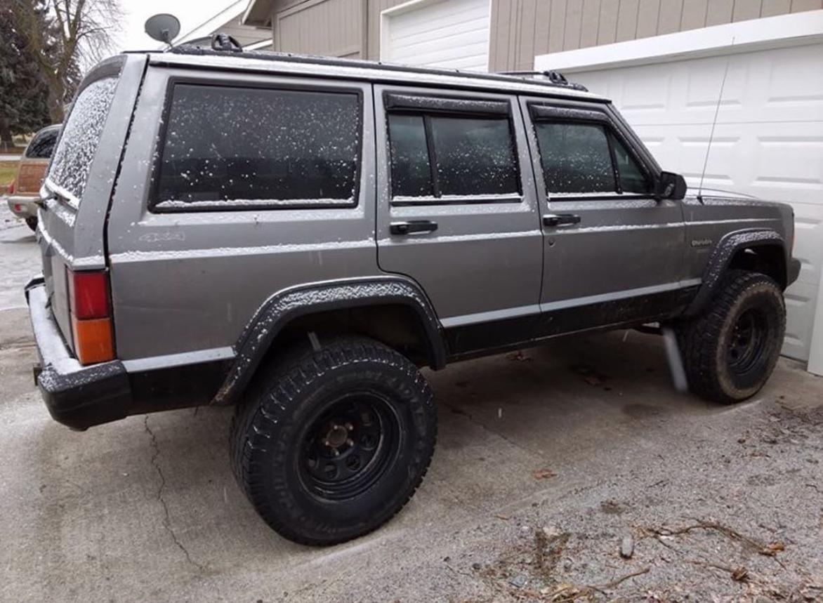

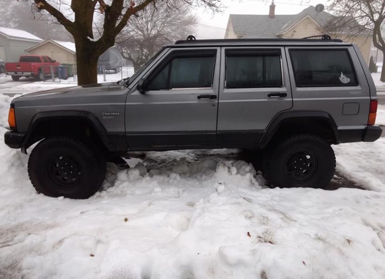

Going to start on my bumper build in the next few days but picked up a 94 xj for the girlfriend today and have some things to do to it as well. Couple pics of it. Overall it's in pretty decent shape but has a knock/tap when warm so that's first priority. Also a valve cover leak but not bad for $1200 and I drove it home. 4wd works good and runs down the road straight and pretty smooth for the lift and it's age. I wouldn't trade my runner for anything but I've always loved the xj's.

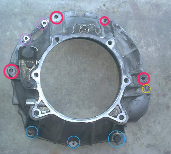

When you put an engine in it is a great idea to install and tighten ALL of the bell housing bolts! Below is a picture of an aw4 bellhousing
The blue circled holes are simply inspection cover mounting holes
Yellow is a starter hole
Purple are for bracket to hold cps
And the red are actual bell housing to engine holes
Out of those 4 red circled holes the 9 o'clock and 3 o'clock bolts were non existent and the 11 o'clock was started but less than finger tight. I haven't reached the 1 o'clock yet but it's safe to say my hopes are not high.
For the sake of who ever may purchase your vehicle (and/or) you/your safety please do things properly. Anyways that's the end of my rant.

My bellhousing bolts were loose and 2 were missing on my 3rd gen. Even missing one of the clutch slave cylinder bolts. Transmission mount wasn't even bolted to the crossmember. Wiring harness was also cut and butt connected back together next to all the plugs
It's work like that that makes you feel the need to go through everything on the vehicle before even driving it really. Which I tend to do on a new rig anyways but it really puts a damper on your mood toward what else your going to find. By the way the last bell housing was about half way out.

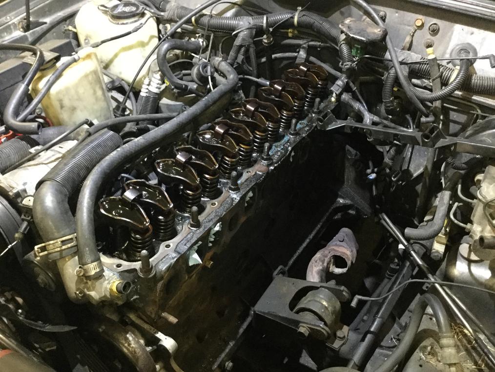

Well I'm in the process of scraping rtv to replace valve cover gasket and replacing broken exhaust manifold until the junkyard opens so I can go grab a couple interior trim pieces and odds and ends. Also hopefully my 12mm ratcheting wrench I left under a rig the other day if it's still there
Well after spending the day putting in new gaskets and replacing the exhaust manifold on the Xj as well as getting all the bellhousing bolts in and tightened down there is no more engine leaks, no extremely loud exhaust leak and the “engine knock” is officially gone. Thing runs like a top and has a hell of a lot more power than the old runner... and that’s just not going to work. Can’t have the girlfriends rig faster than mine. I need to get this engine swap underway. Her grandfather has a freshly rebuilt 351w that he can’t take with him to the east coast when he moves in the summer and said I can have it for $400 so I may see about going that route. Also now that my shop has room I can go get steel and start my bumper :) well I guess I still have to do a uloint and replace the transfer case output shaft seal but that’s about it
