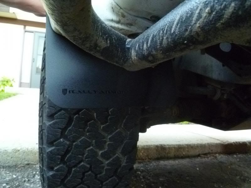

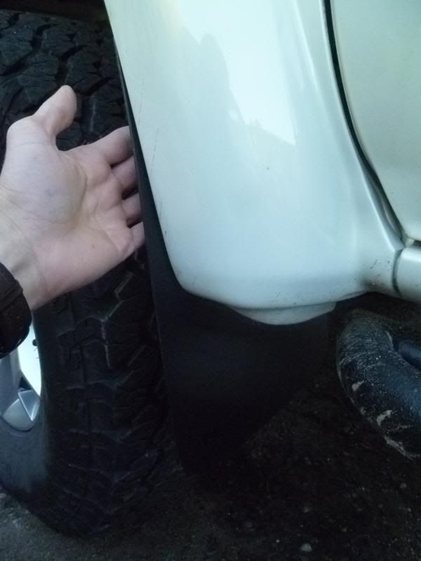

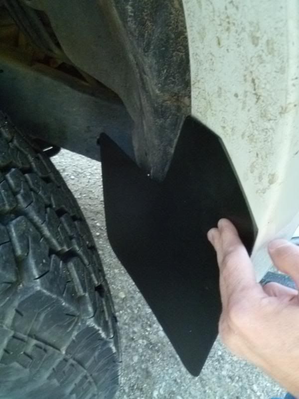

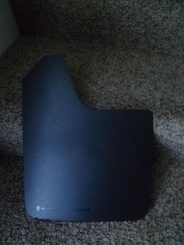

I think that they look good and will keep a lot of crud off the sides of your 4Runner. Those might be a good option for us 4th Gen guys who have either had to trim a lot of the front flaps off or remove them all together. Is there's specific part number for those?
