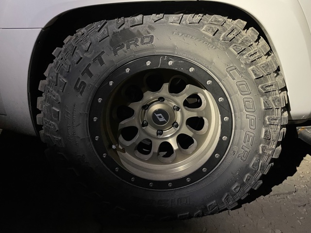

Thanks for sharing the info. I have King/Icon 2in rear lift in the back running 295/70/17 Cooper MTs with the -38 offset. When rear wheels are tucked, they are rubbing against the rear doors. My next step was to get the wheelers offroad superbumps. Did you add 1/4" or 3/8" washer? Hoping this will help with the rubbing.
