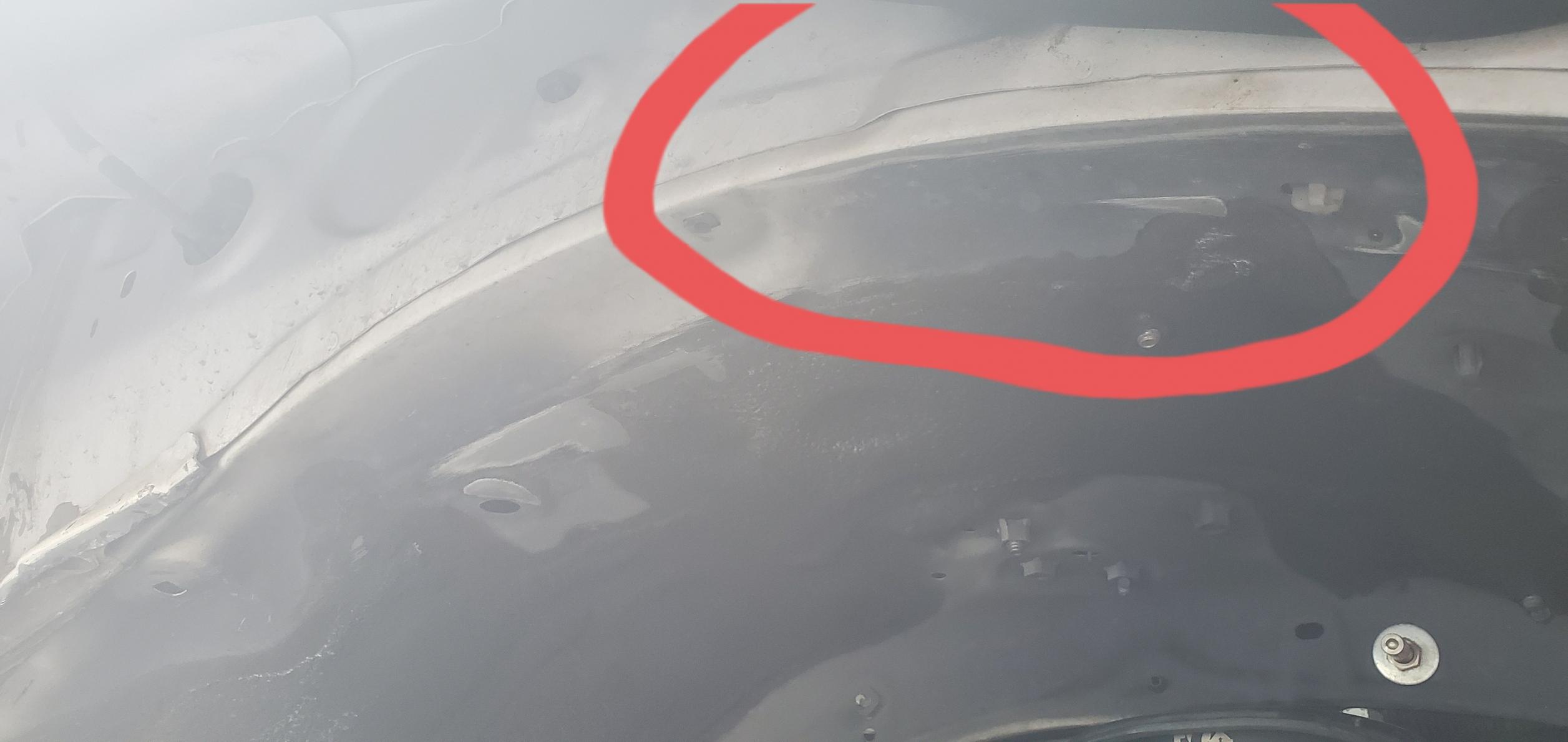

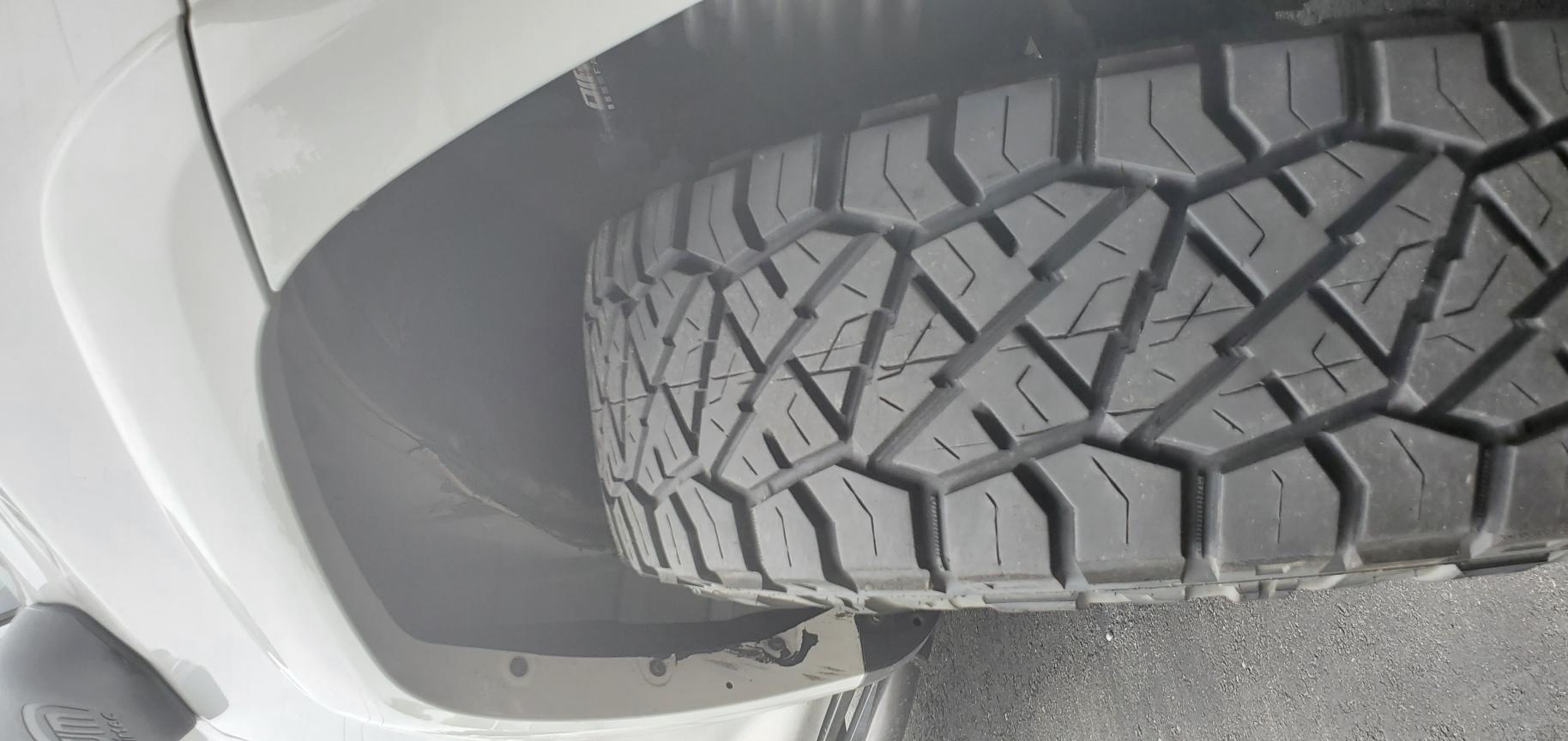

34s without extended bumpstops will result in this offroading. Red circled part is suppose to be flat. Pinch welds need to be hammered flush also

Longv, What suspension and lift were you running when your 34 slammed up inside the the wheel well and created the dent? What extended bump stops are you going to put on?
Can you tell us more about your setup? Namely suspension, control arms, and caster setting. I'm also curious. I haven't had any of those issues with 34's. I'm not racing competitively, but I've pushed it fairly hard and haven't found any issues with rubbing or contact in the front (outside of the normal mud flap and BMC that were necessary to fit).
My setup is stock LCA (with KDSS), stock bump stops, stock wheels sometimes with 1" spacers, sometimes without, Fox 2.5" front coilovers, and JBA UCAs. I set my caster pretty high - around 4.5 - and I'm set at around 2" lift height, but I've gone everywhere from 1-3" height over the years.
I do actually get some minor rub on the inner fender liner in the rear in the whoops at speed if I push it. But nothing up front.
