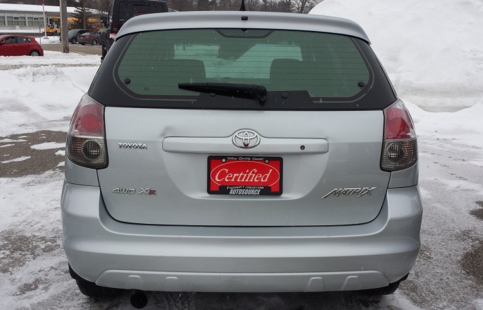

"Full Time 4WD" is a term that exists only in Toyota marketing materials...it's AWD for Toyota's. Here's a pic of a Matrix 4WD so anyone with some spare time can explain how it's not AWD...
More semantics. The Toyota Matrix is AWD (even though it says 4WD on the emblem). 2009 Honda CRV had a sticker that said "AWD". 2010 Honda CRV had an emblem that said "4WD". It was the same exact system, honda just decided to change what they call it. Semantics.
To me, AWD is for crossovers (Honda CRV, Toyota Rav4, Matrix, Highlander, etc.). 4WD means you have a transfer case and a 4LO option. That's why I think the 4runner Limited is 4WD and not AWD. (Even though all wheels are driven at all times) :peep:
