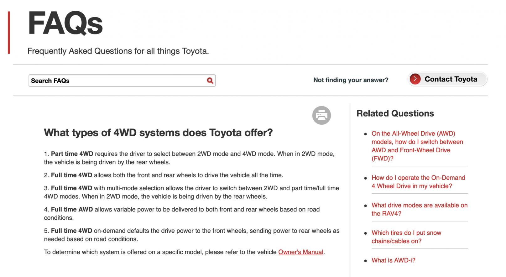

Here, I'm sure this Toyota FAQ sheet will clear things up nicely.:behindsofa:

With the CDL locked the 4WD system is exactly the same and operates as part-time 4WD. The difference, is with the CDL off, you can drive using 4WD full-time. The multi-mode on the Sequoia and V6 4th gen 4Runner offers 2wd as well as part of the system. Not sure why Toyota went away from it on the 4Runner.
Things nobody has ever said: "It's getting pretty deep, better put it in part time."
The 5th gen Limited has a full time transfer case, which is fundamentally different than a part time transfer case. There is no "part time mode" on a vehicle that has full time 4WD. There's AWD, and 4x4 when the CDL is locked.
You're just using the terminology wrong, and that's a you problem.:sorry:
I guess Toyota is wrong then. See #3. The multi mode that the 4th gen 4runner V6 and current Sequoia have the same transfer case as the current limited 4Runner with the addition of 2wd.
#3 is FULL TIME 4WD with 2wd, pt 4wd (when CDL is locked) and FT4wd. The current 4runner just got rid of the 2wd option.
According to you this is wrong. Yes, the 4Runner Limited is always in 4wd, but with the CDL locked, you are in part-time mode.
The 4Runner is not AWD. AWD is a completely separate system that does not have a 4L option.
