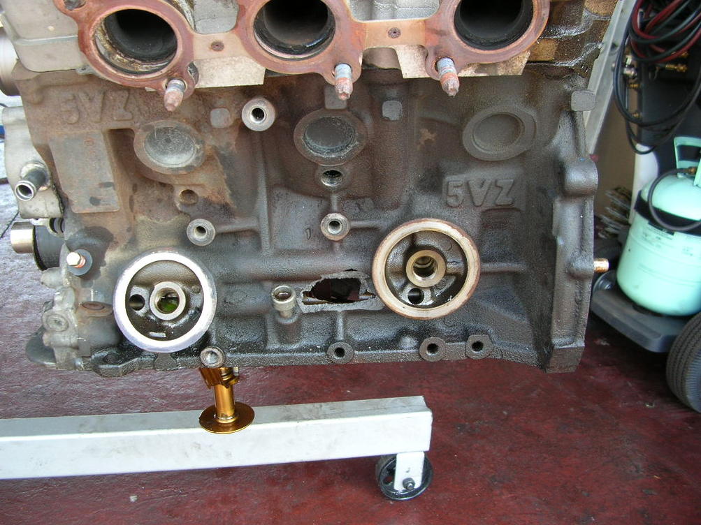

Purchased a used '98 4Runner several years ago. It had 135k on it. Three hundred miles after I bought, (no joke....300 miles), it developed a whine in the engine that would come up about 20 seconds after start up and would continue until shut down. I thought it was a power steering pump or bad belt but I wanted another opinion so I took it to a mechanic I knew and trusted.
He changed the oil and said it looked like it hadn't been changed in quite some time. He even went to the trouble to show me the old filter and oil that came out of it. His exact words were "I have solved lots a problems by changing the oil." Well sure enough the whine disappeared.
He recommended I do several oil changes over the next few miles/months which I did. No problems at all from the engine and whine was gone and stayed gone. Even drove it from TN to TX and back. Best to my memory I got something like 18-20+ miles MPG on the trip.
Followed my mechanic's advice and changed oil 3 times over the next 5k miles. Again, no problems.
Then at 140,040 I got wise and Seafoamed the engine. Did exactly what the can said do, 1 oz. per quart of engine oil (think I got that right). Drove it for 78 miles to 140,118 and then changed oil. Used 5W-30 just as the manual said and Toyota oil filter. Then at 140,171.....63 measly miles later.......it threw a rod (see picture of engine below).
I think Seafoam is a good product and I don't know if it caused my problem or not, but looking back I wish I had followed my friends advice and just changed the oil more frequently. His advice worked for 5,000 miles. 63 miles after Seafoam I was walking.
The money I spend on a remanufactured engine would have paid for a whole bunch of oil changes. Several mechanic have told me the best way to clean an engine out is to just simply keep the oil changed.
I'm not an expert, but I agree with THatfield with what happened to me in my case.
On a similar note, a friend of mine had a Ford 3/4 ton with a V8. It knocked too for what seemed like years. He wanted to fix it, but his mechanic told him not to but to drive it until it died.
It finally did one day. Threw a rod. He was towing a horse trailer that day. Needless to say he was very mad when it happened.
Knocks in engines just aren't good.
[Picture of engine with hole in block is inserted here]
