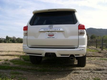

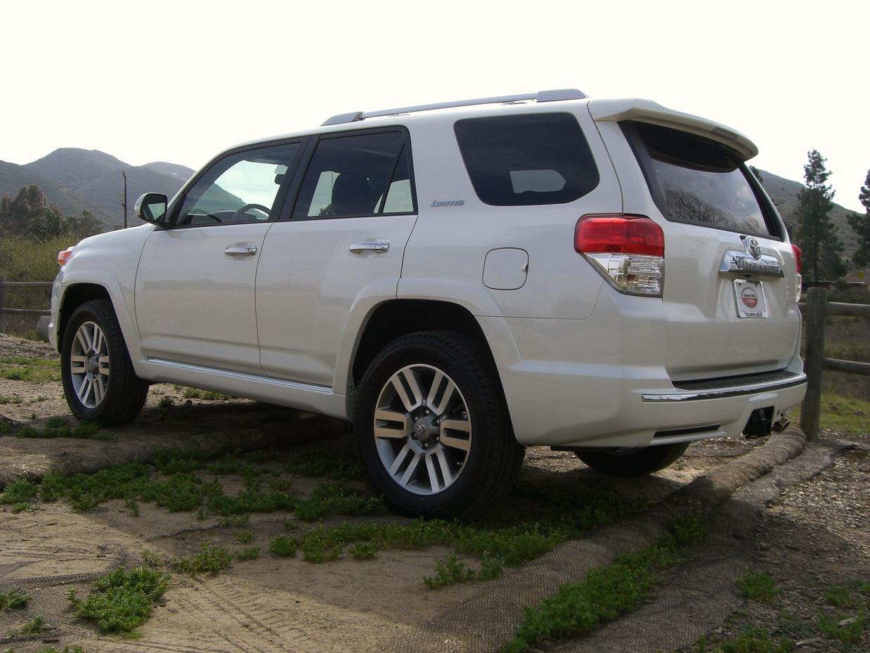

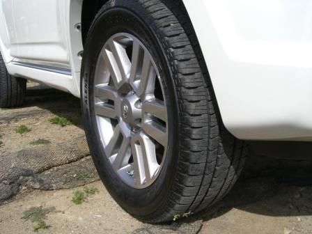

Wider Tires for 2011 LE
Bridgestone Dueler A/T RH-S
here are the specs for tire you chose. the MIN rim width is 7.5 inches for this tire. So you are squeezing a larger tire onto a smaller rim, which is unsafe. not going to get into a spat here, but too many people here have done what you have done and it could potentially lead to a serious accident.
I know i just looked at Bridgestone web site and saw the same thing. I am amazed that people who are supposedly in the "know" such as the dealer and a reputable tire company would install an unapproved tire/wheel combination. Discount Tire looked up my car & on their system and told me yes they would fit. I didn't think I had to double check the manufacturer's web site to verify. Needless to say my local Discount Tire will be getting a visit from me (with a print out of the Bridgestone specs) and they will be replacing my tires free of charge to an approved size hopefully that is wider than the stock ones. Worst case I'll make them re-install my original tires and give me a full refund.

Update
Talked to manager at my local Discount Tire and told him about the tire/rim combination not being compatible. I told him his employee looked up my car/the tire and told me it was compatible but per the mfg tire specs the 275 Bridgestone is not compatible with a 7" rim.
He had the gall to argue with me about it - it's only 1/2" and those mfg specs are "guidelines." I said well why does it say "approved rim size?" He said "I'd gladly put those tires on my car I know they're OK." I told him, "so you know more than the engineers at Bridgestone who spend millions of dollars engineering and testing those tires for safety?" He finally backed down and said he will replace my tires with the Conti's for free. But.... they are out of stock! Of course!
