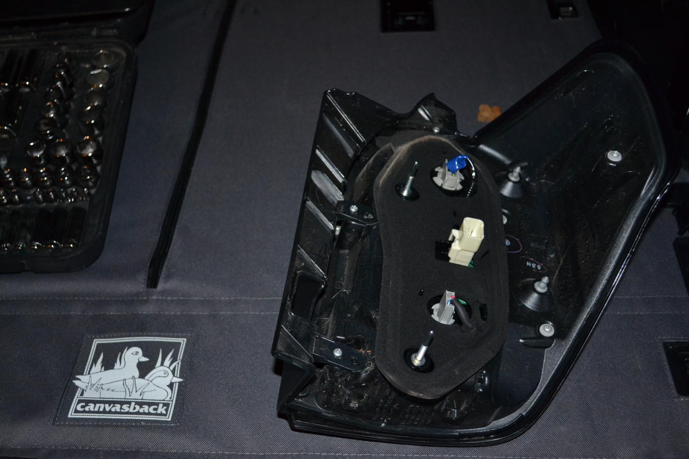

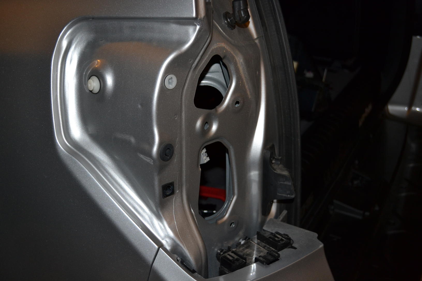

Rear Diff Breather Mod
I've been meaning to do this mod just for peace of mind, but we've been in a sustained drought in CA. El Nino has showed up this year, so definitely time to take care of this.
Kit List:
- 10' Fuel Line Hose, 5/16": $17
- Toyota part 90404-51319 (Union): $10
- Toyota part 90930-03136 (Breather) $5
- Stainless steel hose clamp (x2): $2.50 for 4
- Enough zip ties to hold it all together
- Teflon tape
So for $35, it's definitely nice to be safer. One thing to note is the size line to use. Some say 1/4", 5/16", and 3/8". I bought the 3/8" initially and I was not happy with how easily it slipped on the union and it was very loose on the breather. I took it back and got 5/16" line. You really only need 8', but I used 9' and left slack in the fender for a future lift and more wheel articulation.
I'm not going to document much here because I basically followed [MENTION=65614]Antman[/MENTION] and located the breather in the driver side tail light compartment. Antman Rear Diff Mod Tail light
I also followed [MENTION=129593]MTN4RNR[/MENTION] on his advice routing the line. MTN4RNR Rear Diff Breather Mod
The reason I chose here over the others was:
1) No drilling/cutting required
2) No part of the mod comes inside the rig
3) Taillight is pretty easy to remove (2 nuts, unclip the wire harness, and pull like hell straight back)
Here are a couple of pics of the tail light area. The white clip at the top of the rear fender is what holds it in tight, so you'll want to put your left hand there when you're pulling. You can see the 2 studs on the tail light where you have to remove the nuts. Pretty easy, but nice to have a picture so you know you have everything off before pulling.
I was pretty much finished and about to zip tie the new breather inside the tail light compartment when I dropped it. NOOOOOO! <Expletive Deleted> <Expletive Deleted> <Expletive Deleted>
So what should have been <1 hr turned into 2+ trying to fish it back up with my telescoping magnet. I should have just pulled the fender off, but you know how it gets when you're frustrated...mind doesn't think clearly.
Anyway, super cheap and easy mod that I would recommend tackling when you have some downtime.

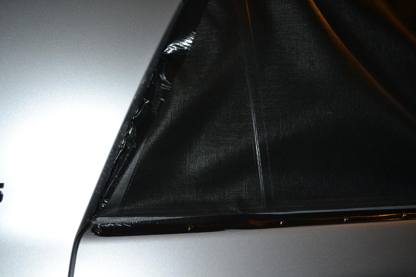

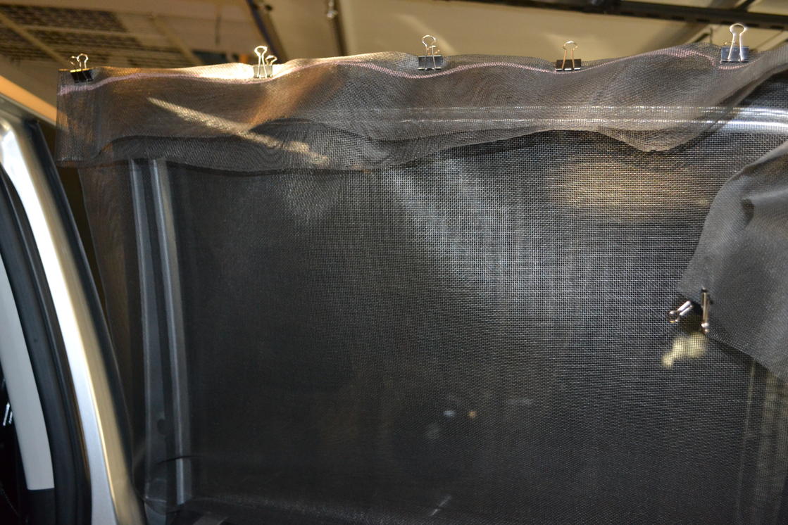

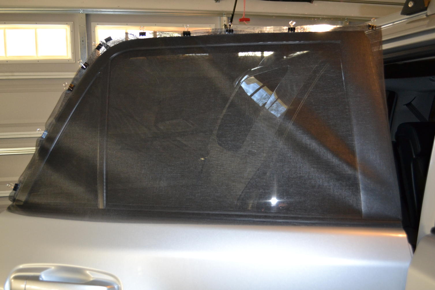

DIY Window Screens / Sox for $6
I did some dispersed camping in Big Sur this past weekend, which was awesome. What wasn't awesome was the mosquitoes. I slept in the back of the 4Runner, which was pretty comfortable. It would have been nice to crack the windows, though. So I started to do some research...and found lots of inspiration.
The first info I came across was a YouTube video by [MENTION=107059]Land_Shark[/MENTION]. (5th Gen Window Screens) Very straightforward and the tape made it easy.
[MENTION=112139]Fenix84[/MENTION] has a really nice write-up using magnets and double biased tape, but I wasn't going to tackle the sewing part. This was a very clean and professional looking approach, and I really liked the idea of the magnets so the solution was self contained. (DIY Window Screens)
I also thought about buying the professionally made ones, but $55 seemed steep. (WindowSox)
I decided to DIY and combine what I thought were the best attributes of all 3 options.
1) I really liked that the window sox slipped over the door/window and provided 2 layers of protection
2) I liked how [MENTION=107059]Land_Shark[/MENTION] taped the edges of his screens
3) I liked sealing the edge of the screen with magnets
Supplies:
- Leftover 24" wide roll fiberglass screen material. ($0 to me, $8 retail)
- Black Scotch Duct Tape ($0 to me, $3 retail)
- Black Gorilla Tape ($0 to me, $5 retail)
- qty 2 10-pack of Rare Earth Magnets from Harbor Freight ($3 each)
My cost was $6 because I already had some of the materials on hand.

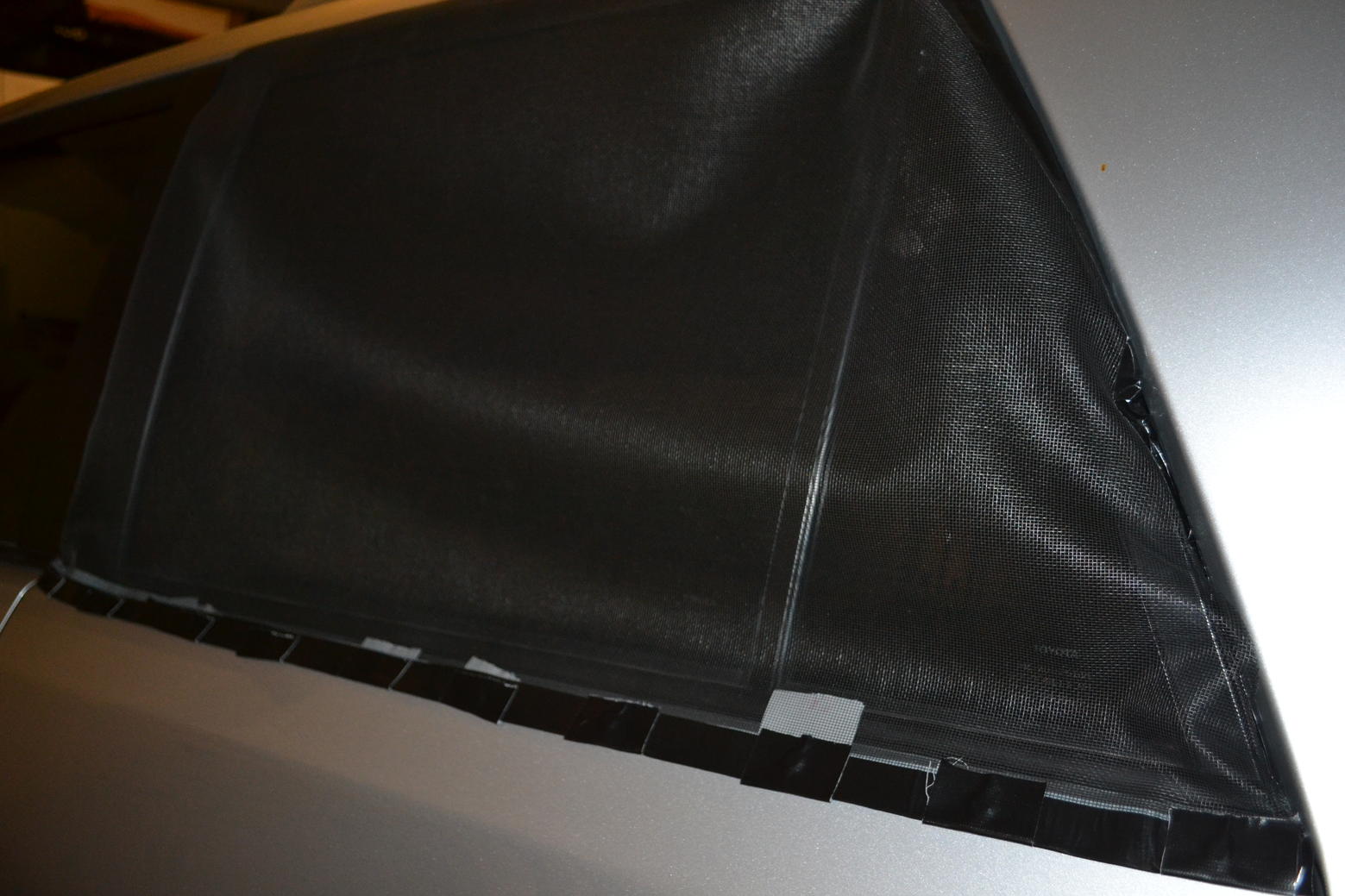

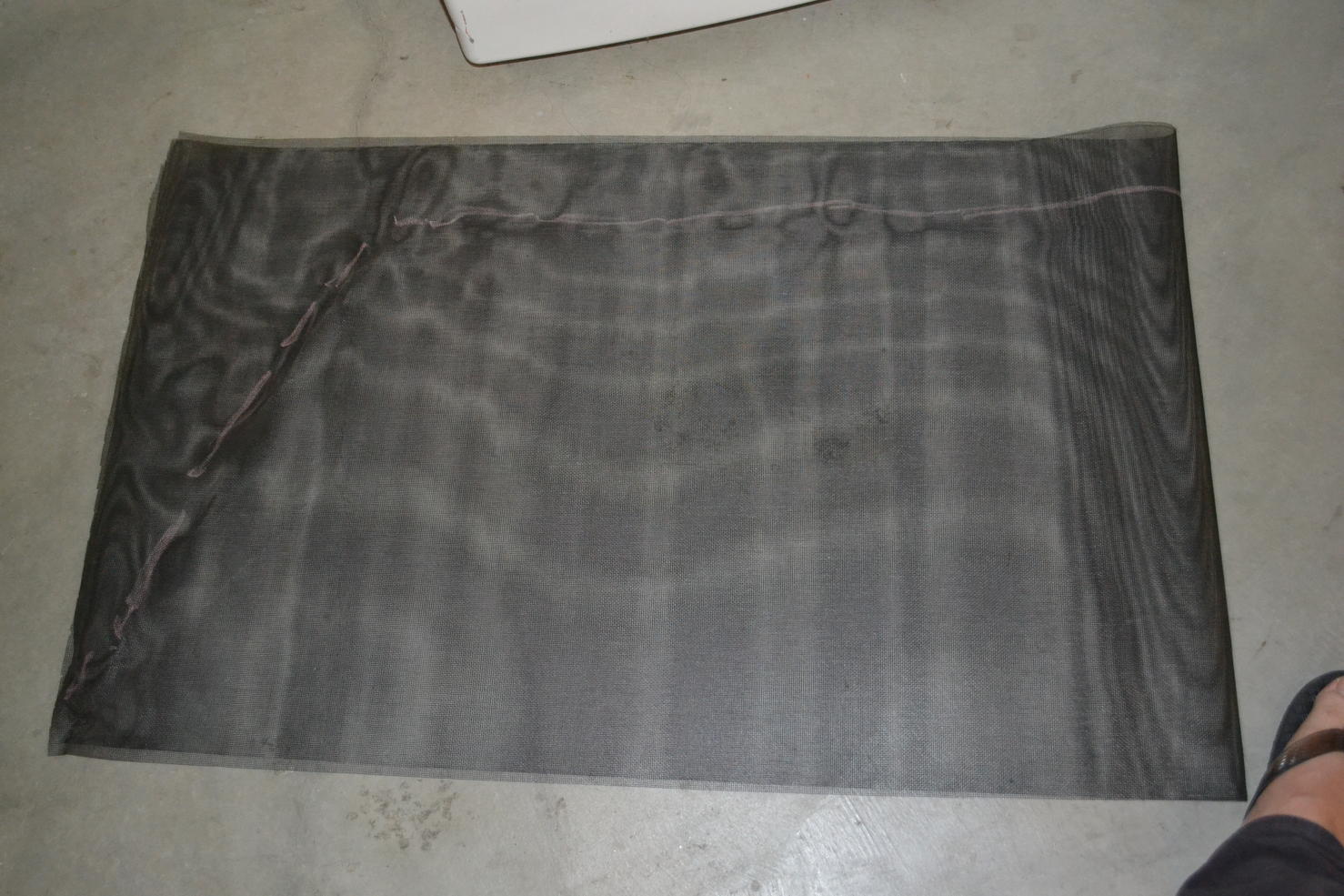

Procedure:
1) Roll out 77"x24" length of screen material
2) Wrap screen around the window and dry fit (note, I wanted the folded part to be on top of the window, but my material wasn't wide enough so I had to wrap around the sides. 6 of one, half dozen of the other)
3) Clamp screen in place using binder clips
4) Use piece of chalk to mark excess areas to trim
5) Trim screen edges along the chalk outline to fit
6) Tape edges using black duct tape, sealing off top and side of the sock, leaving the bottom open to slide over the window
7) Dry fit taped screen on window
8) Place magnets on bottom outside screen edge so they hold the screen against the door
9) Mark desired magnet locations with sharpie
10) Tape magnets in place using Gorilla Tape for extra hold
I'm pretty happy with the way it turned out. The 2nd one definitely came out better than the 1st one. There is some excess material, but for 1 hour of time and $6, this is a totally functional solution. Time will tell how it holds up, but it's an easy repair to fix.

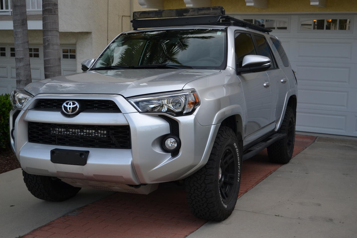

Baja Flat Utility Rack Install
My Baja Flat Utility rack finally arrived from the Tacomaworld group buy! I went with this rack for a few reasons:
1) NO DRILL INSTALL
2) Sits as low as any rack on the market and maximizes my garage clearance
3) Allows me to carry more than just my RTT (Treds for sure, maybe Rotopax in the future)
4) Front and rear light bar tabs already provided
5) Decent price point

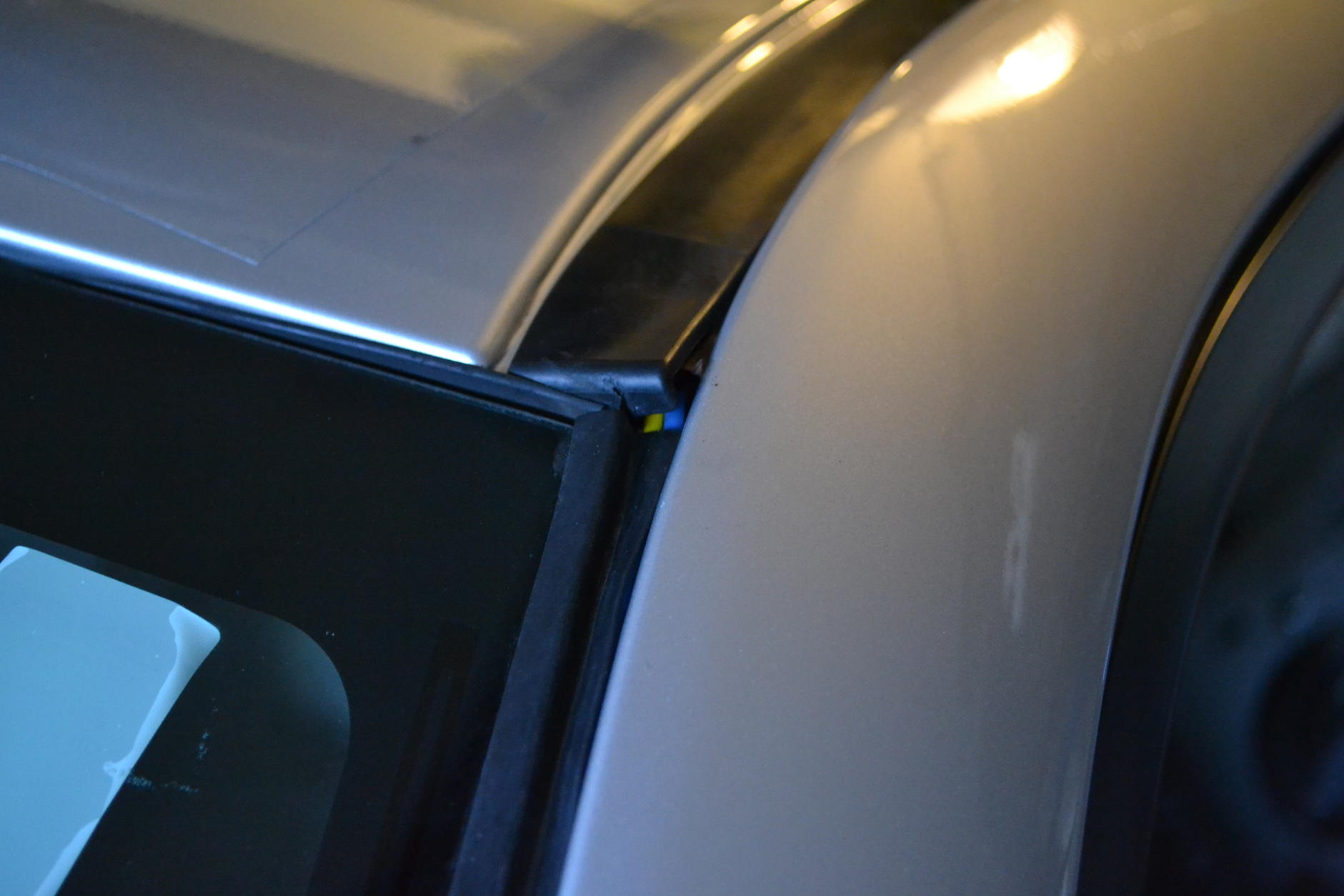

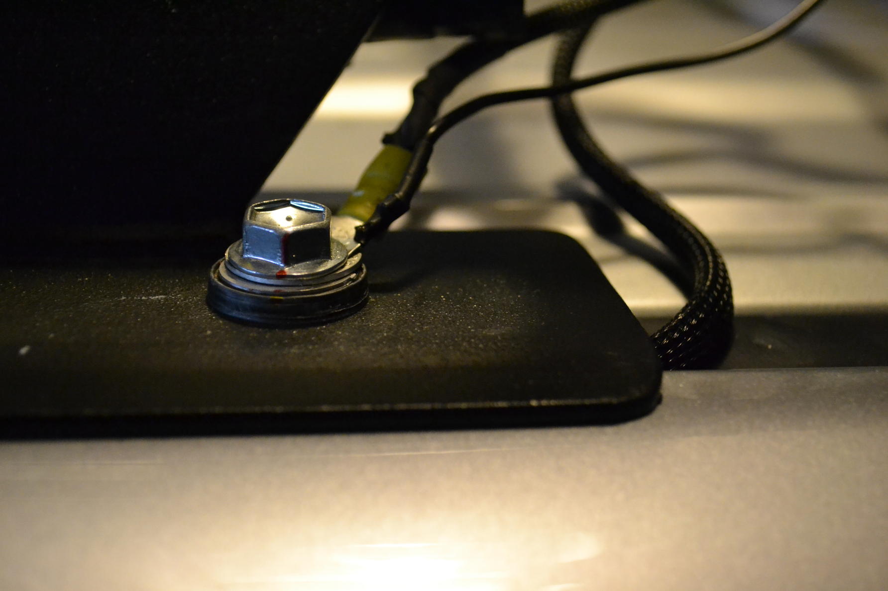

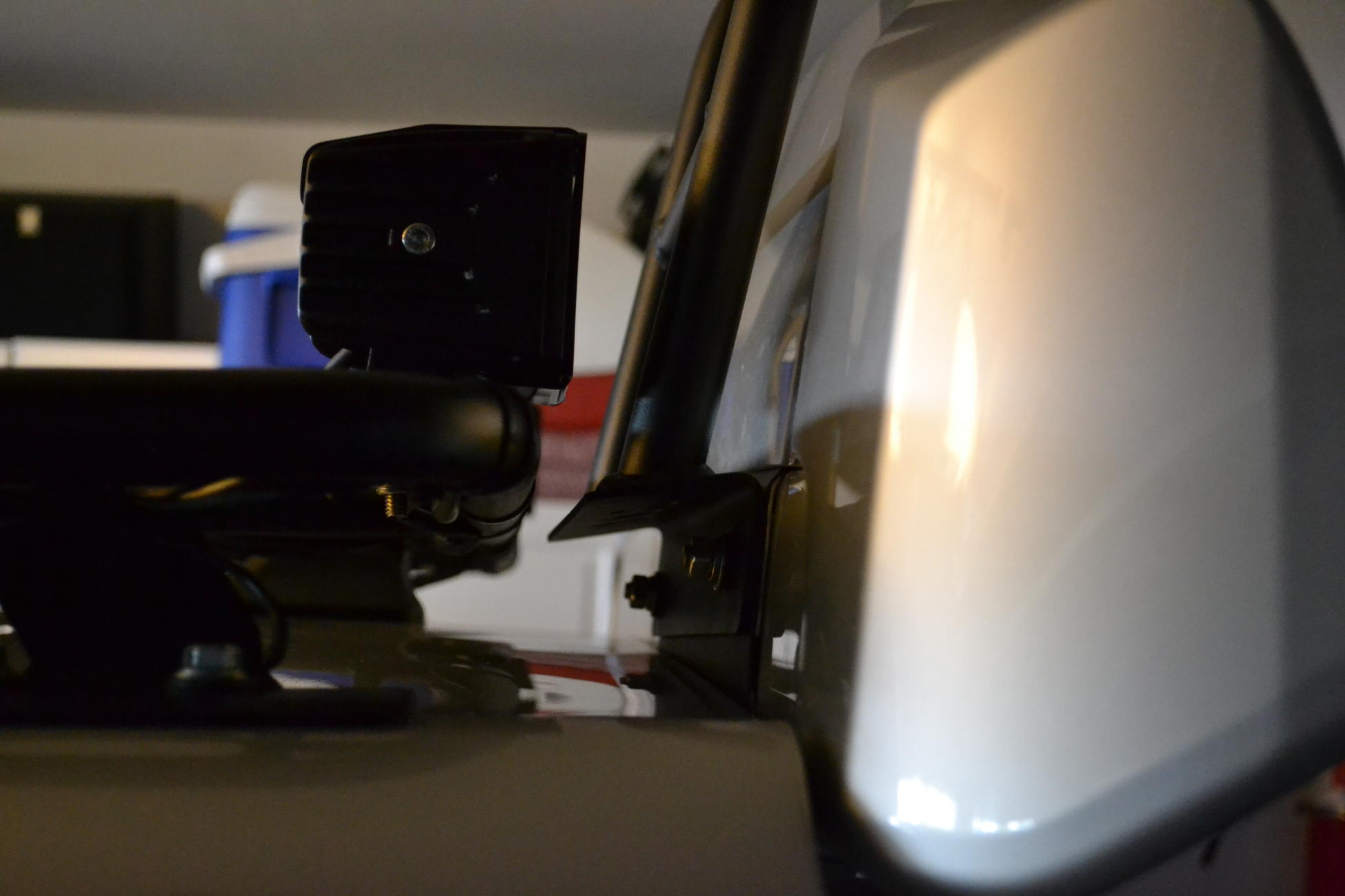

The install directions are very good and installing the rack itself was quite easy. I added a fair amount of time fabbing and painting a bracket for my 40" light bar and running all of the wiring. The bracket that came with my 40" KC Hilites sat too high for my taste. I just used some scrap 1/4" aluminum angle bracket and measured/drilled 4 holes. Piece of cake.
I ran (2) 14 gauge wires under the windshield gasket on the driver's side, then under the roof rain gutter trim, exiting on the rear side of the factory rack's front foot mount. This seemed the cleanest route with minimal trim (only where the wires entered the rain gutter trim by the windshield and it looks like I need to do a better job on this trim). See the pictures below. I also ran installed ground terminal lugs for my lights and future CB antenna so I wouldn't have to remove the bolts later. Glad I pre-installed all of my switches to the Cooper Bussman. Made that part a snap.
I liberally applied marine grade silicon sealant around the bolt "tubes" and pipe thread sealant on the threads of each bolt. I also reused the rubber washers from the factory bolts between the bolt metal washer and the rack foot. I'm hoping this keeps water from going down the thread in the first place.
The only tricky part is the torque...it's 55 in-lbs. My torque wrench is in ft-lbs and lowest is 10 ft-lbs. Conversion says 55 in-lbs = 4.58 ft-lbs (per google search unit conversion). So it seemed my torque wrench would be useless in this endeavor, but I used it to calibrate my hand to 10 ft-lbs so i wouldn't over torque. :jk: But I was sensitive to this because others have noted that over torquing created some small pressure dents in the roof. I snugged them up tight, but not over-cranked.

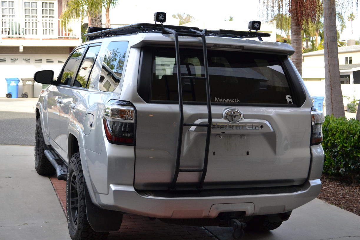

For anyone who is wondering, yes the Gobi ladder clears the Baja Flat Utility Rack (pic below).
Cons: I would have preferred aluminum for weight savings and rust resistance. Unfortunately, the aluminum racks I researched were either too expensive, sat too high, or required drilling 2 inserts for the front feet. After running the wiring, it would be nice to have it pre-run through the tubing like the Gobi Rack. The Gobi is a lot cleaner that way. I also dislike that you almost need a custom mounting bracket for each accessory, which aren't cheap.
First impressions are otherwise very favorable. I gained about 1.5" of clearance over my Yakima rack setup, and it is also much quieter (super quiet unless a cross wind) than the Yakima setup. I bought the tent plates for my RTT and it will make mounting much easier. Rotated 90*, the plates will drop between the crossbars. Get the tent in place, rotate back 90* and tighten up. I imagine this will be easier with my Racor lift than the Yakima's, but we will see since it is tight under the rack (flip side of being low profile).
Looking forward to getting out and putting this rack and camping lights to work!
