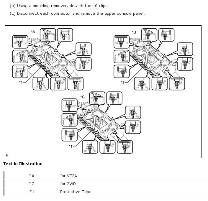

Here is a picture of where all ten clips are, you just need to remove the transfer case knob (if you have one, and then pry around with a trim tool to release the clips.
