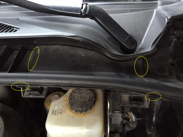

Any chance you could post a pic of the culprit areas you identified and fixed with the the electrical tape?
I can try - anyone know an easy way to do pics without having to upload them somewhere else first...?
And that should have said the small section directly above the brake cylinder, not washer fluid canister.

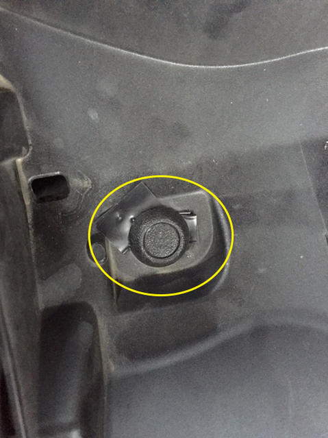

Here are the areas I found making the most noise. If you poke and push around on the cowling you'll find places that creak and tick. It might not sound like much, but have someone else do it while you sit inside and you'll see how much it resonates. The fit and finish of the entire cowling – both the pieces fitting together and how it fits/moves along the windshield are in need of an overhaul.
