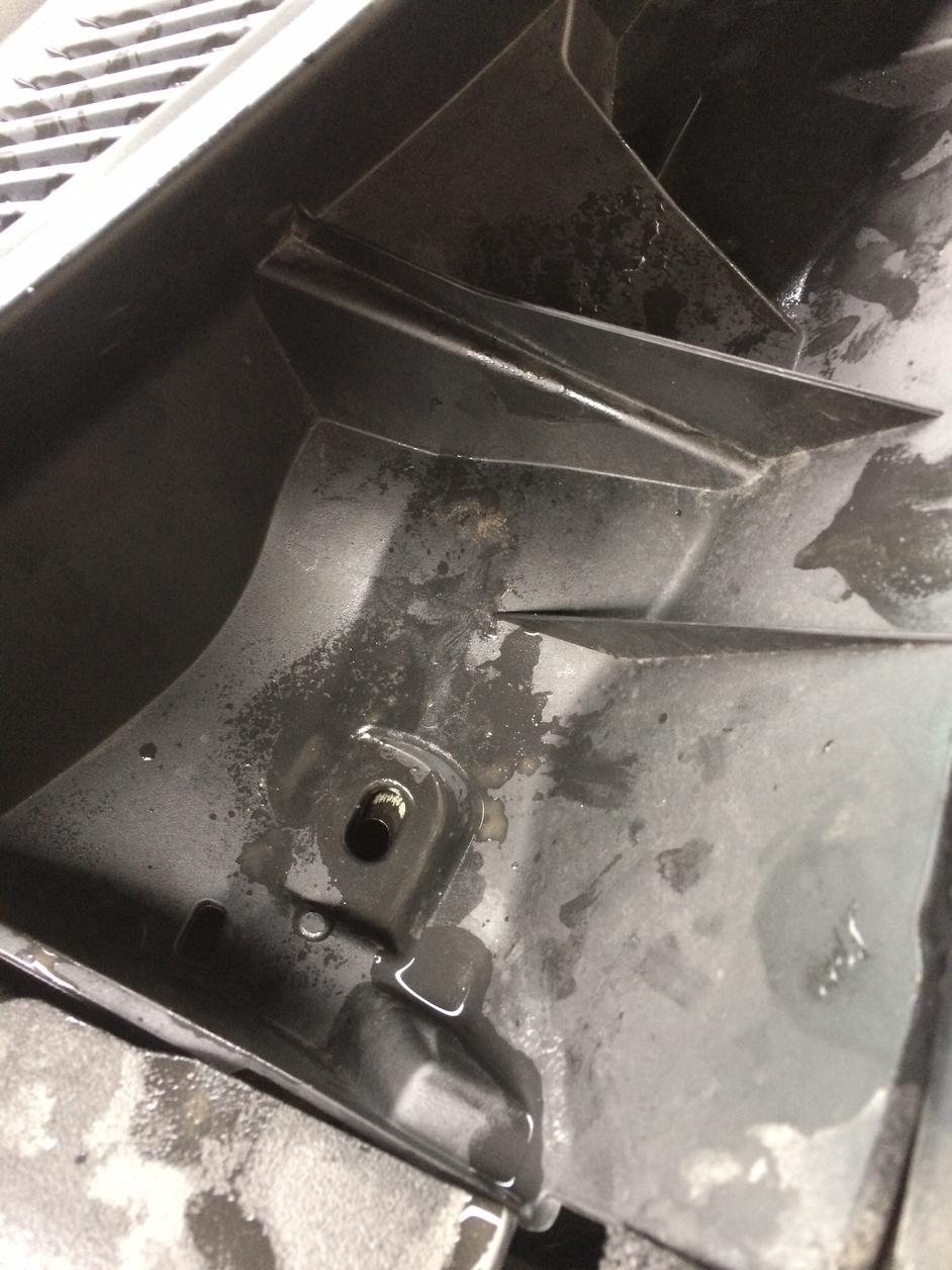

I think I found the source of the creak - the two attachment points for the fairing on the driver and passenger sides.
1) Open the hood and locate the attachment points for the fairing at either side.
2) Push up from the bottom to remove the center pins from the plastic grommets.
3) Remove both the pins and grommets from the attachment holes.
4) Take two pieces of two-sided foam tape and insert between the fairing and the mounting holes.
5) Press the plastic grommets back into the holes.
6) Re-insert the center pins to secure the fairing back in place.
My fairing had been rubbing and moving around, as is evident in the photo, which shows the passenger side mounting hole with the grommet and pin removed.
Hope this helps.

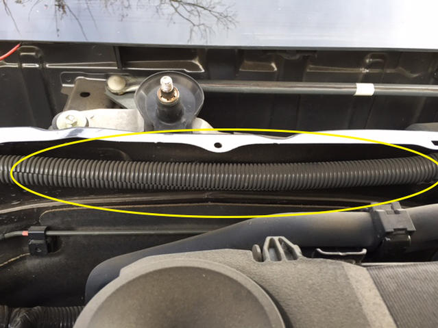

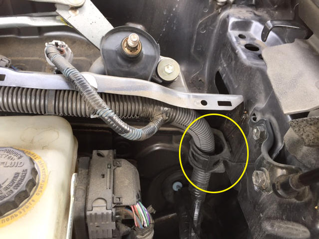

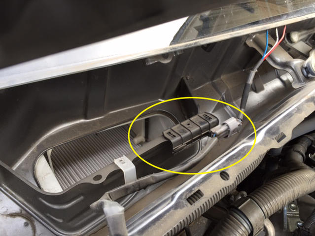

In addition to what you found, I dug a little deeper to try to eradicate the nuisance ticking. I took the cowling completely off and did some poking and prodding on everything that could possibly be loose/make noise.
There's a wire harness that attaches to the opening above the cabin air filter that wiggled and ticked a little too much for my liking. A little silicone under that should suffice.
But I now believe the main culprit is the split plastic wire conduit that runs under the edge of the cowling across the top of the firewall. When you touch it, the edges of the split creak against each other, and the whole thing is just loose enough to tap against the firewall. The round brackets on the inside edge of the fender where it runs down also have plenty of play.
I wrapped the whole thing with electrical tape and put padded foam insulation behind it, then added a dab of silicone on all the loose brackets.
I also put foam insulation along every seam of the cowling when I put it back together.
So far, so good. Even at 24 degrees this morning I'm 95% tick free. The one place I did not put foam is where dubveeT4R mentioned - but that's quick and easy enough.

8) For good measure, wrap foam tape around the plastic harness that cbettin highlighted in this thread where it makes the 90 degree turn on each side of the inner fenders. (There is a circular plastic retaining clip that I lined with foam.)
