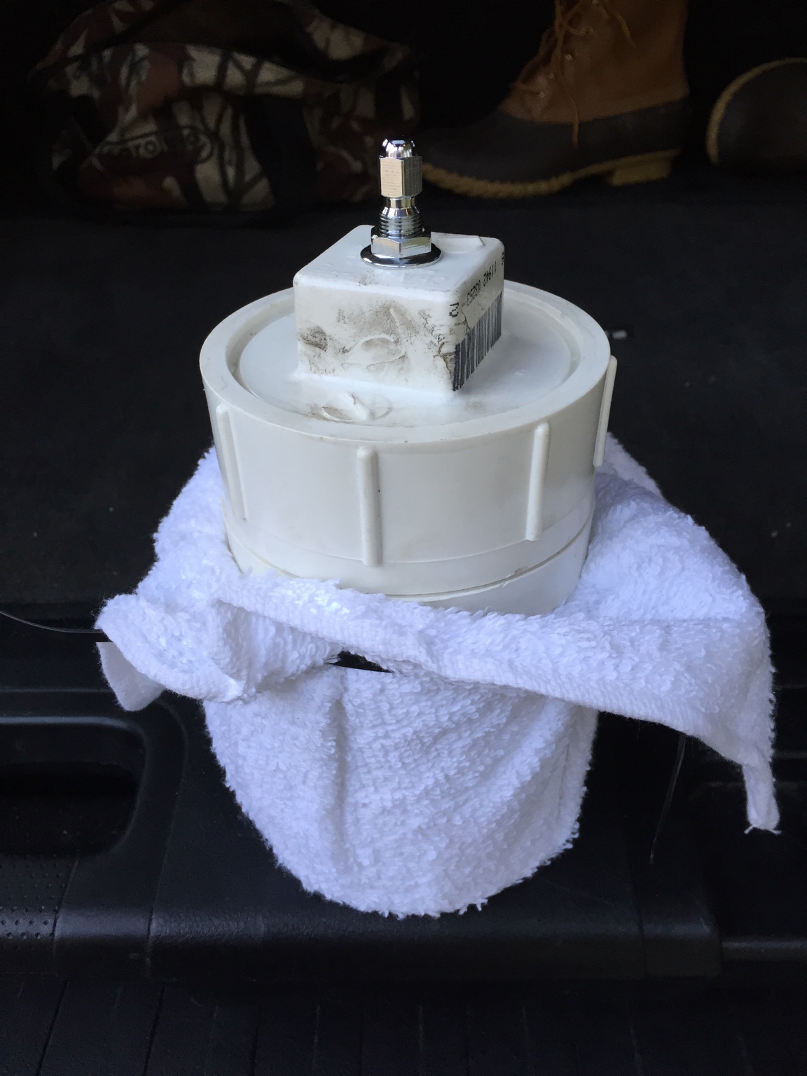

Stick your TPMS tire stem sensors in a pvc vessel like this. Pressurize it to 35-40psi and then toss it in the back of your truck. Problem solved.
Store clerk: why don't you just pay the 60 bucks for new sensors?
MD: Eh... spend 13 bucks and I have the same thing here.
This is pretty good.
