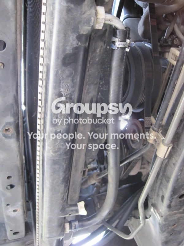

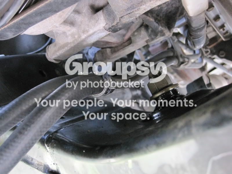

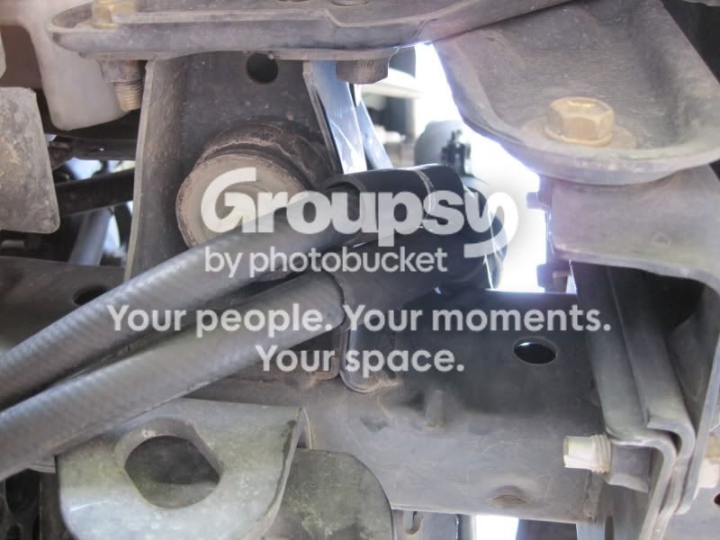

Well I did the install sunday :dancin:
Wanted to thank everyone who provided info & gave me the courage to tackle this myself.
Kball- thanks for all the links and the grill removal link really made that part a breeze!

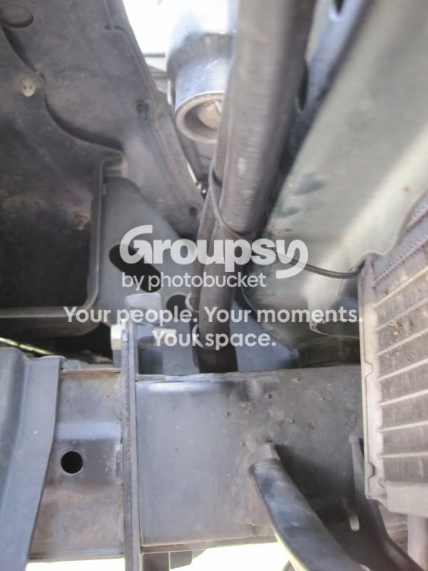

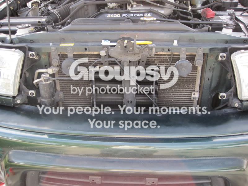

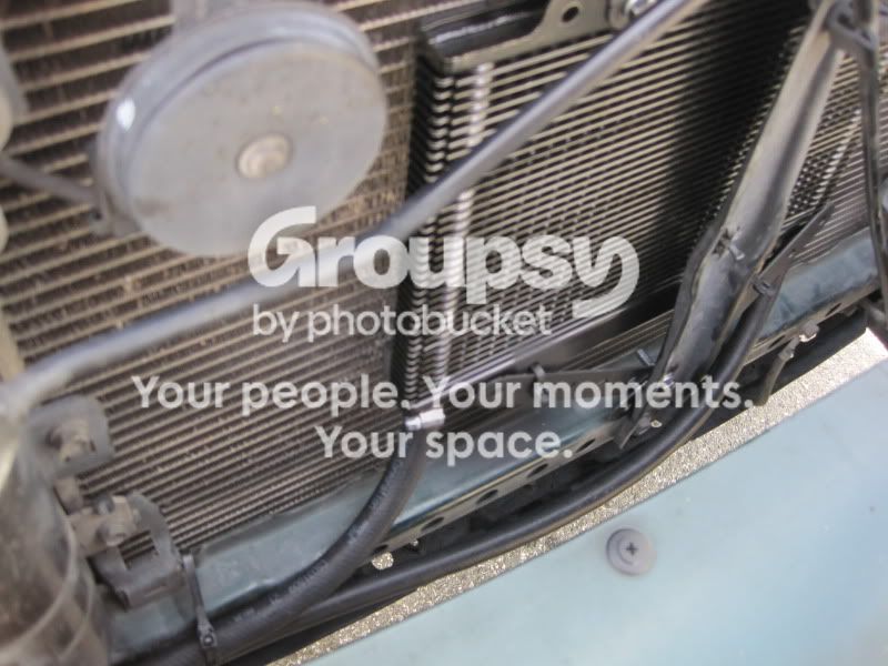

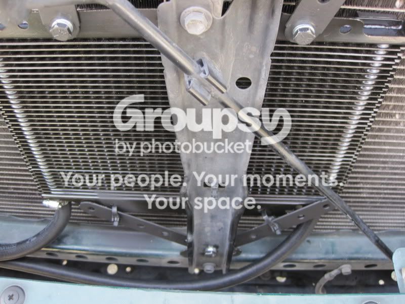

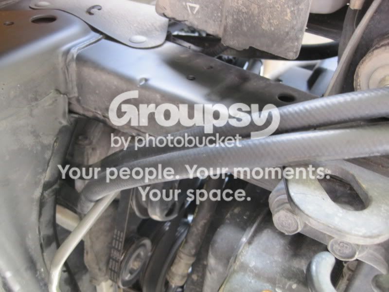

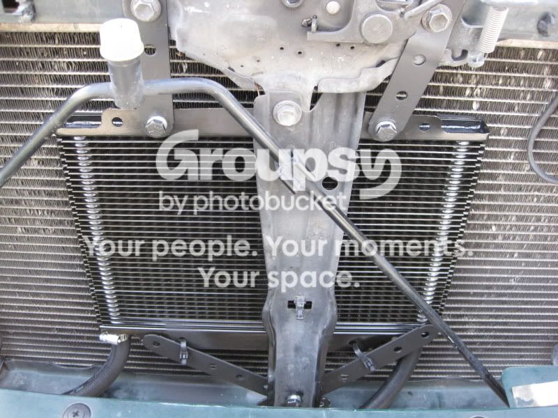

I included a bunch of pics from various angles to try and capture it all. I wanted to run the cooler "stacked" against the AC condenser so this is what I came up with. My only concern may be the bend of the lines heading from the cooler back to the tranny. The radius might be a tad too much for my liking. What do you all think? If anyone has questions, ask away :frog:

looks great, nice job. You're braver than I am reusing those spring clamps.. but if there's no leaks I guess you're good to go!
Very clean installation! I wouldn't worry about the radius on the hoses...looks just fine to me. It's easy enough to take a peek at them from time to time, for peace of mind. I really need to re-do my cooler install. I was in a hurry and didn't mount it very well...plus I didn't have enough new hose so I ended up using some of the old stuff and just patching it together with hose barbs! Totally ghetto.
