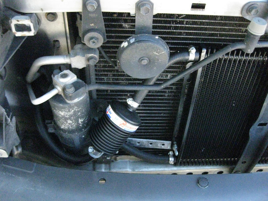

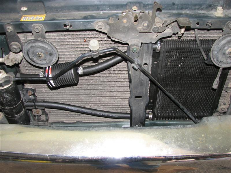

Thanks to all of you DIY folks I have braved up and installed Tru-Cool 4544 unit 20,000btu. I'm running 145F on a highway and highest temp topped at 169F. I have also installed Magnefine 3/8" Inline Magnetic Transmission Filter on a return line. Here are my pictures.

I got the B&M 70268
Amazon.com: B&M 70268 SuperCooler Automatic Transmission Cooler: Automotive
And here's the filter
Amazon.com: Transtar Industries M010CB Automatic Transmission Filter: Automotive
I would suggest also getting around 8 feet or so of 3/8 trans hose. The hose that comes with the kit seemed to be a smaller size. The steel lines on our trucks are 3/8 so it makes it much easier to push the hose on especially at the crossmember where the steel lines to and from the tranny end. I also needed extra clamps, washers and some bolts/nuts.

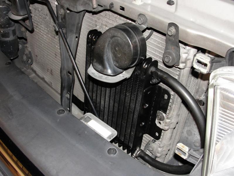

Recently when I did my timing belt etc... I also replaced the radiator so I took the oportunity to mount the cooler up against the condenser and routed the hoses through the a/c line hole. I haven't driven it on any slow uphill curvy mountain roads yet which is where it got the hottest before(cir. 230). So far in daily driving it seems to be about 10 deg cooler, not a big difference.

I returned the b&m70266. It was too big to fit in front of the condenser. The 70264 was a better fit.

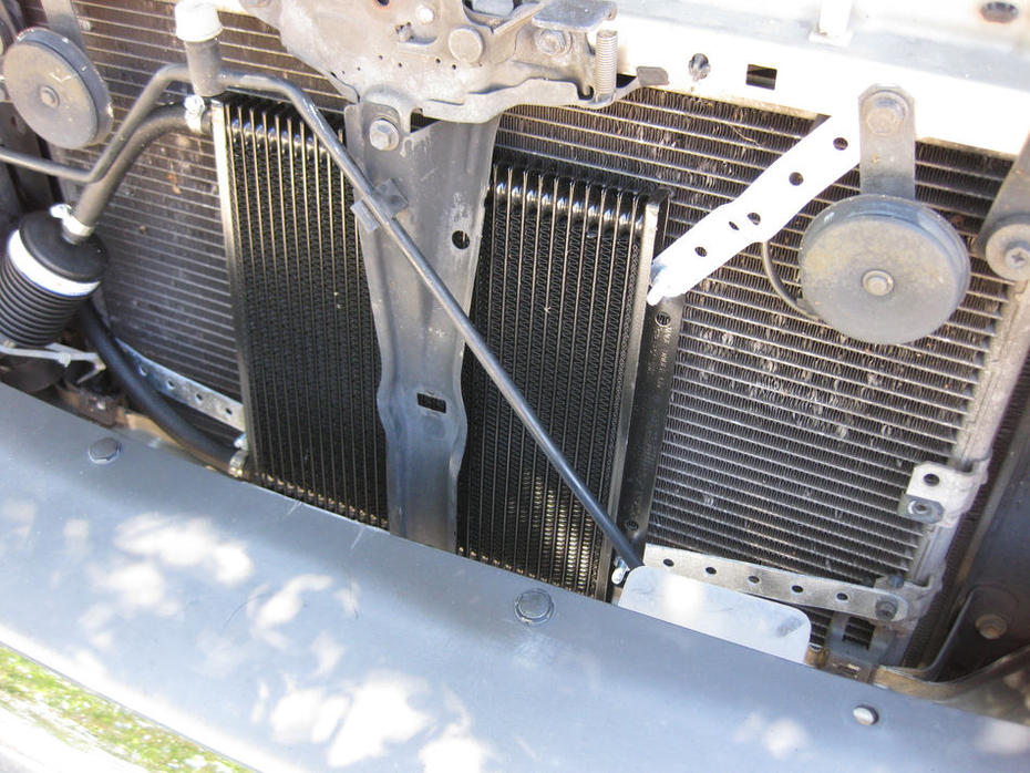

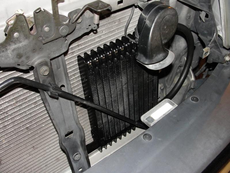

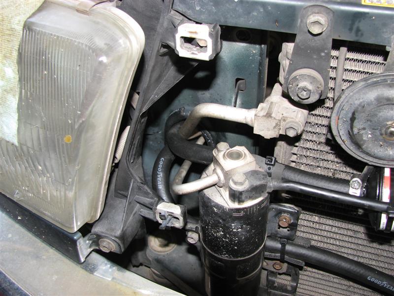

here is my install on my 01. this cooler is from a ford explorer, and with a little time and moding, fits perfectly. as is noticed, it is on the driver side. pass. side is too crowded. hoses are next. :keyboard:

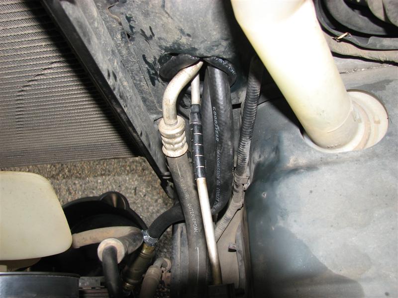

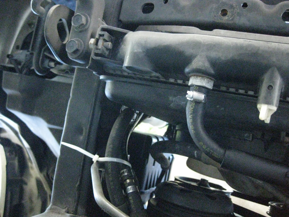

How do I hook a trans cooler up on my 2002 4runner that does NOT have a stock cooler? Where on the trans do I hook up lines?
The only way you don't have the stock cooler is if your radiator has been replaced with one that does not have the built in cooler. I think this is pretty much impossible since lots of people have searched for that type of rad with no luck.
Even if your situation matches my above description you would still have the original cooler lines. They would just have to be connected together some how. Post some pics of your rad and the underside of the front of your truck so we can see what's up.
No 3rd Gen 4runner came with an external tranny cooler, we all have had to add them.
In compared to other vehicles, installing one on a 4runner is easy.
Most members opt for the B&M 70264 or one similar in kind. Just use the search function for options.
Kball, thanks for that info.. I double checked and DO have the lines there. I expected to see them behind the radiator bottom, not underneath it.
