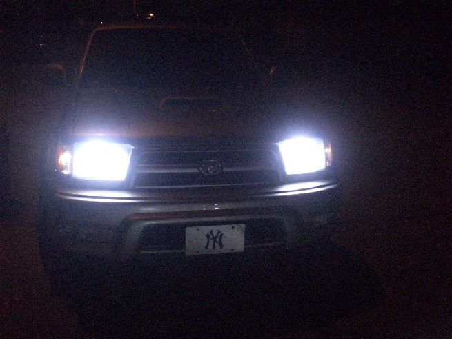

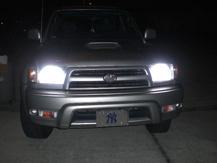

Here are some pics. I just took......I will post some better ones later.

Sloan said:
tampa your HIDs don't seem to be giving off that much glare from your picture, is this true?
Every camera is different, it's hard to tell about the glare from a picture...
yea i guess your right. i want HIDs i'd just be to lazy to do a retro-fit so i guess i'll stay with my regular H4 bulbs for now.
Yeah I know....it was too bright since the street light is right over the truck, I will try to get better ones on a darker spot......but I am very pleased with the change.....its a huge difference.
