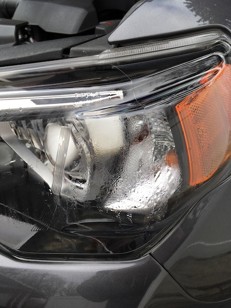

Took out the LED's and evaporated the water in the headlights with a hairdryer and installed the Philips HID's....
They look great in the day light with the Yellow Fogs...
Nice! Curious if the water came back after running the HIDs? I'm planning to have Toyota swap out my headlight again, and debating on trying the HIDs one more time or sticking with halogen... Also curious what you did to seal it up better? I've tried swapping the bulbs between the two different sides but the water keeps coming back to the driver's side.
I made one 45 min minute drive with the new HID's.....the output is fantastic....I did get flashed three times by on coming cars.....I think that the light gets into cars because they are sitting at the 4runner headlight level....
...I did see more moisture in both lights....I was pretty disappointed....there was lots of it.
The rubber grommet for the Philips HID's fit the hole in the dust cover perfectly....a little tight to get in but I would say that it was a perfect fit.....I'm willing to bet the farm on a tight seal on both covers.
so I ordered two new dust covers...I'm going to install the original halogens and the new dust covers and see if the moisture goes away.

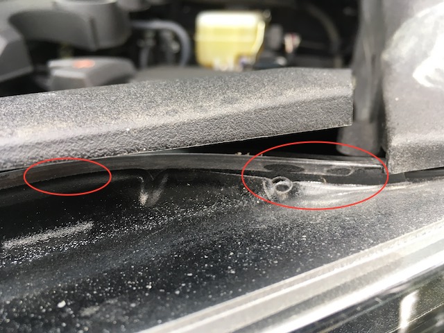

I put up a photo of the seal on the headlights and it looks like maybe some gasket adhesive is missing...

[MENTION=146325]Bucko[/MENTION], my new covers should be in Thursday. I'll let you know if it helps at all making the swap. Sorry to hear youve got that much water in them..
