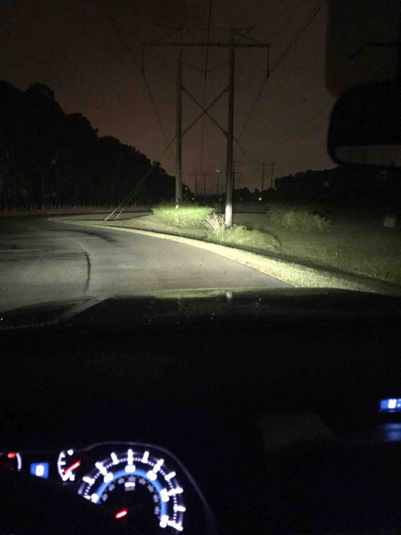

I've been getting flashed 2-3 a trip, thinking my HID's may be a tad high. I've attached a picture, not sure if anyone will be able to tell from it. Disclaimer: I didn't mark my stock bulb beam pattern and compare post install.

There are several threads how to properly align your headlights. It's hard to tell from the picture you posted but if you are getting flashed then you need to measure where your cutoff is.
After I installed mine, I didn't have a problem for weeks until i went fishing one weekend. I drove out friday night and got flashed for the next 2.5 hours. I didn't realize just moving from 265's to 275's made that much of a difference. I actually returned home from my trip early so that I wouldn't blind everyone on the back roads.
You basically need to measure from the ground to the center of your low beam housing. I find a white/lighter color wall is easier to see the cutoff. I think I put my cutoff 3" below the, ground to low beam housing measurement. I haven't been flashed since and I don't light up the interior of honda accords anymore when I am behind them.

I was getting flashed a lot too. I did the measurement and distance thing on flat ground and I still got flashed. The projection has a really good cut off line on the wall. What I did to correct the problem of shinning people was going driving around at night and kept pulling over to adjust the headlights to where it wasn't shining in peoples back windows and that has worked, unless I have a load in the back. Ill be adding stiffer springs to help with weight in the rear when I do the lift in the next month or two. My 4Runner is more weight sensitive in the rear as far as sagging goes then I thought it would be.
