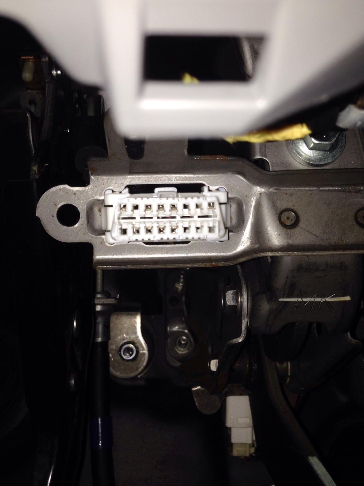

Is this what I am looking for? This is upside down from the illustration, but I assume it is correct?
Yup. I was able to pull it out of the metal bracket because it wasnt screwed in and flip it over to do it the right way the second time around lol

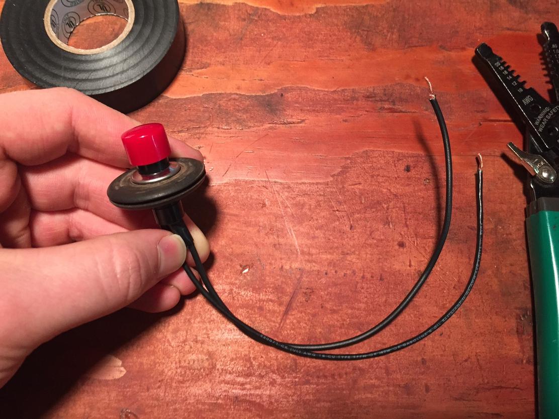

By the way:
In case anyone is wondering how to go about this, I fashioned a "SST" out of a momentary switch from Radio Shack, some 18g general purpose wire from the hardware store, electrical tape, and a loose rubber grommet I had lying around. Total cost to me was about $5.
