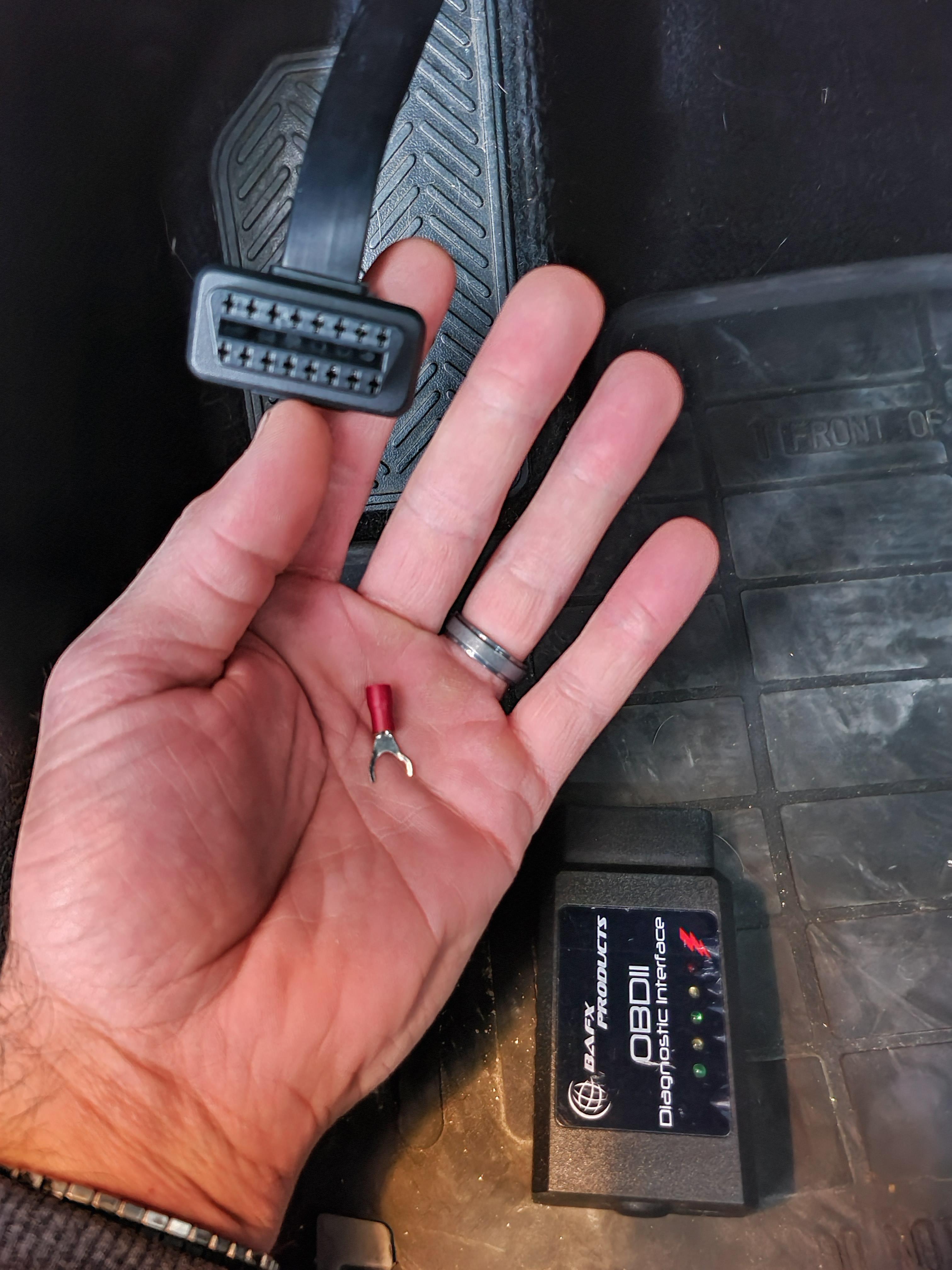

I found this little connector and my ODBII extension to be a Godsend. Made it much easier. Thanks so much OP for sharing this!
