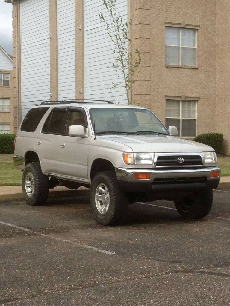

So the search began and after a month or 2 or vigorous searching I found a perfect opportunity on a 1997 SR5 4x4 in the North Mississippi Craigslist! I drove 1.5 hours to meet the guy who I could tell really just didn't care anything about a Yoter ( yeah those people exist [emoji12] ). I immediately knew there were a few tweaks to be done and some clunking to be fixed and basically just routine maintenance. Here was her fist pics to me!
-2.5inch Daystar coil spacer lift included
(Will be upgrading soon)
NEEDED A SERIOUS ALIGNMENT!

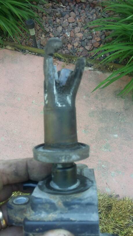

So I began tackling the m ost obvious issues that I noticed. I first noticed the automatic shifter was so sloppy, loose, and every time I hit the gas the shifter would jump back. I ran across a video by youtuber "iworkforbudlight" with a video on how to replace these bushings and made it pretty easy to do. 4 bushings and $9 later she is tighter than a tick!

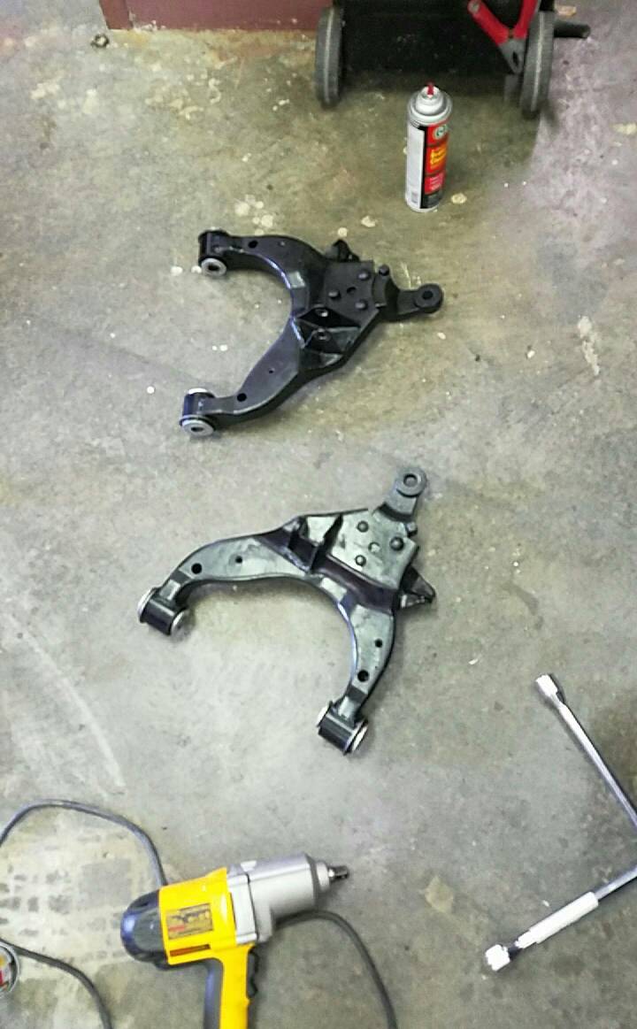

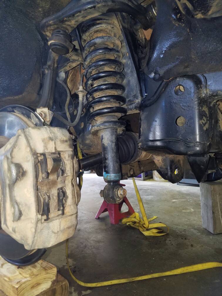

Next issue was a bad clunk from the front end. With the help of a friend turning the wheel back and forth I began diagnosing various parts and narrowed it to LCA bushings that appeared to be wore slap out. I decided to change the whole shebang and picked up some new arms from advanced auto made by Driveworks. They looked good and I had a friend (owns a business) install them. I then began noticing my truck had a hard pull to the right when braking and a positive camber (all of this after an alignment). So I started diagnosing again and after 3 professional opinions later they all said the same thing, aftermarket arms are CRAP, especially the bushings. I called advanced back and they assured I could return the arms for cash back as long as I hadn't damaged them. I immediately ordered new lower control arms for $60 more from Toyotapartsdeal.com . I started removing the aftermarket arms yesterday and it wasn't not all that bad but time consuming. The most annoying part was moving the whole steering rack for TWO bolts!? A little elbow grease and couple of hours later and FINALLY! THEY'RE OUT!

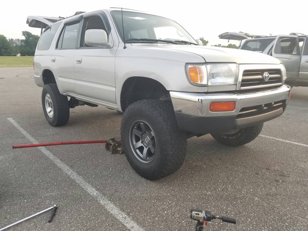

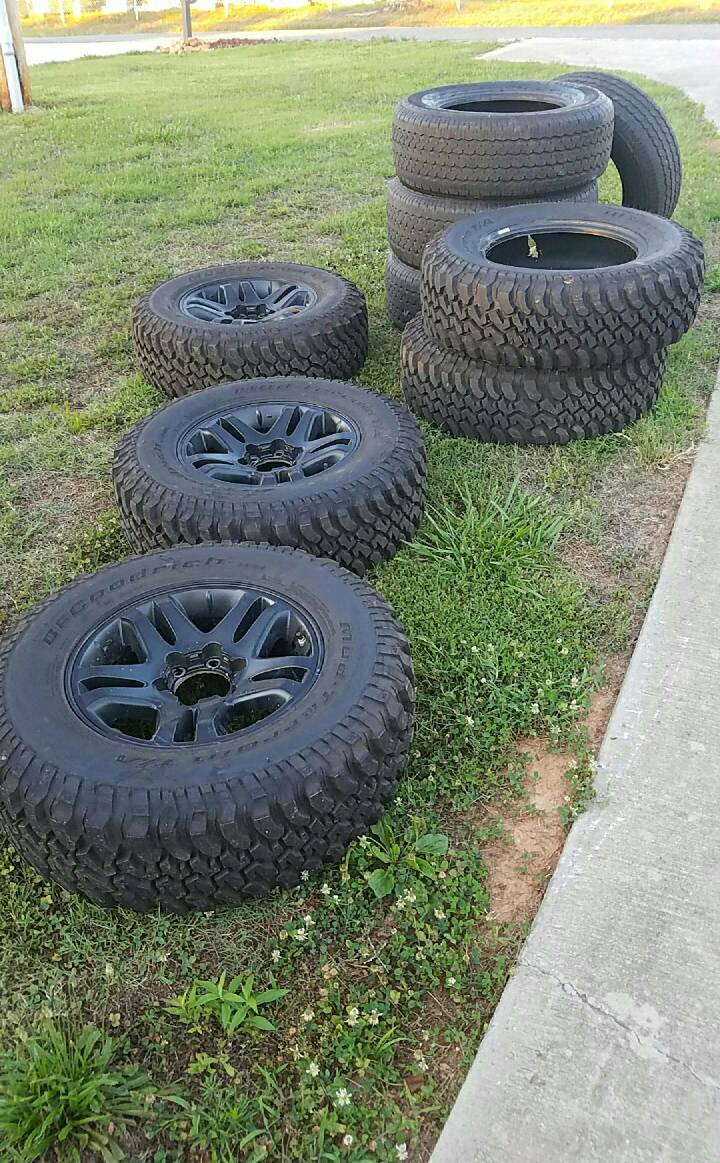

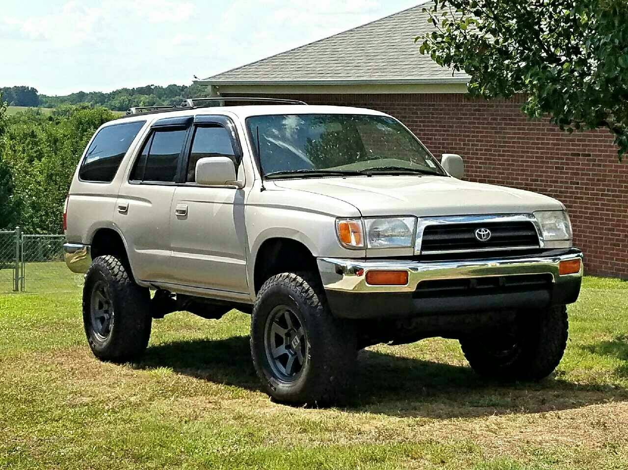

So I began looking through different sources for a set of wheels... I ran across a craigslist add for a set of level 8 wheels with 80% 265/75/r16 General Grabber At2s and little did I know the guy lived like 2 or 3 minutes from me! He was nice enough to meet me one day and let me swap out one of his wheels and tires on mine just so I could see how they looked and if I liked them. So I met the guy and immediately realized he was a pretty swell dude, and actually a part of this forum!
So I bought them from him along with another set of 5 split spoke style tundra factory wheels with brand new 255/75/r17 bfg KMs on them (true 32").
I decided to put the level 8 / grabber combo on first and WOW ! They ride smoother and quite ride than I imagined they would and not to mention, they look great! Thanks [MENTION=118797]jpeaslee[/MENTION] !!
Now I have been pondering for a few weeks and reading various ideas of a better lift setup besides the coil spacer 2.5" lift, but I want to maintain this height. I've been reading various post and forum threads on all the different setups. And I am going to go with the Tundra Bilstein 5100s front and rear and highly considering the Tundra TRD coils up front due to all of the positive reviews. I also am planning to buy [MENTION=118797]jpeaslee[/MENTION] OME 906 rear coils to put on to my ride and hopefully fix the sagging, bouncy springs and fix the notorious "driver's side lean"
I have also read many reviews where people also like the 5100s paired with the OME front 881 coils. So I'm still reading pretty heavy but pretty set on the tundra coils for now. Hoping I can get lucky and find some noce used ones! Haha

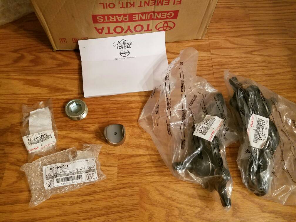

Ahhhhh... here come the goodies for the next few day!! Today's special delivery consist of
-Lower LBJs
(43330-39585 and 43340-39465)
-New style Rack guide
(45504-35031)
-New style guide cap
(45524-37010)
Thanks Camelback Toyota!
