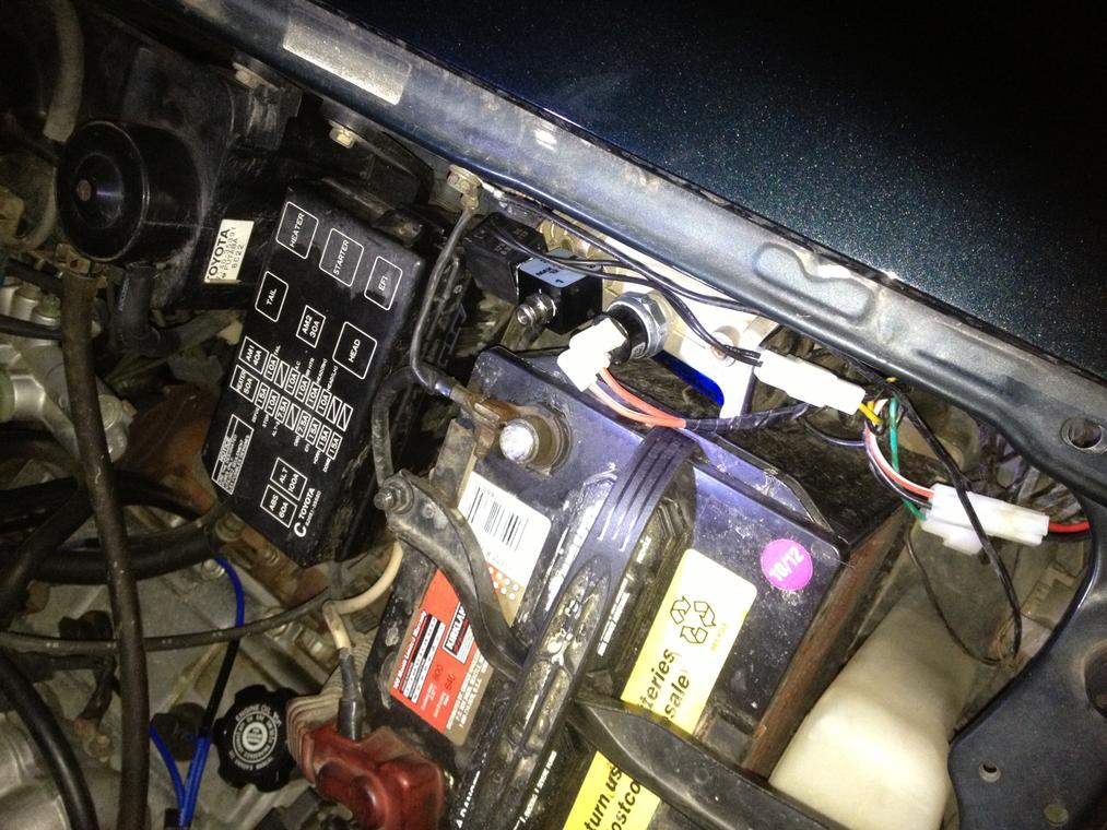

Let's start off with what will be powering this air locker.
Air Compressor: CKSA12
-Already have a compressor for tires
-Low price
Location
-Right of the battery
-Fits very snuggly
-Close to power and firewall

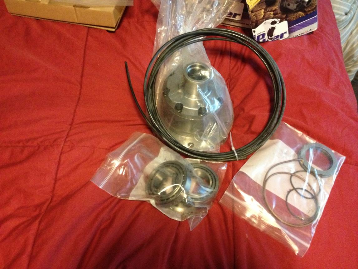

The Locker
Yukon Grizzly Zip Locker
-YZLTV6-30
-Affordable (Roughly half of an ARB)
-Assembled in the USA
-1 year warranty
