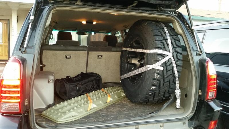

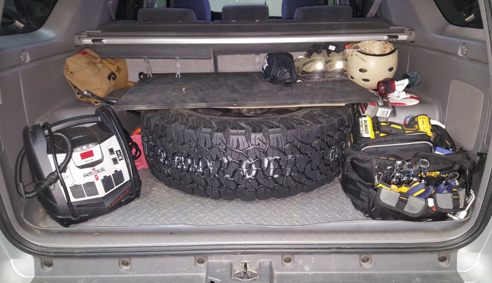

So among other thing I need to address now that I went to 35's is the fact that I still have no place to put the spare (maybe I should start a thread on "will 35's fit the factory spare location? :P )
I keep meaning to get/build a full metal rear bumper and it just keeps getting put on the back burner, at the moment with the move coming up and other things I just don't know when I'll get around to it. In the mean time I have a giant tire taking up room in the cargo area as you can see.
My friend and I mused about mounting it straight up (it does actually fit standing up, managed to squeeze all 5 in the back to take to work! :D ) like older Cherokees did. The only thing is that I can't seem to figure out how to secure it. I'd like not to cut/deform the WeatherTech to reach the anchor points, but it seems I may have to do that at this rate since I can't seem to find anything else to secure it to.
Suggestions/ideas guys?

I bought some ratchet straps today and secured the spare on the passenger side, used two of them (one over the top was enough that it didn't really move, but I wanted one horizontally to ensure it wouldn't slip out) and it came out pretty well. I decided not to cut the Weathertechs and just let them sorta curl up a bit at the moment. A shame the MaxTrax are too tall to mount vertically or front to back in the cargo area. :(

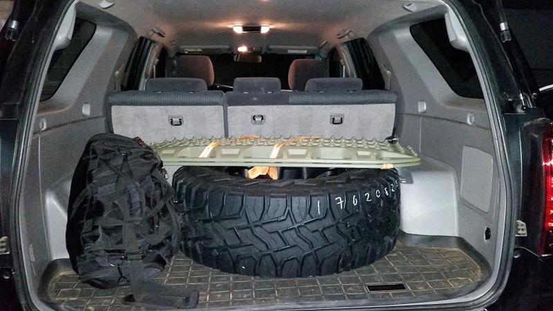

I know the feeling of dealing with the spare.
I hate that it sits in my rear cargo area, so I put a piece of wood on top of it

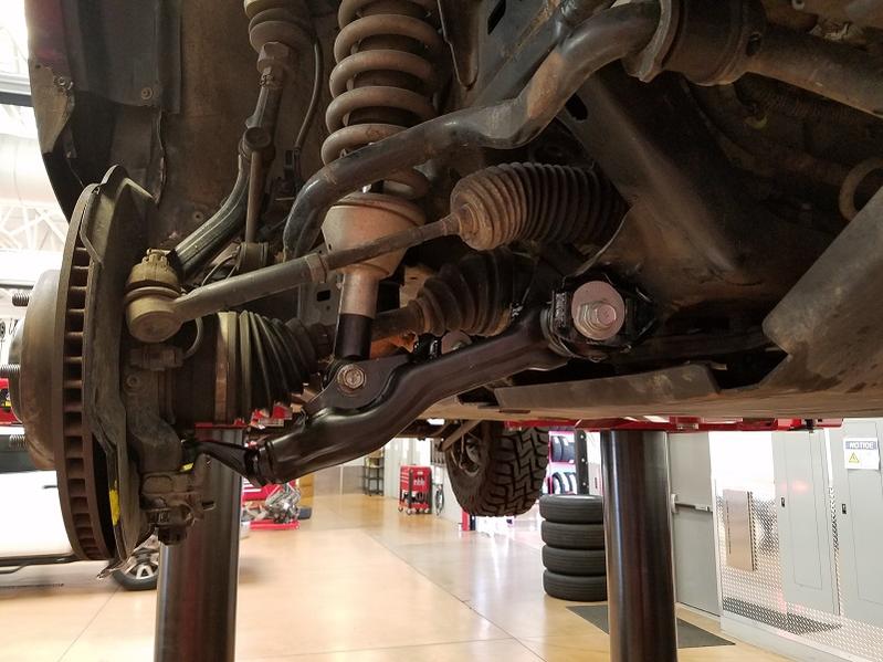

Finally got around to installing my rebuilt LCAs!
I also decided to go with Wheeler's Offroad BumpStops with a 3/8" spacer to limit up travel slightly since the 35's are mashing into the fenders some on full compression. Had the LCAs and all the parts ready to go for a while, I just needed a weekend to throw them in.

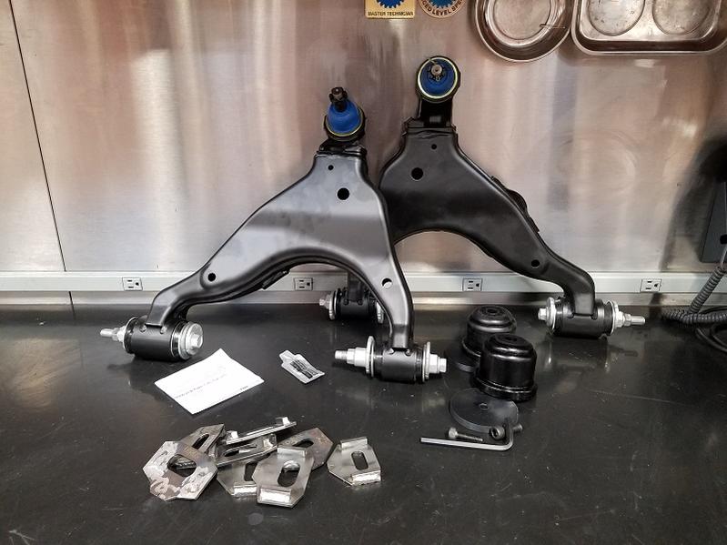

Here's all the goodies! The LCAs were from a Tacoma a coworker did a frame on and the bushings are poly-urethanes from WhiteLine Racing. I went with a Raysbestos LBJ per a couple member's recommendations (it appears to be similar to the AC Delco offering as well). Had a local shop powdercoat them satin black for me also. I bought new Total Chaos Cam Tabs to install as well because my tabs were on their last legs.

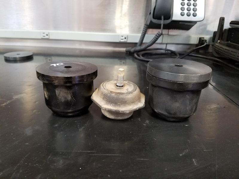

Here's a comparison of the factory bumpstop (extremely hard and barely has any give after 10yrs) and the Wheeler's Offroad squish blocks made of Poly-Urethane Foam, I also included a one with the spacer on top so you get a good comparison.

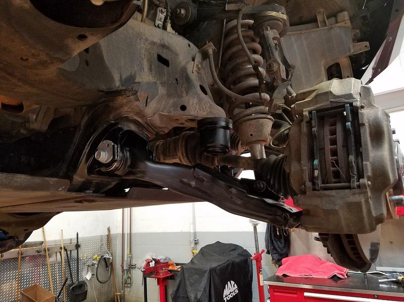

After drilling out the spot welds, prepping the metal, having my coworker weld them in (I'm out of practice so my welds would look horrible), painting, and finally reassembling everything; it all looks good!
From the front:
From the Rear:
Went with all new hardware (my old cambolts and adjusters were actually fine, I decided to keep them as spares since they weren't even corroded and slid out fine) and applied anti-seize to all the cam bolt and adjusters as a precaution. The whole thing took maybe 5 hours or so with alignment? All in all I am very happy I went with this, I was having a steering wheel shake around 50~65mph that was very odd and inconsistent; I had suspected the LCA bushings to be the cause for the longest time and when I pulled the arms out you could easily see they were barely hanging on. Now with the new LCAs she drives perfect and the turn-in response feels better!

Switching to the poly bushing (LCA), definitely helped a lot with my hard brake shakes, steering is a lot tighter also.
Only problem I have been having now with them is getting the squeaks in the bushings in turns going over curbs ect. Need to find/do a zerk lube system to them.
