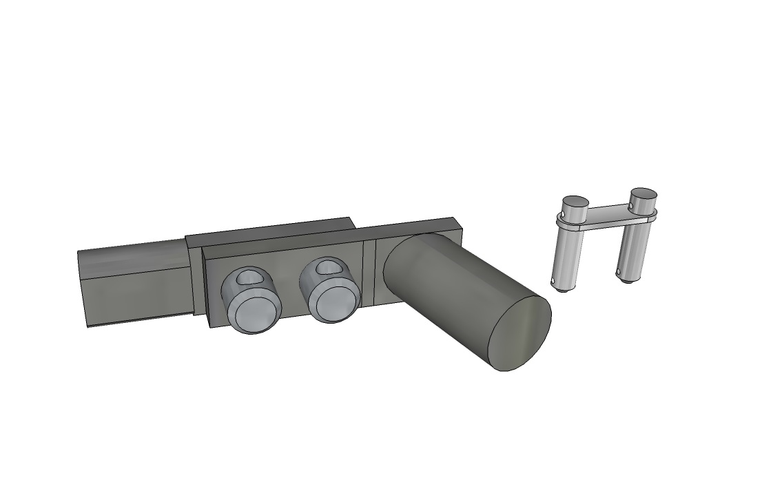

Now for the mount. Readily accessible but not readily visible. Gonna have to get creative.
A picture of things to come, if all works out... :zoom:
Internet cookie for anyone that can guess what it is! :D
