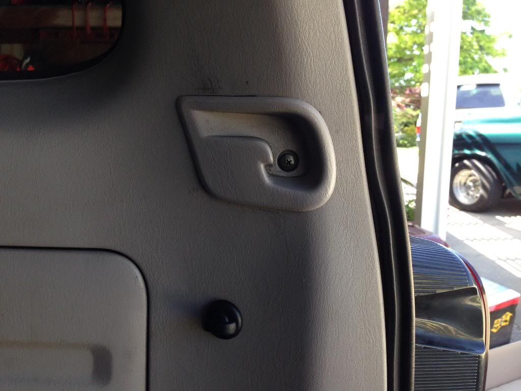

Next remove the rear cargo cover catch sleeves(no idea what they are really called). Remove the single philips screw and slide the plate out.
Drivers and passenger catch sleeves
Removed
