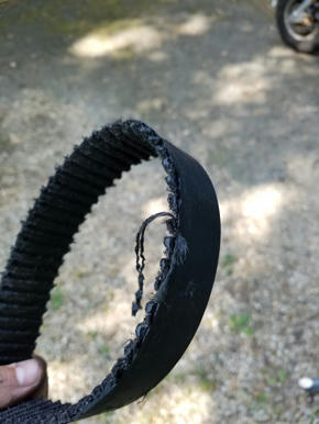

Timing belt exploded,
Only 79k after replacement (200k total) on the belt but there was a small leak of coolant that I ignored for years that finally caught up. It made the belt explode and the timing jumped tremendously (almost 180 degrees on the driver side cams).

Finally dived in and took apart the covers and looked at the disaster that awaits. I thought the engine was gone. Looks like, from the investigation process, and constant starts and revs after replacing parts, it made the timing jump worse and worse. I read this was an INTERFERENCE motor. YIKES.
I said who cares and ordered a timing rebuild kit with new AISIN water pump, etc. Cleaned the engine well because there were belt shavings everywhere!

The belt is pretty messed up but still intact, had it come apart your engine would be toast.

it absolutely does not prove it wrong. If the belt was still intact the valves weren't able to stay open and be damaged by the piston. The belt was definitely messed up but please go try and cut the belt completely and tell me your engine is fine.
the motor didnt shut down after the timing jumped, i ran it hard thinking it was a spark plug issue. LOL

All the belts replaced was with the oem Mitsubishi belt. 2nd and 3rd change
Aisin water pumps come with a metal gasket with a thin Brown silicon edge, please don't trust this and use gray silicone.
The timing belt that exploded was wet and brittle. Felt like rubber drenched in oil.
This is after 4 to 5 years of knowing the leak.

I'm glad your engine is ok. This is good tech info but I have some questions since it's hard to go out on a limb and say there is no interference when so much data suggests that it is an interfering eng. You had to physically rotate the drivers cam to line everything up? A true 180*? Maybe I'm blind but I see belt teeth throughout the whole belt. But something made it run like poop, so it jumped teeth? If it jumped teeth, this would immediately retard valve timing. This increases the piston to valve clearance for the intake valves and decreases the clearance for the exaust. Intake valves are always larger than exhaust valves so they are at the most risk. Say you jumped 180 on the driver cam, this will retard the cam, and cause all your symptoms, but since the cam is retarded, there is more intake valve clearance. This only works out in your favor if the cam didn't spin 360 or more. And you may have kissed valve to piston anyways. Hot steel valves vs hot aluminum can put a good mark in the piston but still leave the valves and piston relatively ok, it all depends on how much interference there is. You can check by scoping through the spark plug hole. Some people get lucky when a belt snaps in half because all the valves stop and aren't at max lift. Let's fully diagnose this before we call this 2uz-fe interference engine a myth.
Oh man, this does make sense. But to be honest the passenger side was off by 30 degrees too when lining up the crank from what i recall and you can see the pic, the driver side is more like 270 degrees. Either way, with me troubleshooting for days by running it like a dog before finding out it was the timing kind of proves its barely interfering
