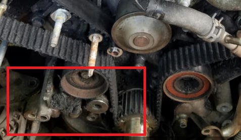

04 4runner V8 Sport 2uz-fe timing belt failure, aftermath and the repair
All the belts replaced was with the oem Mitsubishi belt. 2nd and 3rd change
Aisin water pumps come with a metal gasket with a thin Brown silicon edge, please don't trust this and use gray silicone.
The timing belt that exploded was wet and brittle. Felt like rubber drenched in oil.
This is after 4 to 5 years of knowing the leak.
No matter what this engine is amazing.

4 years ago I saw a drip under the engine when i was changing the oil, then saw it coming from the covers behind the fan. then the second year I started topping off the coolant more frequently. 3rd, it over heated once...and now it started to leak from where the thermostat housing mounts to the pump. I was dumb and used Orange sealant. I heard Orange isnt as good as gray. by the 4th year, it was always a little wet around the steering rack and area. I knew I had to change it soon. then BAM...this happened. The belt was so brittle when I held it in my hands, Rubber powder build up was everywhere inside the covers, strands of belt everywhere as well.
This pic shows the buildup of Rubber
