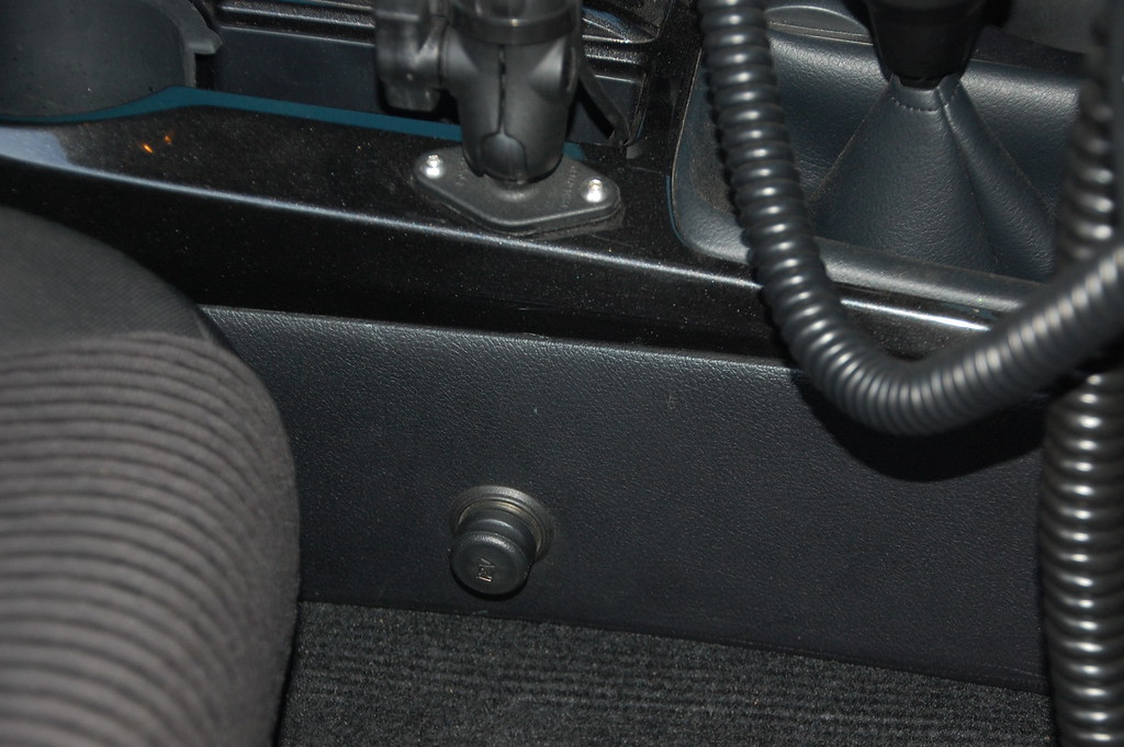

As a possible option, have you considered a dedicated 12VDC hot outlet? I have this guy installed - wired to acc via a fuse tap, but I'm going to swap it over to battery in that 4th fuse slot so it's always hot. I'm always reluctant to add to or try to bypass factory wiring since so many things can be controlled by one seemingly unrelated power connection.

Maybe just access the rear of the stock outlet, disconnect the 12vdc acc wire, and replace it with a power wire to the aforementioned batt powered open fuse slot? You wouldn't even have to run a ground. No issues with factory wiring.
